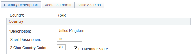

Access the Country Description page (select Set Up Common Objects, then select Install, then select Country Table, then select Country Description).
Image: Country Description page
This example illustrates the fields and controls on the Country Description page. You can find definitions for the fields and controls later on this page.
Field or Control
Definition
2-Char Country Code (two-character country code)
Enter the code if applicable.
EU Member State (European Union member state)
Select if this is an EU member state.

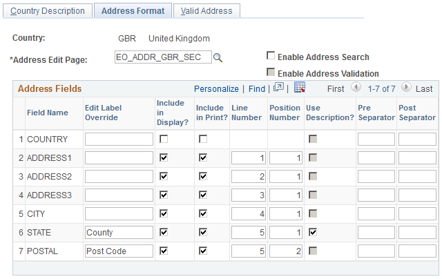

Access the Address Format page (select Set Up Common Objects, then select Install, then select Country Table, then select Address Format).
Image: Address Format page
This example illustrates the fields and controls on the Address Format page. You can find definitions for the fields and controls later on this page.
Address Format page
Field or Control
Definition
Address Edit Page
Select an address page from the list of available options. The system displays the list of fields on that page in the Address Fields group box.
Enable Address Search
Select to enable users to search for a valid value. Selecting this check box enables the Used in Search column on this page and also enables the Valid Address page.
Enable Address Validation
This check box is available only when Enable Address Search is selected.
Select to enable the system to validate address entries for state or province and city as shown on the Valid Address page.
Address Fields
Field or Control
Definition
Field Name
The Field Name column displays the address fields available in the Campus Solutions.
Edit Label Override
Enter a different label to override the default field label, if required for this country.
Include in Search
Available only when you select the Enable Address Search check box. Select the fields on which you want users to be able to search. The fields that you select appear on the Valid Address page as columns.
Include in Display
Select to have the system include this field when an address appears in read-only mode. Deselect this check box for specific fields if you want to display addresses in a format that is different from how addresses appear during data entry.
Include in Print
Select to have the system print this field whenever an address in this country is printed.
Line Number
Enter the line on the page on which this field should appear.
Position Number
Indicate the position of this field in the selected line.
Use Description
Select to have the system display a full description for this field. This is enabled only for State.
Pre Separator and Post Separator
Enter separator characters for the address elements if applicable (for example, an em dash).
