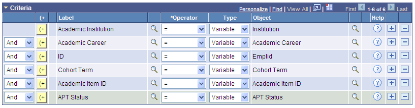

  • Add Criteria to a Rule.

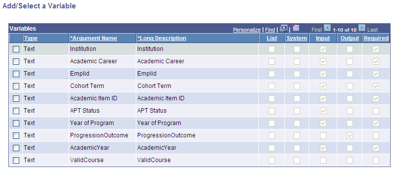

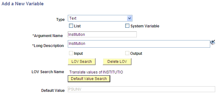

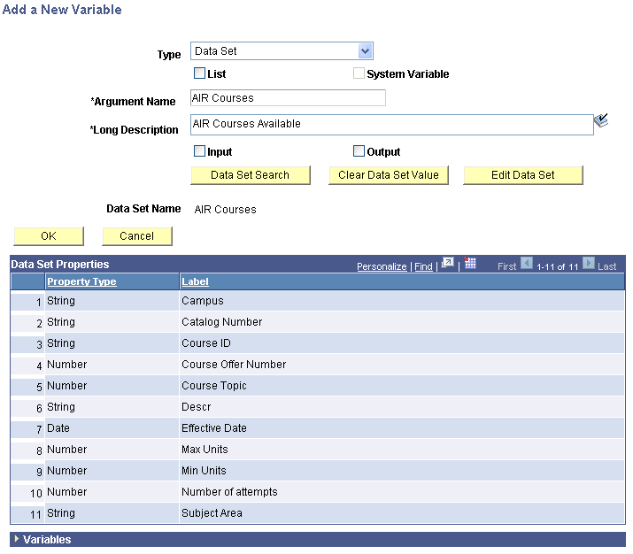

Add a New Variable
SCC_RULE_VARD_SEC
Click the Add a New Variable button on the Define Rule page.
Add Variables to a Rule.

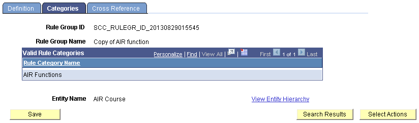

Rule Groups Categories
SCC_RULEGR_CAT
select Set up SACR, then select System Administration, then select Rules Engine, then select Define Rule Groups, select the Search for a Rule Group radio button and click Next. Enter Search criteria, click the Search button, select a Rule Group from the results, and click the Categories tab.
select Set up SACR, then select System Administration, then select Rules Engine, then select Define Rule Groups, select the Add a New Rule Group radio button, click Next and click the Categories tab.
select Set up SACR, then select System Administration, then select Rules Engine, then select Define Rule Groups, select the Create a Rule Group from Group radio button and click Next. Enter Search criteria, click the Search button, select a Rule Group from results, and click the Categories tab.
Define valid Rule Categories for a Rule Group.

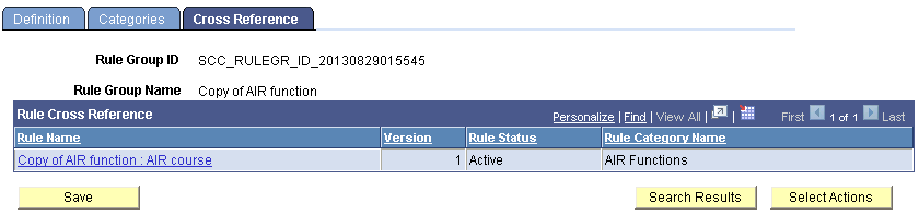

Rule Groups Cross Reference
SCC_RULEGR_MGR
select Set Up SACR, then select System Administration, then select Rules Engine, then select Define Rule Groups, select the Search for a Rule Group radio button and click Next. Enter Search criteria, click the Search button, select a Rule Group from results, click the Cross Reference tab.
select Set Up SACR, then select System Administration, then select Rules Engine, then select Define Rule Groups, select the Add a New Rule Group radio button, click Next, and click the Cross Reference tab.
select Set Up SACR, then select System Administration, then select Rules Engine, then select Define Rule Groups, select the Create a Rule Group from Rule radio button and click Next. Enter Search criteria, click Search button, select a Rule from results, and click the Cross Reference tab.
select Set Up SACR, then select System Administration, then select Rules Engine, then select Define Rule Groups, select the Create a Rule Group from Group radio button and click Next. Enter Search criteria, click Search button, select a Rule Group from results, click the Cross Reference tab.
View Rules associated with the Rule Group.

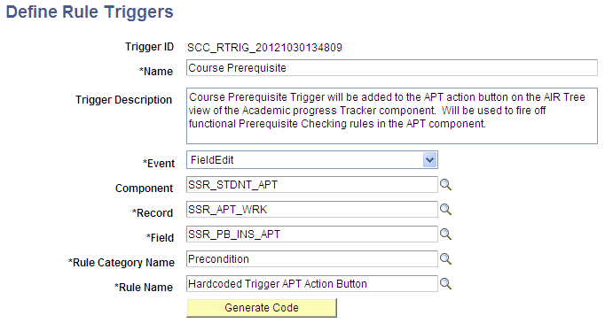

Define Rule Triggers
SCC_RULE_TRIG
select Set Up SACR, then select System Administration, then select Rules Engine, then select Setup, then select Define Rule Triggers
Define Rule Triggers to determine from where in the system a Rule can be called.

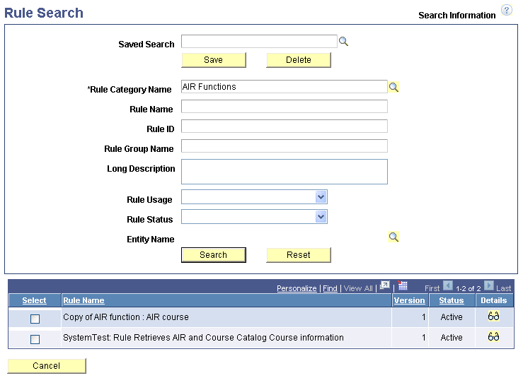

Rules Engine Search is the starting point for the following activities:
  • Searching for Rules.
  • Adding new Rules.
  • Creating a new Rule from an existing Rule.
  • Creating a new Rule for a Rule Group.
Access the Rules Engine Search page (select Set up SACR, then select System Administration, then select Rules Engine, then select Rules Engine Manager).
Image: Rules Engine Manager Search page
This example illustrates the fields and controls on the Rules Engine Manager Search page. You can find definitions for the fields and controls later on this page.
Searching for a Rule
In the Rule Engine Manager search page, select Search for a Rule and click on the Next button to open Rules Search options page.
Image: Rule Search Options page
This example illustrates the fields and controls on the Rule Search Options page. You can find definitions for the fields and controls later on this page.
Rule Category Name is a required field. If a unique Rule ID is known and the user has access to the Rule Category, the Rule Category is automatically selected and not required.
The following fields can be used with wildcard search option “%” and are case-sensitive:
  • Rule Name
  • Rule Group Name
  • Long Description
Click the Search button and any results are displayed in a grid below the Search fields. If there are no results, a message appears.
Click the Reset button to clear the Search fields.
Click the Cancel button to return to the Rules Engine Manager search page.
To save the Search, enter a name in the Saved Search field and click the Save button.
To delete a Saved Search, enter the name in the Saved Search field and click the Delete button.
In the Search results grid, select the Select check box or click on the Details icon to select a Rule. Clicking the Details icon also displays a panel below the Search results grid displaying the Long Description, Rule Category, Rule Group Name, Rule Usage, and Entity Name of the Rule.
Click the Next button to open the selected Rule in the Rules Engine Manager and edit your Rule.
Click the Previous button to return to the Rules Engine Manager search page.

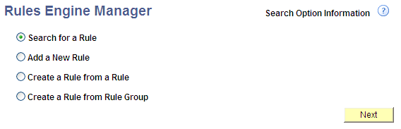

Adding a New Rule
In the Rules Engine Manager search page, select Add a new Rule and click on the Next button to open the Rules Engine Manager page where you can define the parameters of your new Rule.
For more information, see Constructing Rules.

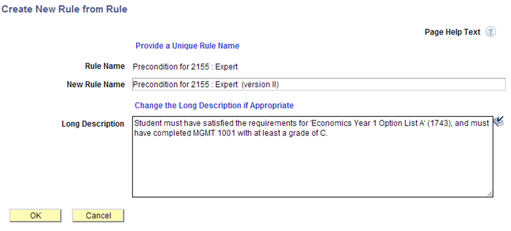

Creating a New Rule from an Existing Rule
In the Rules Engine Manager search page, select Create a Rule from a Rule and click on the Next button to open the Rule Search page.
When you have found the Rule you want to clone, click Next to open the Create New Rule from Rule page and provide a New Rule Name and/or Long Description.
Image: Create New Rule From Rule page
This illustrates the Create New Rule From Rule page.
A new Rule is created with Rule Status In Progress , and it inherits all the Variables, Criteria, and evaluative statements from the Rule you selected to clone
Field or Control
Definition
New Rule Name
Enter a name for the new Rule. The New Rule Name must be different from the original Rule Name.
Long Description
The Long Description of the original Rule populates this field and can be edited for the new Rule.

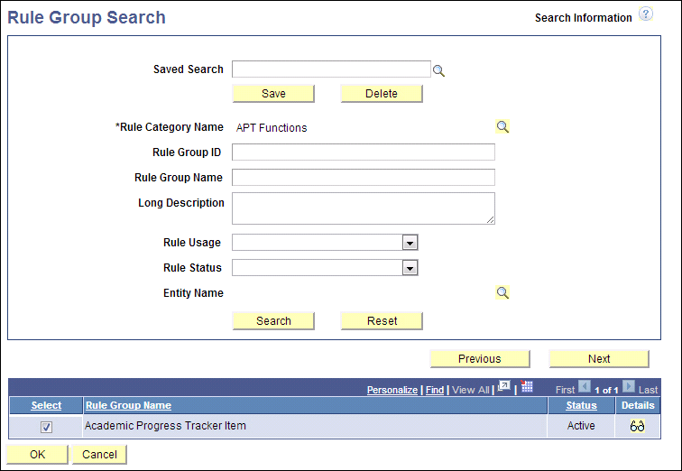

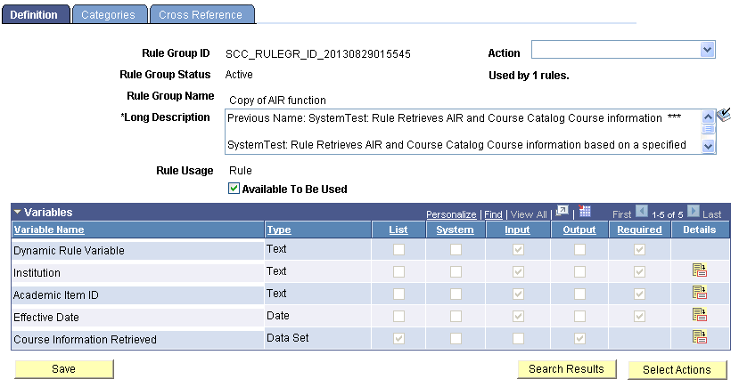

Rule Groups Search is similar to Rules Engine Search and is the starting point for the following activities:
  • Searching for a Rule Group.
  • Adding a new Rule Group.
  • Creating a new Rule Group from an existing Rule.
  • Creating a new Rule Group from an existing Rule Group.
Access the Define Rule Groups Search page (select Set Up SACR, then select System Administration, then select Rules Engine, then select Define Rule Groups).
In the Rule Group search page, select Search for a Rule Group and click on the Next button to open Rule Group Search options page.
Image: Rule Group Search Options page
This example illustrates the fields and controls on the Rule Group Search Options page. You can find definitions for the fields and controls later on this page.
Rule Category Name is a required field. If a unique Rule Group ID is known and the user has access to the Rule Category, the Rule Category is automatically selected and not required.
  • Rule Category Name
  • Rule Name
  • Rule Group Name
  • Long Description
Click the Cancel button to return to the Define Rule Groups search page.
In the Search results grid, select the Select check box or click on the Details icon to select a Rule. Clicking the Details icon also displays a panel below the Search results grid displaying the Long Description, Rule Category Name, Entity Name, Rule Usage, and all Input and Output variables as they are key features of the Rule Group Template.
Click the Next button to open the selected Rule Group in the Rule Groups Manager and edit your Rule Group.
Click the Previous button to return to the Define Rule Groups search page.

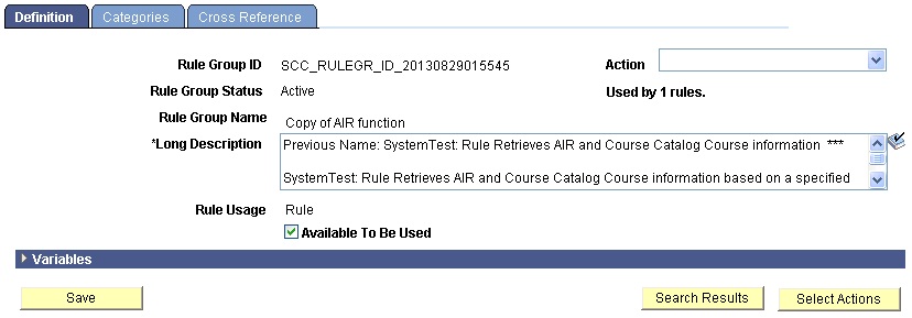

Adding a New Rule Group
In the Define Rule Groups page, select Add a New Rule Group and click on the Next button to open the Rules Groups Definition page where you can define the parameters of your new Rule Group.
For more information, see Defining Rule Groups.
Creating a New Rule Group from an Existing Rule
In the Define Rule Groups search page, select Create a Rule Group from Rule and click on the Next button to open the Rule Search options page.
When you have found the Rule you want to base your new Rule Group on, click Next to open the Rule Groups Manager component. A new Rule Group is created with Rule Group Status In Progress, and it has inherited all the Variables, Entity Name, Skill Level and Rule Usage from the Rule you selected.
Note: The Rule Name is also copied. As a first step, you should rename the Rule Group Name to avoid confusion.
Creating a New Rule Group from an Existing Rule Group
In the Define Rule Groups search page, select Create a Rule Group from Group and click on the Next button to open the Rule Group Search page, which is similar to the Rule Search page.
When you have found the Rule Group that you want to clone for a new Rule Group, click Next to open the Rule Group Manager component. A new Rule Group is created with Rule Group Status In Progress, and it has inherited the Input and Output Variables, Entity Profile, Rule Category Name, Rule Usage, Entity Name, and Skill Level of the Rule Group chosen to clone.
Note: The Rule Group Name is also copied from the selected Rule Group. As a first step you should rename this Rule as to avoid confusion.
For more information on how to create and edit Rules, see Defining Rule Groups.

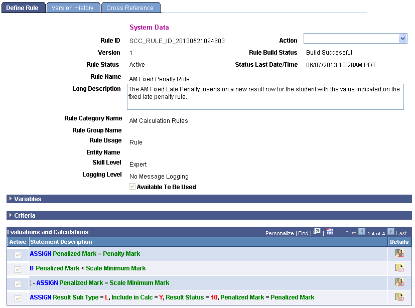

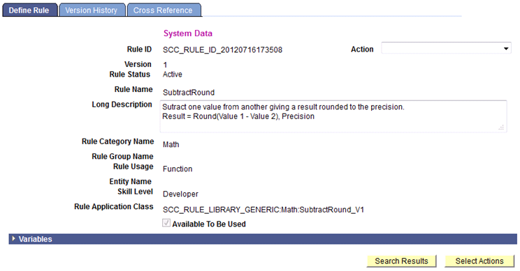

The section describes how to create functional Rules.
Access the Rules Engine Manager Define Rule page (select Set up SACR, then select System Administration, then select Rules Engine, then select Rules Engine Manager, select Add a New Rule, Define Rule).
Image: Define Rule page
This example illustrates the fields and controls on the Define Rule page. You can find definitions for the fields and controls later on this page.
Define Rule page
Note: For Rules delivered with the system and that have System Data displayed in the Rules Engine user interfaces, only the Long Description can be modified.
Field or Control
Definition
Rule ID
Displays a unique ID generated by the system. When adding a new value the default value is NOID. The unique ID is generated when the Rule is saved. The Rule ID is created by combining prefix SCC_RULE_ID_ with the system date and time stamp in format YYYYMMDDHHMMSS.
Action
Note: The list of available Actions is dynamic depending upon the Rule Status.
Note: For System-delivered Rules, only the Build Rule, Create New Group from Rule, Create New Rule from Rule, and Update Status Information (if Rule Status is Not Built) Actions are available.
Select an Action for this Rule Group:
  • Activate Rule – An In Progress Rule can be activated using the Activate Rule Action.
  • Build Rule – Opens the Build Rule window.
  • Create New Group from Rule – Selecting this Action transfers you to the Rule Group component. This Action is only available when a Rule is Active and not used by another Rule. The parameters for the new Rule Group are predefined based on the Rule from which it is being created.
  • Create New Rule from Rule – This action clones the current Rule and creates a new Rule using the values from this Rule.
    Note: The Name of the new Rule is copied exactly from the current Rule so your first action should be to rename the Rule.
  • Create New Version of Rule – Use this Action
    to introduce changes to Active Rules. By design, Rules are versioned rather than effective dated. Only one Version of a Rule can be active at any given time. This Action creates a new Version of the Rule with status In Progress. Activating the newest Version inactivates the previous Version automatically.

Version
Displays the Version number of the Rule.
Rules are automatically versioned. The first version of a Rule is 1. Only one version of a Rule can be active at any given time. The Action drop down can be used to inactivate an Active Rule and to create a new Rule Version. When creating a new Version, the previous Version automatically becomes Inactive.
Rule Status
Displays the Rule Status
  • Active
  • Inactive
  • In Progress. This is the initial Rule Status assigned when creating a Rule.
Rule Build Status
Displays the Rule Build Status. Values are:
  • Rule Not Built – The Rule has never been built.
  • Build Not Current – A change has been made to this Rule since the last build which may warrant a rebuild.)
  • Build Failed – The build/compilation process for the Rule ran to error. Consult the process scheduler message log to view the error.
  • Build Successful — The Rule was built without errors.
Status Last Date/Time
Displays the Last Date/Time of the Rule Build Status in native format including an indication of time zone. This field does not display until after an attempt to build this Rule.
Rule Name
Enter a Rule Name. The Rule Name is used when searching for a Rule and for display.
Long Description
Enter descriptive text explaining the function of the Rule.
Rule Category Name
Enter the Rule Category Name. The Rule Category restricts access to Rule Usages, Rule Categories, and Entities.
Available Rule Categories are limited to those for which you have been authorized. This is determined by a Role or our User ID.
If you have access to multiple Rule Categories, you should choose the Rule Category that is most appropriate considering the data that the Rule needs to access and any Functions that the Rule may need to call. Functional Expert users who create Rules may not necessarily be familiar with how to create Rule Categories so should be provided with instructions by Rules Engine Administrators about the Rule Categories for which they have been authorized. For example, depending on your institution's policy, Functional Experts may only be authorized to use a single Rule Category.
Rule Group Name
Enter a Rule Group Name if this Rule needs to conform to a specific template with predefined input and output Variables and a predetermined Base Entity.
Note: Oracle recommends adding a Rule Group Name directly after you have created your Rule or Function and before adding Entity Profiles, Rule Usages, or Variables as they may conflict with those that are defined in the Rule Group.
If you select a Rule Group that has Variables, a Rule Usage, or Base Entity that conflicts with the Rules you are creating, a warning message appears and the Rule Group is not added.
Rule Usage
Select a Rule Usage of Function, Rule, or Trigger. The available Rule Usages are limited to those for which the user has been authorized through Rule Category setup.
The selected Rule Usage impacts availability of Rules Engine Manager functionality as follows:
  • Rule: The Criteria grid, the Variables Grid, and Evaluations and Calculations grids are available.
  • Function or Trigger: The Variables grid and Evaluations and Calculations grids are available. The Criteria grid is not available.
Selection of Rule Usage needs to consider how this Rule is used and what tasks it needs to perform.
  • Rule – Rules can be used stand-alone (when executed from the Rules Tester), called from other Rules, or called from a Batch Process. Rules need criteria in order for the correct data to be selected from the system.
  • Trigger – Triggers are meant to be tied to a specific system event using the Trigger component. Triggers which are delivered with the System can be versioned; unlike other Rules or Functions. This means that when a Trigger has been attached to a Trigger component and marked as System, you can create a new Version of the Trigger which can subsequently be edited.
  • Function – A Function is a reusable Rule that performs a specific task, often performed in the context of a larger Rule. For example, when creating a Rule that evaluates whether Total Credit is greater than a specific Credit amount, first the Sum of all Credit needs to be established. The “Add” Function could be used to do nothing other than add retrieved Credit to a Credit total. The “Add” Function could be used to add any numeric value in the system, not just Credit, making it very reusable. A Function does not need specific criteria in order to determine an exact set of data. In this Rule Creation example, it only needs a numeric input to perform its task.
    When a Function uses a Base Entity, information to determine an exact set of data is passed from the calling Rule to the called Function using Contextual Reference.
    See Understanding Contextual Referencing.
    This example is using a Rule Usage of Rule and Skill Level of Expert to demonstrate the use of Criteria to identify a specific set of data. The Criteria in this example are used to identify the exact student Academic Progress Tracker data from the Base Entity as chosen by selecting an Entity Name. If data from other application areas is needed, it can be collected using other Functions.

  • Developer – This Skill Level has limited access to Rules Engine features. A user accessing the Rules Engine Manager and selecting Developer Skill Level is assumed to create Rules using Application Package PeopleCode. The Criteria Grid and Evaluations and Statements Grid are not available with Developer Skill Level.
In this example, a functional Rule is being created and there is no “coding” occurring. Therefore, a Skill Level of Expert is being used to demonstrate the Statement, Operator, Function, and Variable features.
Rule Application Class
Note: This field is available and required when Skill Level is Developer.
Enter or select a Rule Application Class. A Rule Application Class can be selected from a list of Extension Application Classes.
Warning! Developer Rules should be built by Developers/Programmers who have extensive experience with Application Package/Class PeopleCode programming. Developers working with the Rules Engine should be familiar with Entity Registry concepts.

To add a Variable, access the Add a New Variable page (click the Add a Variable button on the Rule Definition page).
Image: Add a New Variable page
This example illustrates the fields and controls on the Add a New Variable page. You can find definitions for the fields and controls later on this page.
Field or Control
Definition
Type
Select the Variable Type that you want to add:
  • Data Set
  • Date
  • Datetime
  • Number
  • Text
  • Time
  • True/False
Type is displayed in the Variables grid and can be selected when viewing or adding Variables.
List
Select this check box if the variable is a List variable which can contain multiple values. Use this option in combination with Type to obtain a list of specific values. List is displayed in the Variables grid and can be selected when viewing or adding Variables. Selecting this check box activates the Default Values button and the Default List Values field.
System Variable
Select this check box if the variable is a System Variable predefined in setup outside of this Rule. System Variable is displayed as System in the Variables grid and can be selected when viewing or adding Variables. Selecting this check box activates the System Variable Search button and the System Variable Name field.
Argument Name
Enter an Argument Name for Variable. The Argument Name is used when searching for a Variable and for display.
Long Description
Enter descriptive text explaining the function of the Variable.
Input
Select this check box if the variable is an Input Variable. Input is displayed in the Variables grid and can be selected when viewing or adding Variables.
Required
Select this check box if the variable is required. Required is displayed in the Variables grid and can be selected when viewing or adding Variables.
Output
Select this check box if the variable is an Output Variable. Output is displayed in the Variables grid and can be selected when viewing or adding Variables.
Default Value
Click this button to open the Create Default List Values page. Add List Values in the Value column and click the OK button.
Note: This button is available when the List option is selected.
To remove a List Value, select the corresponding Remove check box for a Value and click the Remove Selected Values button.
Note: If the List option is not selected, Default Value is an edit field. A Default Value can be entered here for this Variable.
Default List Values
Displays values for this Variable created using the Create Default List Values page.
Click this button to open the Prompt for Rules Engine System Variables page. This button only appears when System Variable is selected above.
Displays the selected System Variable Name. This field only appears when System Variable is selected above.
LOV Search
Click this button to open the Prompt for LOV Searches page.
Search on a Field Name of Description, Dropdown Prompt Filed, Edit Table, LOV Context, or LOV Unique ID.
Results display a Descr (description) link. Click the link to select an LOV. This returns you to the Add a New Variable page with the LOV Search Name displayed.
Note: LOV Search results display a list of all available LOV values. The list is not limited to those LOV values which have been created specifically for the Rules Engine.
Delete LOV
Click this button to remove an LOV. This button becomes visible when a LOV has been attached to the variable
LOV Search Name
Displays selected LOV.
Default Value Search
Click this button to open the Prompt for (selected LOV) page.
Search on a Field Name of Description or Value.
Results display a Values link.
Click the link to select a Default Value. This returns you to the Add a Variable page with the Default Value displayed.
Default Value
Displays Default Value.
Clear Default Value
Removes default value from Variable.

To add Criteria, expand the Criteria group box by clicking the arrow to the left of Criteria in the group box header.
Image: Criteria Grid – Initial Row
This example illustrates the fields and controls on the Criteria Grid – Initial Row. You can find definitions for the fields and controls later on this page.

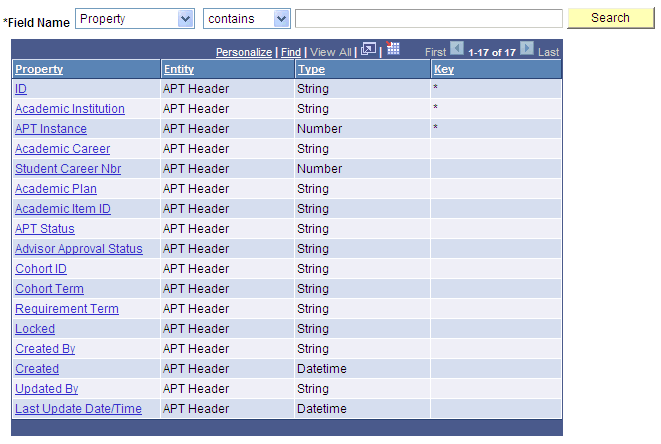

Then, click the Search icon to the right of the Label field to open the Prompt for page where you can select an Entity Property.
Image: Prompt for page
This example illustrates the fields and controls on the Prompt for page. You can find definitions for the fields and controls later on this page.
Prompt for page
Click the Academic Institution link to select it as a Property. The Prompt for page closes, and you return to the Criteria grid with the Label column in the first row populated with Academic Institution. The Operator you want to use is = and the Variable Type you want to use is Variable, both of are already populated by default in this case. Since Type Variable is selected, the Search icon appears to the right of the Object field.
Image: Example of Criteria Grid – Label Populated
This example illustrates the fields and controls on the Example of Criteria Grid – Label Populated. You can find definitions for the fields and controls later on this page.
Click the Search icon to the right of the Object field to open the Add/Select Variable page.
Image: Add/Select a Variable page
This example illustrates the fields and controls on the Add/Select a Variable page. You can find definitions for the fields and controls later on this page.
Select the check box next to the Variable you want to add, and click the Add button.
Once you've selected all the Criteria you want to add, the Criteria grid looks something like this:
This example illustrates the fields and controls on the Example of Criteria Grid. You can find definitions for the fields and controls later on this page.

Here are possible options for Types and Objects in the Criteria grid:
Label
Operator
Type
Object
Numeric Property
Variable
or
Number
Open field
or
Prompts on Number Variables.
String Property
Variable
or
Text
Open field
or
Prompts on Text Variables.
Date(time) Property
Variable
or
Date(time)
Open field
or
Prompts on Date(time) Variables.
Date Property and field name is Effective Date
Asofdate
Variable
Variable
Special handling exists for selection of Effective Date. For Entities with an Effective Date, you can choose to have the system automatically select the maximum Effective Date.
Number Property and field name is Effective Sequence
FirstSeq
LastSeq
No value available
Special handling exists for selection of Effective sequence. For entities with an effective sequence the user can choose to have the system automatically select the maximum or minimum effective sequence.
Can be used in combination with the Asofdate option.
List Property
In
Not In
Variable
List Variable which matches property Type
Text Property
Like
Not like
Variable
Text
Open field
or
Text Variable
Property of any type
Exists
Not exists
No value available
<no value>
If the Property is a Date or Date(time), any value not equal to Null exists.
If the Property is a Number, any number unequal to 0 (zero) exists.
If the Property is a String, any value unequal to space (blank) exists.
This section covers defining Rule Groups.
Understanding Rule Groups
Rules that share the functional purpose and have similar functionality, input and output can be grouped together in a Rule Group. For Rules to share the same Rule group, they must:
  • Be based on data in the same Entity Tree and use the same Entity Registry item as the basis for that Rule. This Entity is known as the Base Entity.
  • Share the same required input parameters.
  • Share a subset of non-required input parameters.
  • Share the same output parameters and can pass back required output.
  • Belong to the same Rule Category, giving them the same security Rules.
One advantage of combining Rules in Rule Groups is that it allows you to call all Rules associated with a Rule Group dynamically. You would not have to know before the fact which Rules you are calling. Rule Groups that have been created can be called from other Rules, Triggers or Functions in the Rules Engine Manager using the “CALL DYNAMIC RULE GROUP” Statement. In short, by allowing Rules to call Rules from Rule Groups dynamically without specifying Rules or Functions directly, it is possible to dynamically call one or more Rules with similar functionality.
For example, an institution has created an Academic Item Registry program with courses from which the student can choose. For all those courses that require a prerequisite, a functional Rule is created that takes the course selected as input and checks whether the student meets the prerequisite requirement. When students select courses to add to their Academic Progress Tracker (APT), the prerequisite is checked, and, based on the outcome, a message is displayed to the student indicating whether or not he or she may add the course to their APT.
Example Rules for this scenario could be:
  • Students must have completed Introduction to Calculus or Elementary Algebra before attempting Advanced Calculus
  • Students must have completed Introduction to Psychology and have completed 10 credits from the “Human Studies” Course List before attempting Advanced Psychology.
Another advantage to creating Rules in the same Rule Group is the ability to control that the input and output for all Rules in the Rule Group is the same.
Each of these Rules needs to take the selected Course as input as well as information from the program of study and the student. All Rules above would return a similar outcome of true or false as well as a message that can be displayed. The Rules can be grouped together in the same Rule Group.
Note: Rule Groups should be created by Rules Engine Experts or Developers. The settings used in Rule Groups are enforced for any Rule added to the Rule Group. Once a Rule has been added to a Rule Group, the Rule's input and output parameters cannot be altered; however, it is still be possible to add to and alter Statements in the Evaluations and Calculations grid. Also, Rule Groups with Active Rules attached cannot be changed.
You may find it challenging to define a new Rule Group with input and output variables and specifications for the Base Entity if you have not built the actual Rule that will be using the Rule Group . When building Rules, some experimentation is in order, and it is not always clear before the fact what exactly the input and the output of a Rule needs to be. Rule logic is optimized during the build process, and input or output Variables may need to be added based on new specifications or insights. Therefore, it may not be possible to define a template for input and output before any Rule has been built.
Rule Groups can also be created from Active Rules using the Rules Engine Manager Action Create Rule Group. Rule Groups can also be created using one of the available Rules Engine Search options.
Defining New Rule Groups
Access the Rule Groups Manager Categories page (select Set up SACR, then select System Administration, then select Rules Engine, then select Define Rule Groups, select Add a New Rule Group, select the Categories tab).
Image: Define Rule Groups Categories page
This example illustrates the fields and controls on the Define Rule Groups Categories page. You can find definitions for the fields and controls later on this page.
Note: For Rule Categories delivered with the system, only the Long Description on the Definition page and Rule Groups and Security pages can be modified
Field or Control
Definition
Rule Category
Enter the Rule Categories for this Rule Group. Rule Groups are tied to one or more Rule Category Names.
Note: Assign categories first before selecting a Base Entity in the Definition tab.
Entity Name
Enter the Entity for the Rule Group. The Entity entered here is the Default Base Entity for any Rules added to this Rule Group. The Base Entity controls which application data You have access to when building the Rule, Function, or Trigger.
View Entity Hierarchy
Click this link to display the Entity Hierarchy view for the Base Entity attached to the Rule Group.
Access the Rule Groups Manager Definition page (select Set up SACR, then select System Administration, then select Rules Engine, then select Define Rule Groups, select Add a New Rule Group, select the Definitions tab).
Image: Define Rule Groups Definition page
This example illustrates the fields and controls on the Define Rule Groups Definition page. You can find definitions for the fields and controls later on this page.
Field or Control
Definition
Action
Note: For System-delivered Rule Groups, only the Create Rule from Rule Group and Create Rule Group from Group Actions are available.
  • Activate Rule Group – In Progress Rule Group can be Activated using the Activate Rule Group option.
    Note: When creating a Rule Group from an Active or In Progress Rule, the Rule Group is immediately active and does not need not be activated. The Activate Rule Group action is not available.
  • Create Rule from Rule Group – This action creates a Rule from the current Rule Group using the values (Variables, Rule Usage, Entity Profile from the Current Group). If multiple Categories are present for the Rule Group you are prompted to select one.
    Note: The Create Rule from Group action is only available for Active Rule Groups.
  • Create Rule Group from Group – This action clones the current Rule Group and creates a new Rule Group using the values from this Rule Group.
    Note: The Name of the new Rule Group is copied exactly from the current Rule Group so your first action should be to rename the Rule Group.
  • Delete Rule Group – Rule Groups can be deleted. When choosing this option a warning is displayed first. After choosing OK the Rule is Deleted. This is only available if no Rules are attached to this Rule Group
  • Inactivate Rule Group – Active Rule Groups can be inactivated using the Inactivate Rule Group option. This is only possible if no Rules are attached to the Rule Group
  • Remove Base Entity – Use this Action to remove the Base Entity from this Rule Group. This Action is available when Rules have a status of In Progress or Active. For Active Rule Groups, the setup option to allow changes to active Rules must be selected. If an Active Rule Group has Rules attached, then the Base Entity may not be removed.
    Note: The Base Entity cannot be removed if the Rule is attached to a Rule Group.
Note: The Inactivate Rule Group and Delete Rule Group actions are not available for Rule Groups with Active Rules attached.
Rule Group ID
Displays a unique ID generated by the system. When adding a new value the default value is NOID. The unique ID is generated when the Rule Group is saved. The Rule Group ID is created by combining prefix SCC_RULEGR_ID_ with the system date and time stamp in format YYYYMMDDHHMMSS.
Rule Group Status
  • In Progress
  • Active
Used By X Rules
Displays the number of Rules associated with this Rule Group; includes Active and Inactive Rules.
Rule Group Name
Enter a Rule Group Name. The Rule Group Name is used when searching for a Rule Group and for display.
Long Description
Enter descriptive text explaining the function of the Rule Group.
Rule Usage
  • Function
  • Rule
  • Trigger
Available To Be Used
Select this check box if you want this Rule Group to be available for use by the statement CALL DYNAMIC RULE GROUP.
Note: If the Allow Changes to Active Rules check box on the Rule Engine Install Options page is not selected, the Available in Dynamic Rules check box cannot be selected here.
Dynamic Rule Variable
A Dynamic Rule Variable is always created when a Rule Group is created. This Variable is used when calling Rules using the Dynamic Rule Group statement to call the required Rule ID.
Add a Variable
Select this button to open the Add a New Variable page.
For more information, see Adding Variables to a Rule.
Access the Rule Groups Manager Cross Reference page (select Set up SACR, then select System Administration, then select Rules Engine, then select Define Rule Groups, search for a Rule Group and select the Cross Reference tab).
Image: Define Rule Groups Cross Reference page
This example illustrates the fields and controls on the Define Rule Groups Cross Reference page. You can find definitions for the fields and controls later on this page.
This page shows Rules and Rule Groups associated with this System Variable.
Field or Control
Definition
Rule Name
Displays to authorized users links for Rules attached to this Rule Group. If a user is not authorized, the link is disabled.
Click a link to transfer out of the component and to the referenced object.
Warning! Make sure you have saved any data that you need to before confirming you want to transfer to the referenced object in a new component.
If no objects use the Rule Group, a notification is shown in place of the object details; for example, “This Rule Group is not used by any Rules”.
Version
Displays the Rule Version Number.
Rule Status
Displays the status of the Rule (In Progress, Active, In-active).
Rule Category Name
Displays the Rule Category Name in which the Rule has been created.
After a Trigger Rule is defined, a Trigger Definition can be created. Trigger Definitions allow you to associate the Trigger Rule to a Component Event or an Entity Method and generate PeopleCode that can be added to the associated component, record, or field event specified on the Define Rule Triggers page using the Generate Code button.
Note: The component helps to generate Template PeopleCode but does not automatically add this code to the specified event. You may want or need to adjust generated code to add institution specific business logic.
Access the Define Rule Triggers page (select Set Up SACR, then select System Administration, then select Rules Engine, then select Setup, then select Define Rule Triggers).
Image: Define Rule Triggers page
This example illustrates the fields and controls on the Define Rule Triggers page. You can find definitions for the fields and controls later on this page.
Field or Control
Definition
Trigger ID
Displays a unique ID generated by the system. When adding a new value the default value is NOID. The unique ID is generated when the Rule Trigger is saved. The Trigger ID is created by combining prefix SCC_RTRIG_ with the system date and time stamp in format YYYYMMDDHHMMSS.
Name
Enter a Trigger Name. The Trigger Name is used when searching for a Trigger and for display.
Trigger Description
Enter descriptive text explaining the function of the Trigger.
Event
Note: This field is only available if the Trigger Type is Online Application.
Choose the PeopleCode Component Event to add to the Trigger:
  • FieldEdit
  • FieldChange
  • SavePostChange
  • SaveFieldChange
Component
Select from a list of available Components in the environment by Component Name or Description.
Record
Select from a list of available records for the selected Component or any record in the system if no Component is selected by Record Name or Description.
Field
Select from a list of available fields for the selected Record selected by Field Name or Description.
Rule Category Name
Select from a list of Rule Categories for which the “Allow Trigger” option has been selected on the Define Rule Categories definition page by Rule Category Name or Long Description.
Rule Name
Select a Rule to associate with the Trigger.
For information about integrating the Rules Engine with a user interface, see Integrating User Interfaces with the Rules Engine
