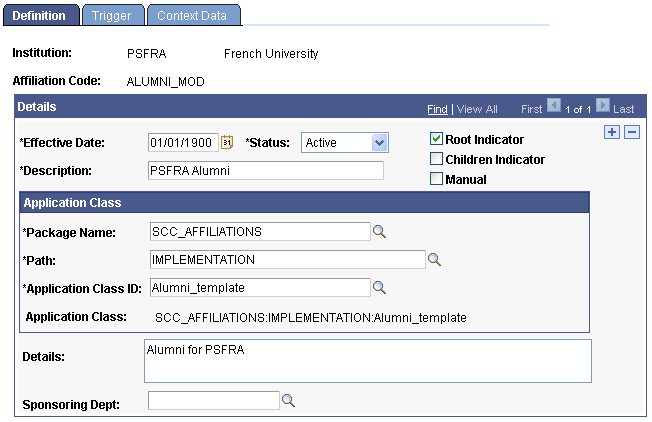

Access the Definition page (select Set Up SACR, then select Common Definitions, then select Affiliations, then select Affiliation Setup, then select Definition).
Image: Definition page
This example illustrates the fields and controls on the Definition page. You can find definitions for the fields and controls later on this page.
Definition page
Campus Solutions delivers five predefined Affiliation Code examples: Alumni, Recruiter, Applicant, Student, and Non-Student Employee. The Application Class and the triggering event information is already set up for these codes. You can define the details of an affiliation code, and assign it a place in a hierarchy. Hierarchies of affiliation are designated with the Root Indicator and Children Indicator check boxes.

Application Class
Displays the Application Class created by selection of the Package Name, Path, and Application Class ID on this page and assigned for this Affiliation Code
The Application Class field is specified on the last node or leaf of the hierarchy, at the lowest level when defining a triggered affiliation code. The class is created in App Designer and contains the implementation logic or transaction validation logic for the specific affiliation code. The system uses the class defined here to determine which affiliations are set and not set for a person.

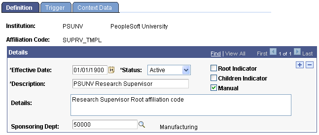

Single-Level Hierarchy Example
In this example, the Root Indicator check box is selected and the Children Indicator check box is clear. This specifies that there are no additional subcategories or children associated with this affiliation code. Since this is the lowest level in the hierarchy, the application class is entered here to define the transactional logic.
Image: Single-level hierarchy example
This example illustrates the fields and controls on the Single-level hierarchy example. You can find definitions for the fields and controls later on this page.

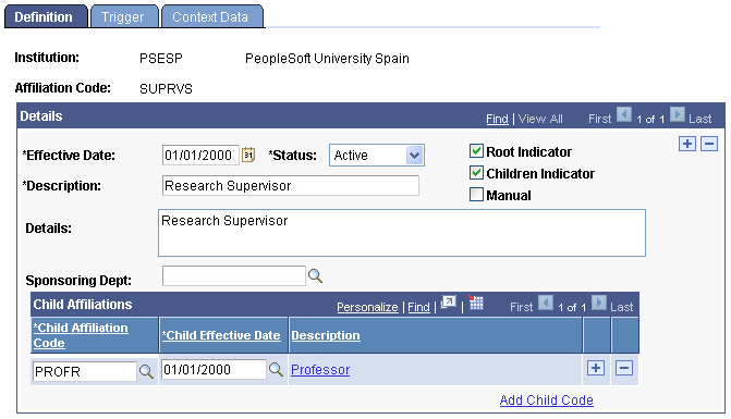

Two-Level Hierarchy Example
In this example, the Root Indicator check box is selected and the Children Indicator check box is selected for the parent/root affiliation. This specifies that the root has additional subcategories or children associated with it. When you select the Children Indicator check box, you can then enter an associated Child Affiliation Code that has already been defined.
Image: Two-level hierarchy example (1 of 2)
This example illustrates the fields and controls on the Two-level hierarchy example (1 of 2). You can find definitions for the fields and controls later on this page.
The lowest level of a hierarchical affiliation does not have the check boxes for either Root Indicator or Children Indicator selected. In a two-level hierarchy, the child of the affiliation has no indicator boxes checked and the Application Class field contains the actual affiliation application class value.
Image: Two-level hierarchy example (2 of 2)
This example illustrates the fields and controls on the Two-level hierarchy example (2 of 2). You can find definitions for the fields and controls later on this page.

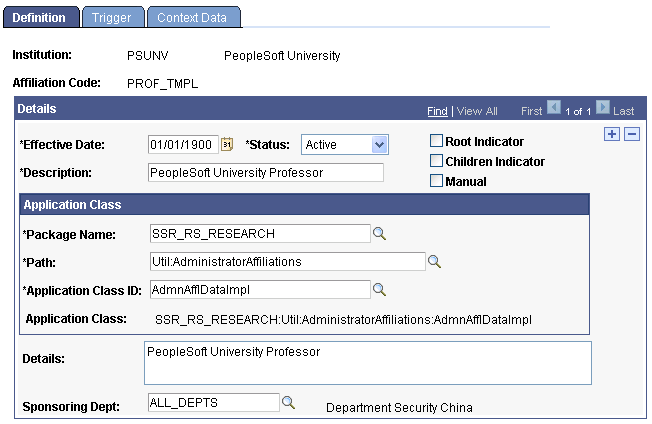

Three-or-More-Level Hierarchy Example
In this example, both the Root Indicator check box and the Children Indicator check box are selected for the parent/root affiliation code. This specifies that the root has additional subcategories or children associated with it. When you select the Children Indicator check box, you can then define or enter an associated Child Affiliation Code that has already been defined.
Image: Three-or-more level hierarchy example (1 of 3)
This example illustrates the fields and controls on the Three-or-more level hierarchy example (1 of 3). You can find definitions for the fields and controls later on this page.
For the middle-level affiliation codes, the Root Indicator check box is cleared and the Children Indicator check box is selected. This specifies that the affiliation code is not the root and it has additional subcategories associated with it. When you select the Children Indicator check box, you can then enter the associated Children Affiliation Code that has already been defined for this affiliation code.
Image: Three-or-more level hierarchy example (2 of 3)
This example illustrates the fields and controls on the Three-or-more level hierarchy example (2 of 3). You can find definitions for the fields and controls later on this page.
Three-or-more level hierarchy example (3 of 3)
The lowest level of a hierarchical affiliation does not have the boxes for Root Indicator or Children Indicator selected. These are left clear and the Application Class contains the actual affiliation application class value.
Image: Three-or-more level hierarchy example (3 of 3)
This example illustrates the fields and controls on the Three-or-more level hierarchy example (3 of 3). You can find definitions for the fields and controls later on this page.

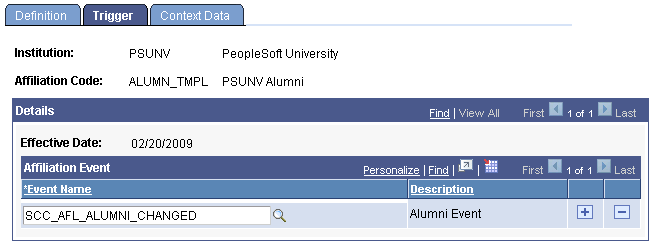

Access the Trigger page (select Set Up SACR, then select Common Definitions, then select Affiliations, then select Affiliation Setup, then select Trigger).
Image: Trigger page
This example illustrates the fields and controls on the Trigger page. You can find definitions for the fields and controls later on this page.
Trigger page
Add the Event Name, registered through the Constituent Event Registration component, that associates the application class with a constituent management service operation for the affiliation code. There are six delivered triggers that correspond to the system-defined affiliation templates for Alumni, Recruiter, and Non-Student Employee. These are:
  • Alumni: SCC_AFL_ALUMNI_CHANGED
  • Recruiter: SCC_AFL_RECRUITER_CHANGED
  • Non-Student Employee: WORKFORCE_SYNC
  • Applicant: SCC_AFL_APPLICANT_CHANGED
  • Student: SCC_AFL_STUDENT_CHANGED ( for Student Enrollment) , SCC_AFL_STUDENT1 (for Quick Admit Student)
For information about how Research Tracking leverages Affiliations, see Setting Up Research Tracking.
See PeopleSoft Campus Solutions Constituent Web Services Developer's Guide in My Oracle Support (ID 1982192.1).

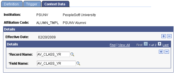

Access the Context Data page (select Set Up SACR, then select Common Definitions, then select Affiliations, then select Affiliation Setup, then select Context Data).
Image: Context Data page
This example illustrates the fields and controls on the Context Data page. You can find definitions for the fields and controls later on this page.
Context Data page
The Context Data tab of the Affiliation Setup component is used to associate additional record/field pairs with the Affiliation Code. These details are then included as part of the data when the Affiliation event message is published. Up to ten separate record/field pairs may be defined.
Field or Control
Definition
Record Name
Select the Record Name table or Record Name for the Field Name you want to associate with the Affiliation Code.
Field Name
Select the Field Name you want to associate with the Affiliation Code and publish within the Affiliation message.
