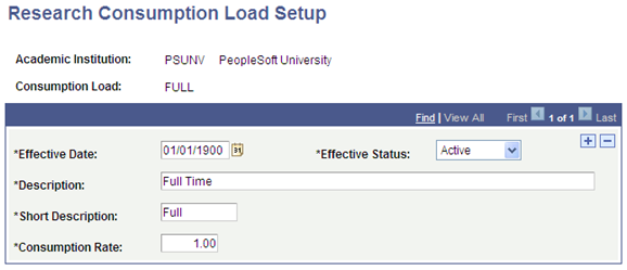

Access the Research Consumption Load Setup page (select Set Up SACR, then select Product Related, then select Student Records, then select Research Management, then select Research Consumption Load, then select Research Consumption Load Setup).
Image: Research Consumption Load Setup page
This example illustrates the fields and controls on the Research Consumption Load Setup page. You can find definitions for the fields and controls later on this page.
Use this page to set up the valid consumption load values at the institution. Consumption load defines the rate at which a candidate conducts his or her research. This is similar to the principle of academic load, but is not based on enrollment. A consumption rate of 1.0 implies that 100 percent of the candidate’s time is spent performing research and related activities. The consumption rate directly impacts the length of time a candidate is projected to complete the research and submit the thesis for evaluation. The values that you set up here are used on the Research Processing Options page in the Academic Program Table and Academic Plan Table components, as well as in the Candidature Details page in Admissions and in the Candidate Management component.
See:

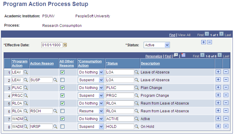

Access the Program Action Process Setup page (select Set Up SACR, then select Product Related, then select Student Records, then select Program Action, then select Program Action Process Setup).
Image: Program Action Process Setup page
This example illustrates the fields and controls on the Program Action Process Setup page. You can find definitions for the fields and controls later on this page.
Use this page to define Program Action/Action Reason combinations which can trigger an update of the student’s candidate information from the Student Program/Plan component.
Enter a Consumption Action and Status for a Program Action/Action Reason. When the Program Action/Action Reason combination is saved in the Student Program Plan component, the related Consumption Action and Status values are automatically inserted in the SSR_RS_CONSMPTN record (Consumption and Submission page in the Candidate Management component).
You can use this feature to automatically suspend and resume the consumption process. This action is performed only if the Days consumption model has been selected for the candidate.
Note: This is an optional feature and should be carefully implemented after an analysis of your business requirements.
Field or Control
Definition
Program Action
You must select a value. Values are defined on the Program Action Table page.
Action Reason
The available values are those defined on the Program Action Reason Table page.
All Other Reasons
Select this check box to identify how Program Action / Action Reason values other than those specifically defined should be treated.
Consumption Action
Indicates how the consumption calculation process is affected by the Program Action and Action Reason. The available values are: Suspend (the calculation), Resume (from a previously suspended state), and Do Nothing (no effect).
Status
The available values are the Status Codes defined for the System Usage Value of Consumption on the Process Status Codes page.
See Tracking Consumption and Submission.
