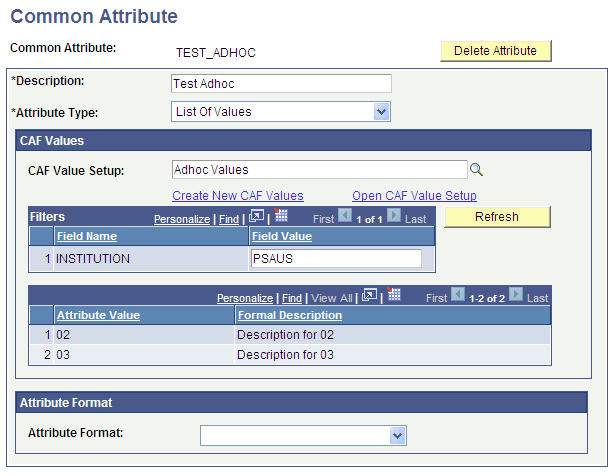

Access the Common Attribute page (select Set Up SACR, then select Common Definitions, then select Common Attributes Setup, then select Common Attribute).
Image: Common Attribute page
This example illustrates the fields and controls on the Common Attribute page. You can find definitions for the fields and controls later on this page.
Continuing with the GENL_MATERIALS record example that was discussed in the Application Designer section, we use the Common Attribute page to create the common attribute - Passport Number - as shown in this example screenshot:
Image: Example of a Common Attribute
This example illustrates the fields and controls on the Example of a Common Attribute . You can find definitions for the fields and controls later on this page.

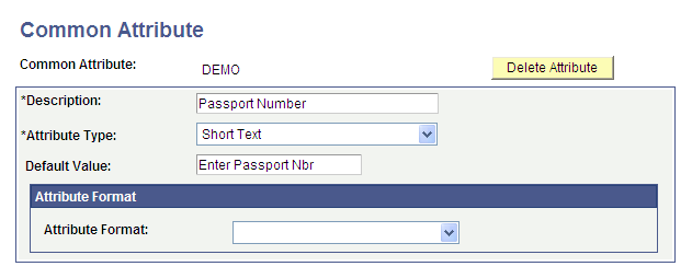

Default Value
Available only when the Attribute Type is Short Text, Long Text, Number, Text, or Yes/No. When the Attribute Type is Yes/No, you can set the default value by selecting the Yes or No radio button.
The value that you enter here appears as the default value for the attribute in the delivered subpages.

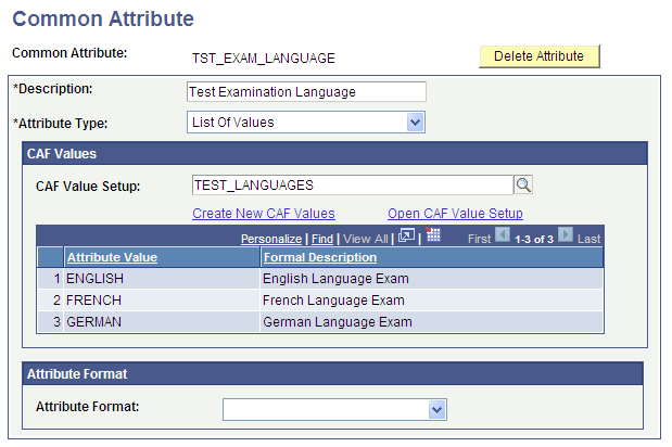

CAF Values
This group box is available only when the Attribute Type is List of Values.
Image: Example of a Common Attribute page for List of Values
This example illustrates the fields and controls on the Example of a Common Attribute page for List of Values. You can find definitions for the fields and controls later on this page.
Use the CAF Values group box to define the values in the list.
Field or Control
Definition
CAF Value Setup
Indicates the list of values definition that you have selected for the attribute.
If you enter this page in Add mode, the CAF Value Setup field is blank. You can either use this field to select a list of values that already exists in the system or click the Create New CAF Values link to create a new list of values definition.
Click to access the CAF Values - LOV Definition page where you can define a new list of values for the attribute.
Open CAF Value Setup
This link appears only if the CAF Value Setup field is populated.
Click this link to access the CAF Values - LOV Definition page where you can view or edit the list of values that is selected for the attribute.
Filters
When a common attribute with a List of Values type based on Ad Hoc Values or Table is saved and the associated CAF value setup in the CAF Values - LOV Definition page uses a filter field, the Filters grid is available on the Common Attribute component:
Image: Example of a Common Attribute page with the Filters grid
This example illustrates the fields and controls on the Example of a Common Attribute page with the Filters grid. You can find definitions for the fields and controls later on this page.
This feature enables you to preview the values that will be available to a user based on the filter field values defined in the CAF Values - LOV Definition page. To preview the values that are available, enter a field value in the Filters grid and click the Refresh button.
See Defining a Common Attribute, “Defining a List of Values for a Common Attribute.”

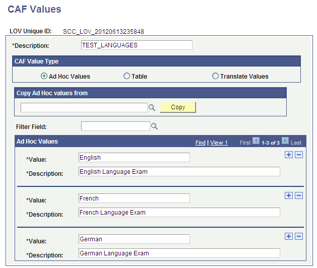

Defining Ad Hoc List of Values
If the CAF Value Type is Ad Hoc Values, then you can enter a free-form list of value and description pairs.
Image: CAF Values - LOV Definition page (Ad Hoc list of values)
This example illustrates the fields and controls on the CAF Values - LOV Definition page (Ad Hoc list of values). You can find definitions for the fields and controls later on this page.
CAF (Common Attribute Framework) Values - LOV Definition page (Ad Hoc list of values)
Enter the value-description pairs in the Ad Hoc Values group box.
Use the Copy Ad Hoc Values From group box to copy values from an existing list. To copy values from an existing list: Click the lookup icon in the Copy Ad Hoc Values From group box, select a list, and click the Copy button. If you want to define new values for the list, leave the group box blank.

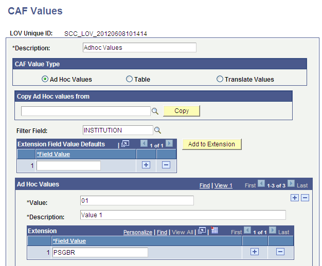

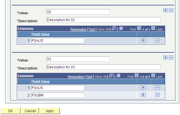

If the ad hoc list of values, which an attribute on a page displays, should be filtered based on a field value in that page, then select the field name in Filter Field. When you select a filter field, the Extension grid becomes available in the Ad Hoc Values scroll area. Use the Extension grid to specify the field value for which a value-description pair becomes available. For example, suppose you have a list of values attribute on a page and the same page has an Institution field. When a user enters PSAUS in the Institution field, you want the attribute to display 02 and 03 as the list of values. And when a user enters PSGBR in the Institution field, you want the attribute to display 01 and 03 as the list of values. The following example shows how to set up this scenario:
Image: Example of filtering an attribute's list of values (1 of 2)
This example illustrates the fields and controls on the Example of filtering an attribute's list of values (1 of 2). You can find definitions for the fields and controls later on this page.
Image: Example of filtering an attribute's list of values (2 of 2)
This example illustrates the fields and controls on the Example of filtering an attribute's list of values (2 of 2). You can find definitions for the fields and controls later on this page.
To aid in data entry, you can use the Extension Field Value Defaults grid to quickly add a field value to all the Extension grids in the Ad Hoc Values scroll area. Enter a field value in the Extension Field Value Defaults grid and then click the Add to Extension button to add the field value to all the Extension grids.
Note: Field Value is a free-form field. Therefore, you must be careful to provide the correct value for the Extension grid. The value you enter as the Field Value is case sensitive.

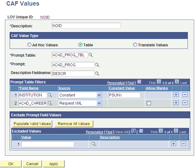

Defining List of Values from a Table
If the CAF Value Type is Table, then specify the record (Prompt Table) and field (Prompt) on which the list of values should be based.
Image: CAF Values - LOV Definition page (list of values retrieved from a table)
This example illustrates the fields and controls on the CAF Values - LOV Definition page (list of values retrieved from a table). You can find definitions for the fields and controls later on this page.
CAF (Common Attribute Framework) Values - LOV Definition page (list of values retrieved from a table)
Use Description Fieldname to indicate the description field for the value's description.
If there are any fields in the prompt table whose value the system should use to filter the list of values, specify these fields in the Prompt Table Filters grid.
If you select a source option of Constant, then you can enter the filter value in the Constant Value field. If you select a source option of Request XML, then the framework will try to automatically figure out the value of the filter field from the page at runtime. For example, suppose you have added an Academic Program list of values attribute on a page, and the same page displays an Institution and Academic Career field. You want the list of values to display academic programs for only the PSUNV institution and for the academic career which the user selects. The above screenshot shows how to set up this scenario.
To exclude any values from being displayed at runtime, specify these values in the Exclude Prompt Field Values grid. Click the Populate Valid Values button to populate the Excluded Values grid with the field’s (Prompt's) values. Click the Remove All Values button to remove all the values from the Excluded Values grid.

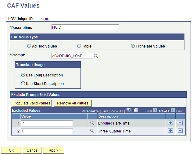

Defining Translate List of Values
If the CAF Value Type is Translate Values, then specify the translate field (Prompt) on which the list of values should be based.
Image: CAF Values - LOV Definition page (list of values retrieved from a translate field)
This example illustrates the fields and controls on the CAF Values - LOV Definition page (list of values retrieved from a translate field). You can find definitions for the fields and controls later on this page.
CAF (Common Attribute Framework) Values - LOV Definition page (list of values retrieved from a translate field)
Use the Translate Usage grid to specify if the framework should use the translate long description or short description as the value’s description.
