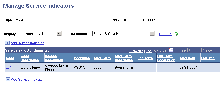

Access the Manage Service Indicators page (select Campus Community, then select Service Indicators, then select Person, then select Manage Service Indicators).
Image: Manage Service Indicators page (for individuals)
This example illustrates the fields and controls on the Manage Service Indicators page (for individuals). You can find definitions for the fields and controls later on this page.

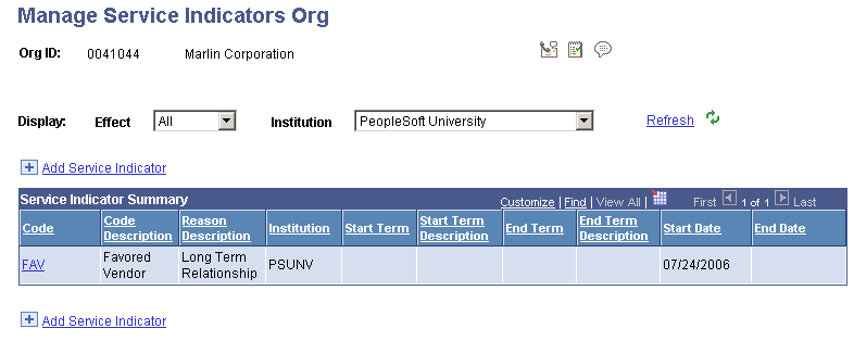

Image: Manage Service Indicators Org page (for organizations)
This example illustrates the fields and controls on the Manage Service Indicators Org page (for organizations). You can find definitions for the fields and controls later on this page.
Note: Assigned service indicators use the current effective-dated service indicator definition on the Service Indicator Codes page. If a new effective-dated row is added to a service indicator definition, the changes to that row will affect existing assignments to IDs as well as new assignments to IDs.
Field or Control
Definition
Effect, Institution, and Refresh
Select the effect of the service indicators from the available values: All, Positive, and Negative. Enter the institution whose service indicators you want to display for the ID. You must click Refresh to display data according to the effect and institution that you enter.
Add Service Indicator
Click to access the Add Service Indicator page, where you can assign a service indicator to this ID within the associated institution.
This link appears at both the top and bottom of the page when the list of service indicators is long.
Service Indicator Summary
Field or Control
Definition
Code
Click the service indicator code in the code column to access the Edit Service Indicator page, where you can view and edit details of the assigned service indicator.

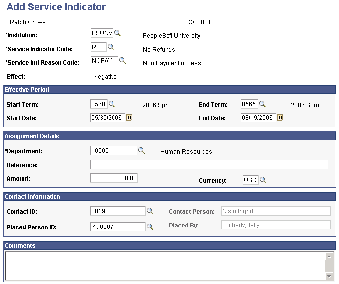

For individuals, access the Add Service Indicator page. (For the Add Service Indicator page, click the Add Service Indicator link on the Manage Service Indicators page for individuals. For the Edit Service Indicator page, click the link for a service indicator in the code column on the Manage Service Indicators page for individuals.)
Image: Add Service Indicator page (1 of 2)
This example illustrates the fields and controls on the Add Service Indicator page (1 of 2). You can find definitions for the fields and controls later on this page.
Image: Add Service Indicator page (2 of 2)
This example illustrates the fields and controls on the Add Service Indicator page (2 of 2). You can find definitions for the fields and controls later on this page.

Field or Control
Definition
Institution
Enter the code for the institution that is responsible for this service indicator.
Enter the code for the service indicator to assign to the individual.
Service Ind Reason Code (service indicator reason code)
Enter the reason that you are assigning this service indicator to the individual.
Note: Only the reason codes that are associated with the specific service indicator on the Service Indicator Codes page are available.
Effect
The system displays the effect associated with the service indicator that you select. Values are Positive or Negative.
Effective Period
You can assign a service indicator with a beginning and an end to its validity for an ID. You can specify a date on which the date-based impacts for a service indicator will take effect, and a date on which they will cease to be in effect. Similarly, you can specify a term at the beginning of which to apply the term-based impacts associated with the service indicator, and specify a term at the end of which to cease to apply the impacts. You can further control the validity period of term-based and date-based impacts. If you do not want the indicator to be valid during the entire start-to-end term period, you can specify dates within either or both terms to use for starting and ending the validity.
Note: The service impacts associated with a service indicator can be term-based or date-based. They are applied or released based on the start and end information that you enter.
Field or Control
Definition
Start Term and End Term
Enter the term during which the service indicator should become valid for the ID, and enter the term during which it should cease to be valid for the ID.
A Start Term value of 0000 means that term-based impacts will be in effect for all terms. A Start Term value of 9999 means that term-based impacts will never take effect.
If no End Term value is entered, term-based impacts will be in effect until the service indicator is released.
Start Date and End Date
Enter the date on which the service indicator should become valid for the ID, and enter the date on which it should cease to be valid for the ID.
If no End Date value is entered, date-based impacts will be in effect until the service indicator is released.
Assignment Details
Field or Control
Definition
Department
Enter the department that is responsible for placing the service indicator (or requesting its placement) on the individual's record.
Reference
Enter a reference number or other data that may assist in tracking and identifying the service indicator and its resolution.
Amount
Enter the monetary amount, if any, that is required to satisfy the reason for this service indicator.
Currency
Specify the currency in which the monetary amount is expressed.
Contact Information
Field or Control
Definition
Contact ID and Contact Person
Enter the ID and name of the person to contact with questions about this service indicator.
Placed Person ID and Placed By
The system displays the current user's ID and name. You can override this value to enter whatever your institution requires.
You can enter the ID or, if no ID exists, you can enter the name of the person who placed the service indicator on the individual's record. Enter the name in the lastname;firstname format. Alternatively, you can identify the person who requested that the service indicator be placed on the record.
Comments
Field or Control
Definition
Comments
Enter comments to further describe or identify the reason for the service indicator.

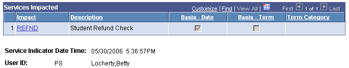

Services Impacted
Field or Control
Definition
Impact
Click the code in the Impact column to access the Service Impact Description page, where you can view details about the impact.
Basis - Date or Basis - Term
The system indicates whether the service impact is set to be considered or disregarded (both manually or in the automated process) based on the begin and end values that you specify for the service indicator. When the Basis - Term check box is selected, the impact will start and end for the terms that you specify. If the Basis - Date check box is selected, the impact will start and end on the dates that you specify.
If either or both of the check boxes are selected but you enter no values for the End Term or End Date fields, then the impact will remain in effect until manually released.
Term Category
Appears only if the impact is term-based.
Note: This value is provided for informational purposes for administrative users. Delivered processes do not consider the term category.
Displays the term of the service impact as it is associated with the service indicator on the Service Indicator Codes page. If the term falls within the Start Term and End Term period and a term category appears, you must determine whether the category of that term matches the category shown. If it does not, you should consider the impact not in effect.
For example, a student applies for a parking permit for the Fall 2007 term, which has a term category of Regular. You assign the service indicator with a parking impact to the student, but the impact has an associated term category of Summer. Because the term begin and end dates of the service indicator do not fall within the dates of the summer term, the impact is not in effect.
See Defining Terms, Sessions, and Session Time Periods.
Service Indicator Date Time
The system displays the current day and time when the service indicator was assigned.
User ID and Name
The system displays the ID of the user who is entering or changing information on the page.
