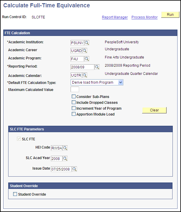

Access the Calculate Full-Time Equivalence page (select Financial Aid, then select Student Loans Company, then select Calculate FTE, then select Calculate SLC FTE).
Image: Calculate Full-Time Equivalence page
This example illustrates the fields and controls on the Calculate Full-Time Equivalence page. You can find definitions for the fields and controls later on this page.
This process uses the same FTE logic as the FTE process for student records with the addition of the SLC FTE Parameters to determine if there is an ACR record which requires a response. For more information about calculating FTE for HESA and SLC:

In the SCL FTE Parameters group box, all 3 parameters, HEI Code, SLC Acad Year, and Issue Date are required.
