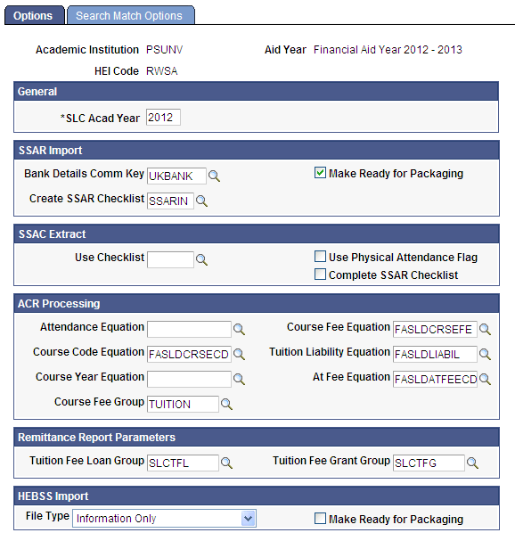

Access the Student Loans Company Setup - Options page (select Financial Aid, then select Student Loans Company, then select Student Loans Company Setup, then select Options).
Image: Student Loans Company Setup - Options page
This example illustrates the fields and controls on the Student Loans Company Setup - Options page. You can find definitions for the fields and controls later on this page.
General
Field or Control
Definition
SLC Acad Year (Student Loans Company academic year)
Select the year for which this setup is intended.
SSAR Import
Field or Control
Definition
Bank Details Comm Key (bank details communication key)
Select the communication key to be used when the Bank Details Held fields in the Student Support Attendance Requests (SSAR) files being imported have a value of N.
The communication is created only if the communication designated by the communication key does not already exist for the student.
Create SSAR Checklist (create Student Support Attendance Requests checklist)
Select the checklist to be assigned to students when their SSAR record is imported.
This checklist can be used for controlling disbursement of Tuition Fee Grant (TFG) and Tuition Fee Loan (TFL) award disbursements. Disbursement rules can consider a checklist status. The checklist is created only if the designated checklist code does not already exist for the student.
Make Ready for Packaging
Select this check box to update the Packaging status to Ready for Packaging.
The Packaging status is updated for a student when either of the following is true:
  • Initial SSAR data is received for the student for this SLC academic year.
  • A subsequent SSAR file is received for the student for this SLC academic year with a TFL or TFG amount that is different from the amount stored for the student and the student's Packaging status is Packaging Completed.
SSAC Extract
Field or Control
Definition
Use Checklist
Select the checklist to be used when selecting the students to be included in the Generate SSAC Data process. When evaluating whether the student can be included in the SSAC Extract, the process determines whether the student has this checklist assigned and whether the checklist is complete.
Use Physical Attendance Flag
Select this check box to ensure that the Generate SSAC Data process checks to see if the student's physical attendance is confirmed when evaluating whether the student can be included in the SSAC Extract.
Complete SSAR Checklist (complete Student Support Attendance Requests checklist)
Select this check box to ensure that the Generate SSAC Data process updates the status of the checklist designated in the Create SSAR Checklist field to Complete.
ACR Processing
Use this group box to:
  • Associate equations with each of the Attendance Confirmation Report (ACR) elements that is used to determine the At Fee Code that is sent in the ACR Response File from the HEI to the SLC.
  • Designate a course fee group to be used in the Course Fee element.
  • Designate an equation to determine the At Fee Code to be returned for each student with the ACR Response File.
At Fee Codes are defined by the SLC.
When writing equations to be used by the At Fee Evaluation process, ensure that they return values for the same calendar date. These values can be compared with students' ACR data to determine the At Fee Code. The exception is the attendance status, which is determined for the same calendar date as the other equations, but which has no ACR field to use for comparison.
The values that are available in the equation fields in this group box appear by default from the Equation Editor (EQUATION_EDITOR) component select (Set Up SACR, then select Common Definitions, then select Equation Engine, then select Equation Editor, then select Equation Editor).
If you write equations to be selected in the Attendance Equation, Course Code Equation, Course Year Equation, Course Fee Equation, and Tuition Liability Equation fields:
  • The Attendance Equation must set the value for the SFA_SLC_EQ_ATTSTAT field.
    The translate values for SFA_SLC_EQ_ATTSTAT are A - In Attendance, N - Not in Attendance, and S - Studies Suspended.
  • The Course Code Equation must return the UCAS or SLC Code for the course (depending on which type of course code was provided on the ACR).
  • The Course Year Equation must return the year of the course of study/program in which the student is enrolled; for example, a value such as 1, 2, 3, or 4.
  • The Course Fee Equation must return the amount of tuition fees charged to the student for this academic year.
  • The Tuition Liability Equation should set the following equation engine variables:
    • SFA_SLC_EQ_TUITLN - Tuition Loan Amt
    • SFA_SLC_EQ_TUITGNT - Tuition Grant Amt
    • SFA_SLC_EQ_TUITSTD - Tuition Student Liable Amt
Field or Control
Definition
Course Fee Group
Select the fee group to be used by the Course Fee equation. Values appear by default from the Student Financials Item Type Groups (ITEM_GROUPINGS) component select (Set Up SACR, then select Product Related, then select Student Financials, then select Item Types, then select Item Type Groups).
All fields in the ACR Processing group box are optional.
However, to use the ACR At Fee Evaluation process, you must write an equation to be selected in the At Fee Equation field.
The At Fee Equation should be coded to populate the Equation Engine variable SFA_SLC_ATTEND_IND.
You can write the At Fee equation so that it uses the results of one or more of the other equations in the ACR Processing group box, or you can write an At Fee equation that does not rely on other equation results.
See Running the ACR At Fee Evaluation Process.

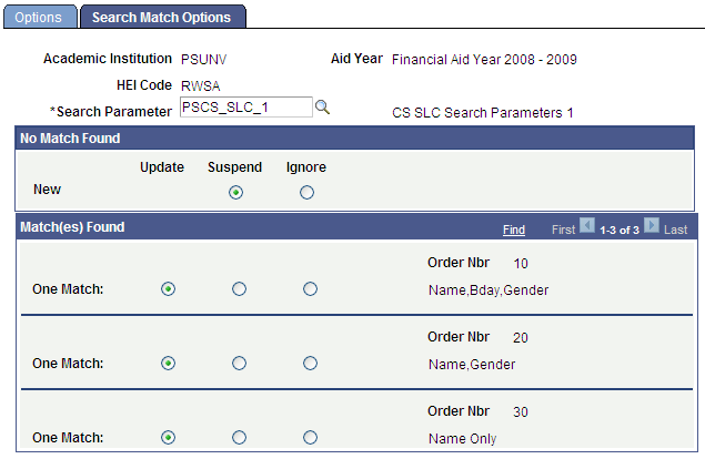

Access the Student Loans Company Setup - Search Match Options page (select Financial Aid, then select Student Loans Company, then select Student Loans Company Setup, then select Search Match Options).
Image: Student Loans Company Setup - Search Match Options page
This example illustrates the fields and controls on the Student Loans Company Setup - Search Match Options page.
Use this page to select the search parameters that you want to use for the Import SSAR Files process, the Import HEBSS Files process, and the Import ACR/SISF process, and the subsequent actions to be taken for the different match scenarios.
Note: Students for whom an exact Student Support Number match exists have their records directly added to the Student SLC table and are not be subject to the Search/Match options defined on this page.

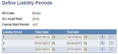

The section describes how to define Liability Periods for unique combinations of HEI, Academic Year, and Course Start Periods for determining student liability for full tuition fee loans.
Access the Define Liability Periods page (select Financial Aid, then select Student Loans Company, then select Student Loans Company Setup, then select Define Liability Periods).
Image: Define Liability Periods page
This example illustrates the fields and controls on the Define Liability Periods page. You can find definitions for the fields and controls later on this page.
Field or Control
Definition
Liability Period
Select the Liability Period for the context Course Start Period.
Start Date andEnd Date
Enter the Liability Period Start and End Dates. Liability Period Dates cannot overlap.
