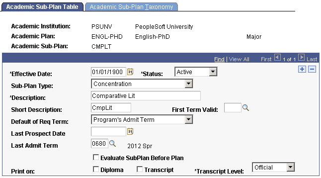

Access the Academic Sub-Plan Table page (select Set Up SACR, then select Foundation Tables, then select Academic Structure, then select Academic SubPlan Table, then select Academic Sub-Plan Table).
Image: Academic Sub-Plan Table page
This example illustrates the fields and controls on the Academic Sub-Plan Table page. You can find definitions for the fields and controls later on this page.
Field or Control
Definition
Sub-Plan Type
Enter a type for the academic subplan. You can modify these translate values.
First Term Valid
Enter the first term in which students can be admitted to the academic subplan. You cannot admit students to the academic subplan before the term that you specify. If you enter the term 0000, you can admit students to the subplan for any term. When you convert data to the PeopleSoft system, be sure that you enter a first valid term that is appropriate for the preexisting data for the academic subplan. This field is optional.
Note: Students can modify this subplan when their admit term is prior to this term as long as the effective date of the change is greater than or equal to the start date of this term.
Default of Req Term (default of requirement term)
Select the default term for which the system begins accumulating requirements for the academic subplan. You can override the default value for individual students on the Student Sub-Plan page. Modification of these translate values requires significant programming effort.
Note: Set a default here so that when you analyze completion requirements for an academic subplan, you know which set of requirements to use. Requirements can change over time.
Last Prospect Date
Enter the latest date that a subplan can be populated for a new prospect record. You cannot assign a program to a subplan if the system date is greater than the last prospect date.
Last Admit Term
Enter the last term in which students can be admitted to the academic subplan. You cannot admit students to the academic subplan after the term that you specify. The system will compare the admit term used in the student's application to this last term valid value. If the admit term is greater than this value, the program is not available to the user. This field is optional.
Evaluate SubPlan Before Plan
Select to alter reporting sequences. This check box is a feature of Academic Advisement.
Diploma
Select to print a description on student diplomas. The Diploma Description field becomes available.
Transcript
Select to print a description on student transcripts. The Transcript Description field becomes available.
Diploma Description
Enter the description of the academic subplan. This description appears on student diplomas. The PeopleSoft system currently does not provide a process to print diplomas.
Enter the description of this academic subplan. This description appears on student transcripts. You can override this text when you prepare students' transcripts.
Indent
Enter the number of spaces that you want to indent the related description when printing the document.
