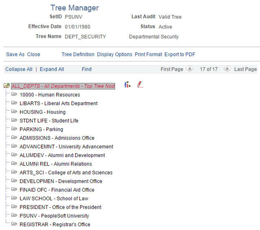

You use PeopleSoft Tree Manager to build a hierarchy of department security for an organization. A security tree provides a graphic means to grant and restrict access to data. The security tree does not have to represent your organization's hierarchy exactly, although it is usually very close.
To grant a row security permission list access to a group of departments, you grant access to the department to which all of those departments report. You can restrict access to individual departments or to a group of departments if you need to. This is an example of a department security tree for the PSUNV set ID:
Image: Tree Manager Page
This example illustrates the fields and controls on the Tree Manager Page. You can find definitions for the fields and controls later on this page.
Tree Manager page
Using this security tree you could, for example, grant a row security permission list access at the top level for ‘ALL_DEPTS’ and allow access to everyone in all the child department entities.

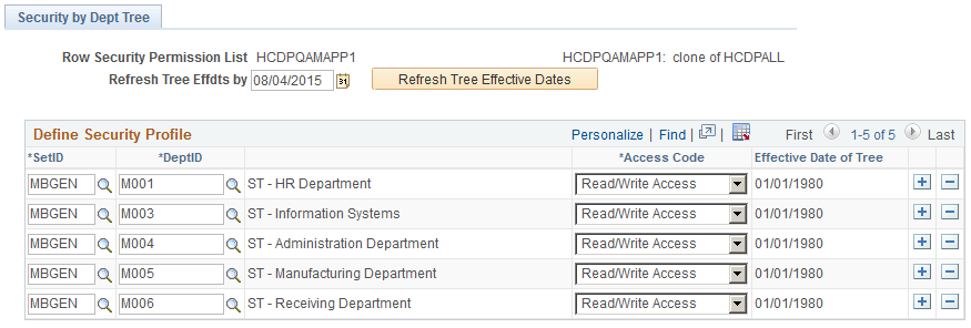

Access the Security by Dept Tree page (select Set Up Common Objects, then select Security, then select Core Row Level Security, then select Security by Dept Tree).
Image: Security by Department Tree Page
This example illustrates the fields and controls on the Security by Department Tree Page. You can find definitions for the fields and controls later on this page.
Field or Control
Definition
Refresh Tree Effdts by (refresh tree effective dates by)
The system references the trees that are effective as of this date when you select a tree set ID in the Define Security Profile grid. Select a date in the future to reference a future-dated tree.
For example, to use the department security trees that are current as of today's date, enter today's date in this field.
Refresh Tree Effective Dates
Select to refresh the trees listed in the Define Security Profile grid to trees that are effective as of the date in the As of Date for Trees field. Note: To ensure that your row security permission lists use the current trees you must enter the appropriate as of date and click this button whenever you create a more recent version of a set ID's security tree.
Field or Control
Definition
Set ID and Dept ID (set ID and department ID)
Enter the tree set ID and the ID of the department that you are granting access to. The row security permission list has access to each department ID that reports up to this one on the security tree (unless you specify otherwise) so you don't have to select each department ID individually.
Access Code
Indicate what kind of access the row security permission list has to the data for this department ID. To restrict access to one or more departments that report up to a department ID that you've granted access to, insert a row and select the restricted department's ID and then select an Access Code of No Access.
You need to restrict access explicitly only for department IDs that report up to the department ID to which you want to grant access. Otherwise, the row security permission list doesn't have access to a department unless it or the department to which it reports has been granted access on this page.
Effective Date of Tree
Displays this set ID's tree effective date. Make sure that the effective date of the tree is accurate. The system does not update the effective date automatically if you make a newer version of a tree. To update trees, enter the date as of which the tree is effective in the Refresh Tree Effdts by field and click the Refresh Tree Effective Dates button.

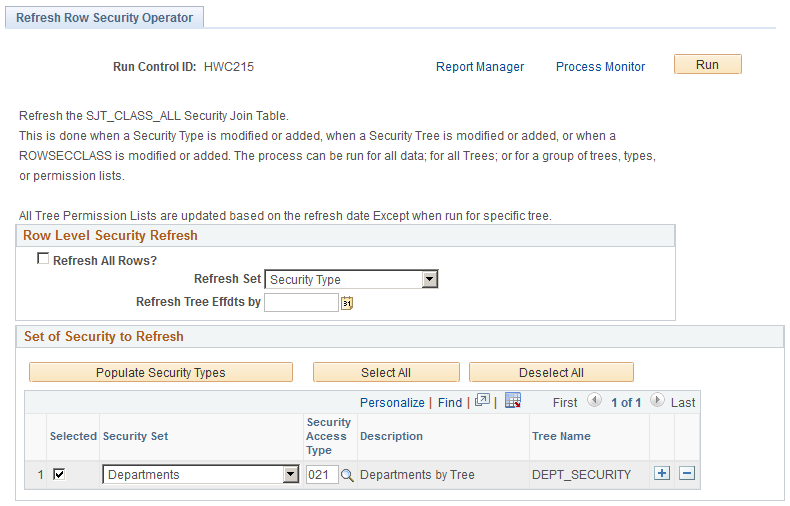

Access the Refresh Row Security Operator page (select Set Up Common Objects, then select Security, then select Core Row Level Security, then select Refresh SJT_CLASS_ALL).
Image: Refreshing Row Level Security Operator Page
This example illustrates the fields and controls on the Refreshing Row Level Security Operator Page. You can find definitions for the fields and controls later on this page.
Field or Control
Definition
Refresh All Rows
Select to refresh every row in SJT_CLASS_ALL.
Deselect to refresh selected rows. The system displays the Refresh Set field.
Refresh Set
Select the set of rows to refresh. The system displays the Set of Security to Refresh grid.
You can select to refresh:
  • All Trees
  • Permission List
  • Security Type
  • Specific Tree.
Select the date as of which you are refreshing the table. The process refreshes the table with the security data that is effective as of this date.
Select the values to refresh.
For example, if you've modified a row security permission list, rather than refreshing the entire table, select Permission List in the Refresh Set field and select the permission list you modified here.
If you've modified a specific tree, select Specific Tree in the Refresh Set field and select the setIDs to refresh for that tree.

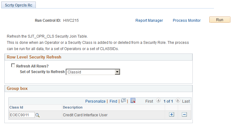

Access the Scrty Oprcls Rc (Security Operator Class) page (select Set Up Common Objects, then select Security, then select Core Row Level Security, then select Refresh SJT_OPR_CLS).
Image: Scrty Oprcls Rc (Security Operator Class) page
This example illustrates the fields and controls on the Scrty Oprcls Rc (Security Operator Class) page. You can find definitions for the fields and controls later on this page.
The Refresh SJT_OPR_CLS process refreshes SJT_OPR_CLS as of the system date.
Field or Control
Definition
Refresh All Rows
Select to refresh every row in SJT_OPR_CLS.
Deselect to refresh selected rows. The system displays the Set of Security to Refresh field.
  • Classid – Select to refresh the table with the selected row security or role-based permission lists IDs of users to whom they are attached.
  • Oprid – Select to refresh the table with the selected user IDs and the permission lists assigned to them.
