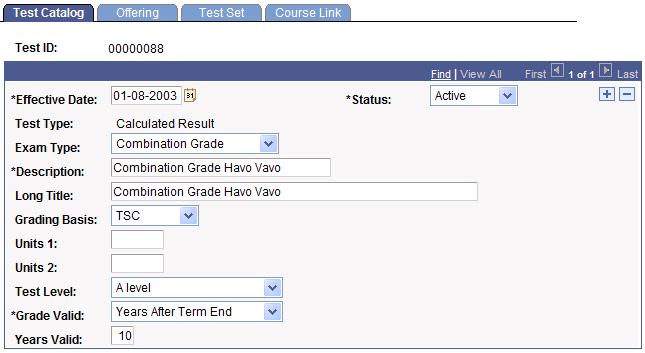

Access the Test Catalog page (select (Records and Enrollment, then select Test Administration NLD, then select Set Up Test Administration, then select Test Catalog, then select Test Catalog).
Image: Test Catalog page
This example illustrates the fields and controls on the Test Catalog page. You can find definitions for the fields and controls later on this page.
Test Catalog page
Field or Control
Definition
Test Type
When entering a new value in the catalog, select whether you are creating a Test or a Calculated Result.
When you save the test or calculated result, this field becomes view only.
Exam Type
Select the exam type for this calculated result. Values are Central End Exam, Combination Grade, End Exam, Partial Qualification, Qualification, and School Exam.
The exam type affects Test Administration grade calculation processing.
If you select an Exam Type of Combination Grade for a calculated result, the grade calculation process looks for underlying student results where the Combination Grade check box on the Student VAVO Course Details page is selected. If the Combination Grade check box is selected, the underlying grade counts towards the overall Combination Grade. If the check box is cleared, the underlying result is managed in a way similar to a course exemption—the underlying results are exempted and the Student Grade table results Grade Attribute field is updated with the grade attribute Exempt Combination Grade.
See Maintaining VAVO Course Options.
Grading Basis
Select the grading basis to be used with this test or calculated result.
Units 1 and Units 2
Enter the number of credited units the student gets after completing the test or calculated result.
These fields are used in the evaluation process based on how each individual institution needs to use them.
Test Level
Select the level of difficulty of the test or calculated result. Values are A level, B level, C level, and D level.
These levels are used for reporting purposes only and are not part of the calculation process.
Grade Valid
Select the period for which the grade is valid. Values are Unlimited and Years After Term End. If you select Years After Term End, the Years Valid field appears.
Years Valid
Enter the number of years that the grade assigned to a student for this test or calculated result is valid. This field appears if you select Years After Term End in the Grade Valid field.
