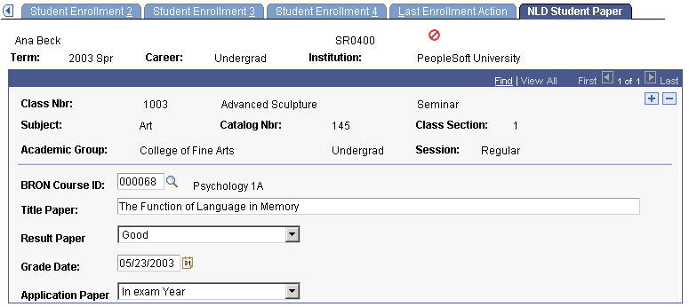

NLD Student Paper (Dutch student paper)
SAD_BR_SPAP_NLD
select Records and Enrollment, then select Enroll Students, then select Enrollment, then select NLD Student Paper
This page appears if you select the Use Dutch Functionality check box on the Student Admin Installation page. Use this page to record the student's end thesis for BRON reporting purposes. This information is used in the exam result data set for VAVO, which is the 331 file sent to BRON.

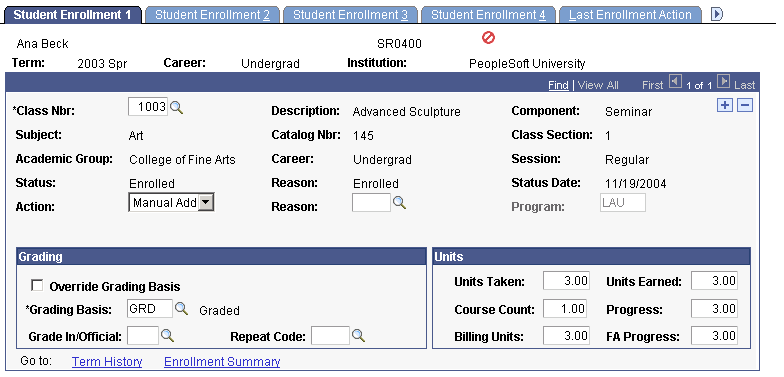

Access the Student Enrollment 1 page (select Records and Enrollment, then select Enroll Students, then select Enrollment, then select Student Enrollment 1).
Image: Student Enrollment 1 page
This example illustrates the fields and controls on the Student Enrollment 1 page. You can find definitions for the fields and controls later on this page.
Field or Control
Definition
Calculate End Date
This button becomes available when you select to add a class section within an OEE session and you enter a value in the Start Date field. Click this button to have the system calculate the end date of the OEE class section based on the start date that you enter.
Class Nbr (class number)
Select the class in which you want to add or drop the student. Class values for other fields appear according to the schedule of classes and class associations.
Status
The system displays the student's current enrollment status in the class section. The system sets the student's status based on the enrollment action that you process. If you have added or are adding the student to the specified class section through this component, the system displays the status as Enrolled. If you have dropped the student from the specified class section through this component, the system displays the status as Dropped up through the drop retain record period. After this period has passed, the system displays the status as Enrolled and assigns the corresponding penalty grade to the student enrollment record.
Statuses are: Enrolled, Waiting, and Dropped.
Reason
The system displays the reason associated with the student's current enrollment status in the class section. If you have added or are adding the student to the specified class section through this component, the system displays the reason as Enrolled. If you have dropped the student from the specified class section through this component, the system displays the reason as Dropped (was enrolled).
Status Date
The date that you process the enrollment transaction for the corresponding row of the request. The system records the status date to track the date that you process information. The system uses the current system date for new enrollment transactions.
Action
Select from the following choices the action to perform on the enrollment record. Values for this field are delivered with your system as translate values. Do not modify these values in any way. Any modifications to these values require a substantial programming effort. Choices are as follows:
Drop: Select to drop the student from the corresponding class section.
Manual Add: Select to manually enroll the student into the corresponding class section, bypassing all enrollment rules and requirements.
Reason
If you are dropping the student from the specified class section, select the reason for the enrollment action, such as whether the student is dropping the class or the class has been canceled. A reason value is not required.
Program
Enter the student's academic program for this enrollment. This field appears if you selected the Select Acad Prog During Enroll check box on the Academic Institution 5 page. This field is editable only if the student is active in more than one academic program for this term. If this is the case, the student's primary academic program for this term appears by default. You can change this value.
Grade In / Official
The grade in is the final grade given to the student for the class. You can enter the grade here, or you can use the grade roster generator. When a grade is entered and posted, the system displays the grade here.
Note: Posting grades on the Student Enrollment 1 page does not automatically run the repeat checking process.
The grade lapse process does not include incomplete grades entered on the Student Enrollment 1 page.
The grade official is the official grade for calculation and transcript purposes. The Grading Basis automatically translates the grade In to another value in this field, if appropriate.
Units Earned
The system uses units earned to determine academic level, as well as to grant actual credit to the student. This field is separate from units taken to accommodate the granting of partial credit for a class while continuing to have the class count fully towards GPA, academic load, or billing. Units earned default from units taken. When you add an enrollment for a student using another enrollment component, the units earned also defaults to the same value as units taken. Regardless of the enrollment component, you must adjust units earned on the Student Enrollment 1 page.
Note: Units earned can be entered at any time, although they do not apply to a student's transcript until the class is graded.
Progress
Indicates the number of units the system uses, in conjunction with the billing factor, to calculate billing units. The system also uses progress units to calculate academic load. The system by default sets the value of this field to the academic progress units value on the Class Associations page.
Billing Units
In Student Financials, all per unit term fees, per unit course fees, and per unit class fees are driven off of the billing units. Billing units are calculated for an enrollment record by multiplying the billing factor, which is set on the Class Associations page, and the academic progress units for the selected class. Because the system by default sets the billing factor 1, billing units are usually equal to academic progress units. The Student Enrollment 1 page is the only place where you can override billing units for an individual enrollment. For example, if you set the billing factor to 2 and the academic progress units to 3, the billing units would be 6. This would be multiplied by whatever amount per billing unit you establish in Student Financials. But if you want to discount the class for a specific student, you could change the billing units here on the Student Enrollment 1 page back to 3.
FA Progress (financial aid progress)
Indicates units towards financial aid progress.
Term History link
Click to access the Term History component, where you can view all of a student's term statistics for each term of the student's academic career, withdraw the student from the specified term or session, and more.
Enrollment Summary link
Click to access the Enrollment Summary component, where you can view a summary of a student's enrollment information and term statistics.
Save
Click to post enrollment immediately to the student's enrollment record.
Warning! The system performs no checks against your enrollment rules.

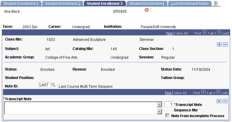

Access the Student Enrollment 3 page (select Records and Enrollment, then select Enroll Students, then select Enrollment, then select Student Enrollment 3).
Image: Student Enrollment 3 page
This example illustrates the fields and controls on the Student Enrollment 3 page. You can find definitions for the fields and controls later on this page.
Field or Control
Definition
Student Position
The student's enrollment position in the class section, which it uses for wait list processing.
Tuition Group
The tuition group to which this class section is tied. A tuition group is the shared characteristics among students. When you register students, the system automatically assigns them to the appropriate tuition groups. When you run the tuition calculation process, it sees that this class section is associated with the tuition group that you specify, and thus charges all students in the tuition group the fees for this class section of the course offering. You can tie all class sections of a course offering to a tuition group on the Course Catalog - Offerings page. You can tie specific class sections of a course offering to a tuition group on the Class Associations page.
Note ID
Select a standard transcript note for the class, if applicable.
Transcript Note
Enter additional free-form text about the specified transcript note. The system prints the text that you enter onto the student's transcript.
Transcript Note Sequence Nbr (transcript note sequence number)
Enter the sequence number of the transcript note. The sequence number indicates the printing order of the transcript notes that you specify.
Note From Incomplete Process
The system automatically selects this check box when the note is added during the incomplete/grade lapse process.

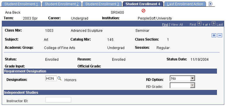

Access the Student Enrollment 4 page (select Records and Enrollment, then select Enroll Students, then select Enrollment, then select Student Enrollment 4).
Image: Student Enrollment 4 page
This example illustrates the fields and controls on the Student Enrollment 4 page. You can find definitions for the fields and controls later on this page.

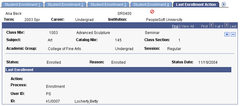

Access the Last Enrollment Action page (select Records and Enrollment, then select Enroll Students, then select Enrollment, then select Last Enrollment Action).
Image: Last Enrollment Action page
This example illustrates the fields and controls on the Last Enrollment Action page. You can find definitions for the fields and controls later on this page.
Field or Control
Definition
Action
The last enrollment action taken for this student through the Enrollment component.
Process
The process used for the last enrollment action. The possible values for this field are Enrollment, which refers to this page; Enrollment Request, which refers to the enrollment engine; Grade Post, which refers to the grade posting process; and Class Cancelled.
User ID
The user ID of the user who performed the last enrollment action for this class enrollment.
ID
The individual ID of the user who performed the last enrollment action for this class enrollment.

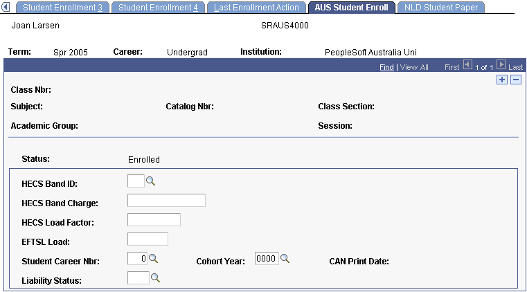

Access the AUS Student Enroll page (select Records and Enrollment, then select Enroll Students, then select Enrollment, then select AUS Student Enroll).).
Image: AUS Student Enroll page
This example illustrates the fields and controls on the AUS Student Enroll page. You can find definitions for the fields and controls later on this page.
Field or Control
Definition
HECS Band ID
The system enters this value from the course catalog.
HECS Band Charge
The system enter the HECS band charge for the band ID.
HECS Load Factor
Enter the HECS load factor for this enrollment.
EFTSL Load
Enter the equivalent full-time student load for this enrollment.
Student Career Number
The system enters the value from the Student Term Activation page.
Cohort Year
The system enters this value from the Student Term Activation page.
Liability Status

The date the CAN was printed for this student.
Access the Cdn Student Enrollment page (select (Records and Enrollment, then select Enroll Students, then select Enrollment, then select Cdn Student Enrollment).
See Defining PSIS Student Enrollment Data.

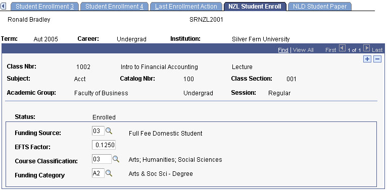

Access the NZL Student Enroll page (select Records and Enrollment, then select Enroll Students, then select Enrollment, then select NZL Student Enroll).
Image: NZL Student Enroll page
This example illustrates the fields and controls on the NZL Student Enroll page. You can find definitions for the fields and controls later on this page.
NZL (New Zealand) Student Enroll page
Field or Control
Definition
Funding Source
The system enters this value from the student's program.
Enter the funding source for the student's program on the Student Program page.
EFTS Factor
Course Classification
The system enters this value from the Acad Prog NZL (academic program New Zealand) page for course classifications defined with the type Program. For course classifications defined with the type Course, the system enters the value from the course catalog.
Set up course classifications on the Course Classifications page.
See Defining Course Classifications.
Funding Category
If the student's program has a course classification type of Program, the first character from the Academic Program table is concatenated with the second character of the course catalog value, otherwise the course catalog value is used.
Access the NLD Student Paper page (select Records and Enrollment, then select Enroll Students, then select Enrollment, then select NLD Student Paper).
Image: NLD Student Paper page
This example illustrates the fields and controls on the NLD Student Paper page. You can find definitions for the fields and controls later on this page.
Field or Control
Definition
BRON Course ID
Select a BRON course ID to link to the student's end thesis.
Title Paper
Enter the title of the student's end thesis.
Result Paper
Select the result of the student's end paper. Values are Adequate, Good, and Insufficient.
Grade Date
Enter the date the student received the grade for the end paper.
Application Paper
Enter whether the student completed the paper In exam Year, or, if not, whether the reason was Dispensation—meaning the student was excused from completing the paper—Exchanged for Diploma, or Passed without Grade.
