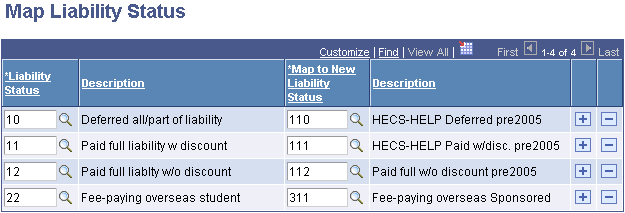

Access the Map Liability Status page (select Set Up SACR, then select Product Related, then select Student Records, then select Enrollment Reporting Codes, then select AUS Regulatory Report Setup, then select Map Liability Status, then select Map Liability Status).
Image: Map Liability Status page
This example illustrates the fields and controls on the Map Liability Status page. You can find definitions for the fields and controls later on this page.
A liability status defines a student's payment options (for example, deferred or pay up front) and is assigned to each student in the term activation component.
The liability status codes are defined by DIISRTE. In 2005, the codes were changed from two-digit to three-digit codes. For historical purposes, your system must maintain the two-digit codes.
Field or Control
Definition
Liability Status
Select the two-digit liability status code.
Map to New Liability Status
Select the equivalent three-digit liability status code.

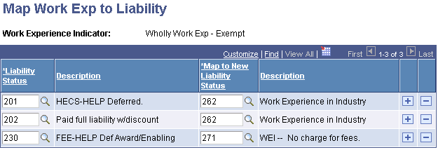

Access the Map Work Exp to Liability page (select Set Up SACR, then select Product Related, then select Student Records, then select Enrollment Reporting Codes, then select AUS Regulatory Report Setup, then select Map Work Exp to Liability, then select Map Work Exp to Liability).
Image: Map Work Exp to Liability page
This example illustrates the fields and controls on the Map Work Exp to Liability page. You can find definitions for the fields and controls later on this page.
WEI is work that is done as a part of, or in connection with, a course of study undertaken with a higher education provider (HEP) and the purpose of which is to obtain work experience relevant to the course of study.
The work experience can be a unit of study that is directed or supported by your institution for which the student pays a contribution amount or tuition fees, or it can be work experience not directed or supported by an institution for which the student pays no contribution or fees.
Field or Control
Definition
Work Experience Indicator
When setting up a new indicator, select the appropriate value.
The work experience indicators are:
  • Not Wholly Work Experience: The HEP directs the learning and performance of the student. The work experience is treated as a normal unit, and the student is charged appropriately.
  • Wholly Work Exp - Exempt: The HEP does not provide direction or support for the work experience, and the unit of study is exempt from student contributions and tuition fees.
  • Wholly Work Exp with Charge: The HEP supports the learning and performance of the student and may charge the student contribution amounts and tuition fees.
Liability Status
Select a liability status that your institution has entered as a default status for a course.
Select the equivalent liability status for students who have enrolled in the course for WEI.

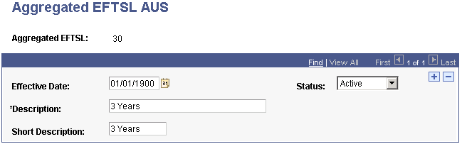

Setting Up Aggregated EFTSL Values
Access the Aggregated EFTSL AUS page (select Set Up SACR, then select Foundation Tables, then select Reporting Codes, then select Aggregated EFTSL AUS, then select Aggregated EFTSL AUS, then select Aggregated EFTSL AUS).
Image: Aggregated EFTSL AUS page
This example illustrates the fields and controls on the Aggregated EFTSL AUS page. You can find definitions for the fields and controls later on this page.
DIISRTE requires that institutions report EFTSL values for each student, each year. A student's total EFTSL for a year is equal to the sum of EFTSL values for each term for which he or she is enrolled in that year. The student's total EFTSL value for each term is the sum of the EFTSL for each class in which the student is enrolled in that term. The EFTSL value for each class is determined by dividing the number of units for each class in which the student is enrolled that term by the total annual units for that program of study.
Aggregated EFTSL values are the total number of EFTSL values that a student accumulates while completing a program of study. This value is used to derive the element 350 Course of Study Load on the Course of Study file.
DIISRTE provides the codes for aggregated EFTSL. You must enter the codes (in tenths) into the system so that you can show the equivalent course of study load (program load). For example, the program value of 30 is equal to 3 years EFTSL.
You assign an aggregated EFTSL to each of your programs on the Academic Program AUS page.
