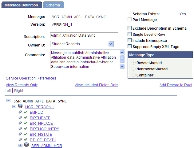

    Image: Message Definition page
    A Message Definition is delivered for processing affiliations created through the Administrative Profile Management component. This is a rowset-based message. Verify that the message SSR_ADMN_AFFL_DATA_SYNC is available in your database and that schema exists for the message. Refer to the following example:
    Note: If the Schema does not exist, generate the schema using the Message Schema Builder.

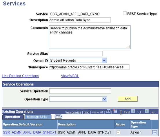

  2. Integration Broker Service:
    select PeopleTools, then select Integration Broker, then select Integration Setup, then select Services
    Image: Services page
    An Integration Broker Service definition is created to communicate with the Affiliation framework. Verify that the Service definition SSR_ADMN_AFFL_DATA_SYNC is available in your database.
    Services page

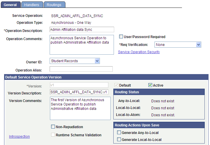

    Image: General (SSR_ADMN_AFFL_DATA_SYNC) page
    An Integration Broker Service Operation is created to communicate with the Affiliation framework. Verify that the Service Operation definition SSR_ADMN_AFFL_DATA_SYNC is available in your database.
    Select the Active check box.
    After the Service Operation is Active, perform the following steps:
    1. Generate Local-to-Local routing.
    When you select the Generate Local-to-Local check box the Local-to-Local value appears. Additionally, system generated Routing information is populated on the Routings page.

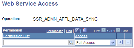

    2. Set up Security.
    Click the Service Operation Security link to access the Web Service Access page and assign one or more permission lists to the service operation.
    Image: Web Service Access page
    This example illustrates the Web Service Access page as explained above.

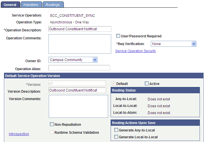

    Image: General (SCC_CONSTITUENT_SYNC) page
    Additionally, ensure that the following Service Operation which is available in your database (SCC_CONSTITUENT_SYNC) is also Active and Service Operation Security has been set up.

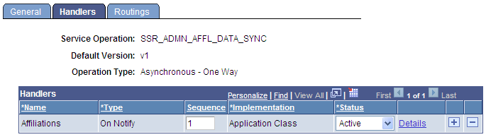

  4. Integration Broker Service Operation Handler
    select PeopleTools, then select Integration Broker, then select Integration Setup, then select Service Operations, then select Handlers
    Image: Handlers (SSR_ADMN_AFFL_DATA_SYNC) page
    An Integration Broker Service Operation Handler is delivered to support integration with the Affiliation framework. Verify that the following handler definition is available in your database.
    Set the status to Active.

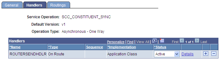

    Image: Handlers (SCC_CONSTITUENT_SYNC) page
    Additionally, set the following Integration Broker Service Operation Handler to Active:

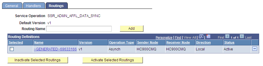

  5. Service Operation Routing
    Image: Routings (SSR_ADMN_AFFL_DATA_SYNC) page
    Review the Service operation routing and note the local routing that was automatically generated when you saved the operation.

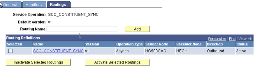

    Image: Routings (SCC_CONSTITUENT_SYNC) page
    Additionally, review the Service operation routing and note the local routing that was automatically generated when you saved the operation for SCC_CONSTITUENT_SYNC.

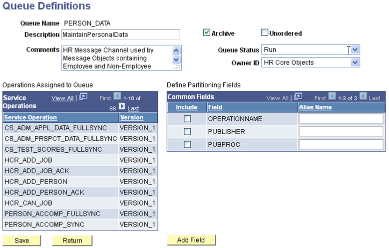

  6. Service Operation Queue Definition

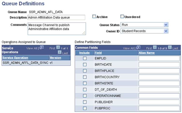

    Image: Queue Definition (SSR_ADMN_AFFL_DATA_SYNC) page
    A queue definition is delivered to support integration with the Affiliation framework. Verify that the following handler definition is available in your database.
    Set the Queue Status to Run.
    Image: Queue Definition (PERSON_DATA) page
    Additionally, set the Queue Status to Run for the following queue definition (PERSON_DATA):

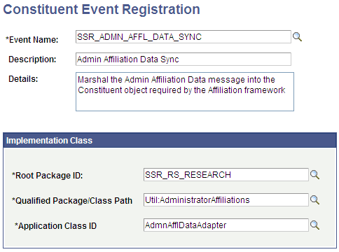

  7. Constituent Event Registry
    select Setup SACR, then select System Administration, then select Utilities, then select Constituent Management, then select Constituent Event Registration
    Image: Constituent Event Registration page
    A Constituent Event (SSR_ADMN_AFFL_DATA_SYNC) is registered to support integration with the Affiliation framework. Verify that following entry is available in your database.

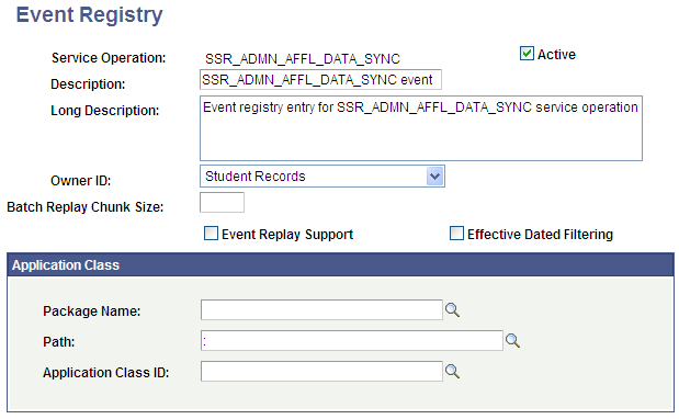

  8. SOA Framework Event Registry
    select Setup SACR, then select System Administration, then select Integrations, then select Event Register
    Image: Event Registry page
    An event is registered in Campus Solutions SOA Framework to support integration with the Affiliation framework. Verify that following entry is available in your database and is Active.
    Event Registry page
