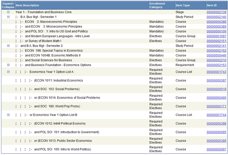

Image: Program Tree Requirements example
The following example shows the program tree requirements for year one of a program. In this particular case, the Item Type Stage is a planning node for this program.
To satisfy the course requirements for Year 1, students must satisfy the course requirements for each Study Period within the year, Semester 1 and Semester 2 as follows:
  • For Semester 1, students must have ECON 2 and ECON 3 and POL SCI 1 and select a course from the Modern Languages Course Group or select Survey of Modern Math.
  • For Semester 2, students must have ECON 198 and ECON 1004B and select a course from the Social Sciences Course Group and satisfy the Business Foundation options requirement.
  • For Business Foundation options, students must select one pair of courses from List A or List B.
  • To satisfy List A or List B student must select a matching pair of courses.
The Air Connector Engine (ACE) process traverses this tree and verifies that each of these requirements – as defined by the AND/OR connectors in AIR – have been met. If all items are not satisfied, an error message is returned.
Currently, ACE can be invoked on the student My Education Plan and Scheduler Builder components. (see Execution Event Rule Types below).

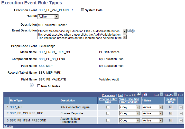

Access the Program Enrollment - Execution Event Rule Types page (select Set Up SACR, then select Product Related, then select Student Records, then select Program Enrollment, then select Execution Event Rule Types).
Image: Program Enrollment - Execution Event Rule Types page
This example illustrates the fields and controls on the Program Enrollment - Execution Event Rule Types page. You can find definitions for the fields and controls later on this page.
Field or Control
Definition
System Data
This check box displays for Execution Event Rule Types definitions delivered by Campus Solutions Development. See further information below.
Status
Campus Solutions Development events are delivered as Inactive. Events must be Active for Rules Engine invocation to occur.
Copy
This button is available only when you add a new execution event. The copy feature provides a prompt against all execution events defined in the system, including those for which the System Data check box is selected. (see below).
Delete
When an execution event is saved successfully, a Delete button is available (Delete is not available for execution events for which the System Data check box is selected).
PeopleCode Event
Select a value: Field Change, Field Edit, Save Edit, or Save Pre-Change. The event selected here documents where the trigger PeopleCode that invokes the Rules Engine is called from by the component processor. In most cases, and specifically for the delivered self-service execution events, the PeopleCode event is Field Change.
Menu Name, Component Name, Page Name and Field Name
These fields are used to document the actual page/field location where the execution event occurs.
Run All Rules
When this check box is deselected, rule execution stops when the first error is encountered. For example, if a student adds three courses to their planner in self-service and each of those courses has a Course Requisite rule attached to them, and the student fails the first requisite, an error is returned for the first requisite but the other two requisite rules are not checked. If the Run All Rules check box is selected, all three rules are executed.
Rule Types Grid
Use this grid to indicate which types of rules should be executed when the triggering event occurs.

Delivered Execution Event Type Definitions
The following Execution Event Rule Type definitions are delivered. These events are tied specifically to the My Education Plan and Scheduler Builder components to enable invocation of both Rules Engine based rules and the AIR Connector Engine.
See the Using the Rules Engine for Program Enrollment Student Self-Service: System/Example Data document in My Oracle Support (ID 1400723.1).
Note: The trigger code for these execution events has been added only for the PeopleCode events specified in the definition (FieldChange).
  • SSR_PE_UPD_PLANNER - My Education Plan Update Planner
    If active, this event executes when a user clicks the Update Planner button on the student self-service My Education Plan component. The Update Planner button saves any course selection if all validation (including Rules Engine validation) logic is satisfied. Only those rule types with a status of Active are executed. The following rule types are tied to this event:
    • SSR_PE_COURSE_REQ - Course Requisite
    • SSR_PE_ITEM_PRECOND - Academic Item Precondition
  • SSR_PE_VAL_PLANNER - My Education Plan Validate Planner
    If active, this event executes when a user clicks the Audit/Validate button on the student self-service My Education Plan component. The validation process acts on the Planning node selected in the component. All rules for the planning node and its child items are invoked if they are of a rule type that is valid for this event. Only rule types with an Active status are executed. The following rule types are tied to this event:
