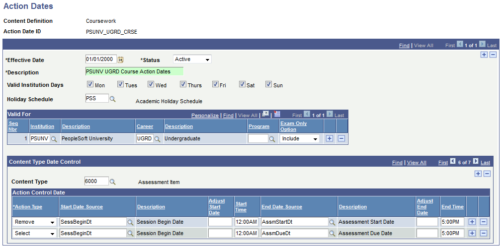

  • Define action dates.

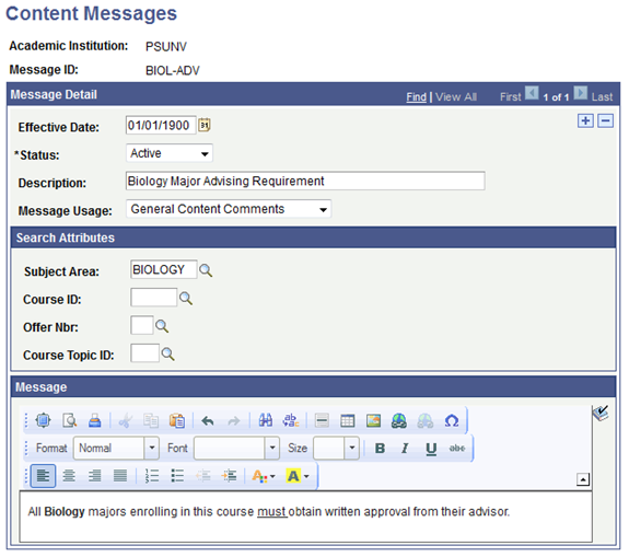

Content Messages
SSR_AC_MESSAGES
select Curriculum Management, then select Activity Management, then select Setup, then select Content Messages
Set up messaging that is used in activity management.

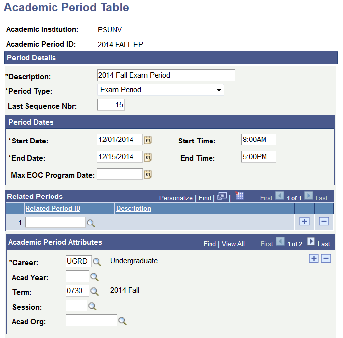

Academic Period Table
SSR_PERIOD_TBL
select Set Up SACR, then select Foundation Tables, then select Term Setup, then select Academic Periods
Set up academic periods used as part of activity management.

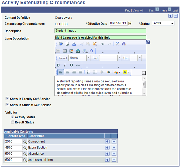

Activity Extenuating Circumstances
SSR_AC_ITEMTYPE
select Curriculum Management, then select Activity Management, then select Setup, then select Extenuating Circumstances
Define reason codes specific to an activity or a result.

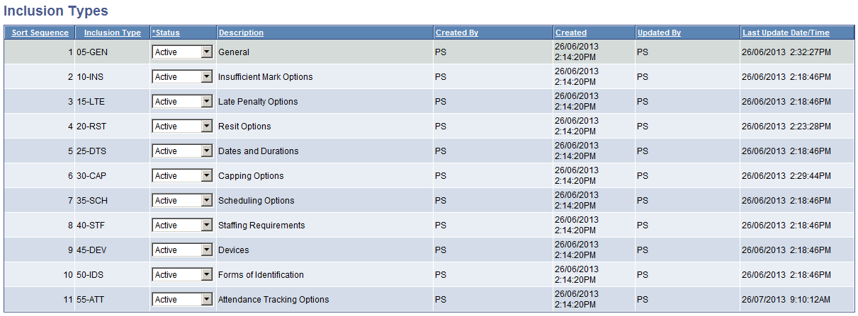

Inclusion Types
SSR_AC_INCLTYPE
select Curriculum Management, then select Activity Management, then select Setup, then select Inclusion Types
Activate inclusion types to be used in the Activity Definition.

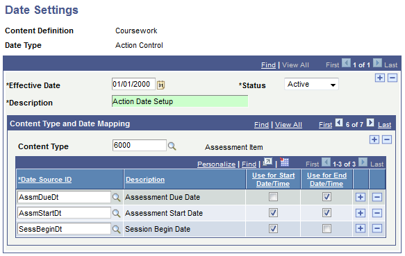

Date Settings
SSR_ADC_MAPPNG
select Curriculum Management, then select Activity Management, then select Setup, then select Date Settings
Set date sources for actions and results.
Action Dates
SSR_ADC_ACTN_CTRL
select Curriculum Management, then select Activity Management, then select Setup, then select Action Dates
Set parameters for when students can select optional activities.

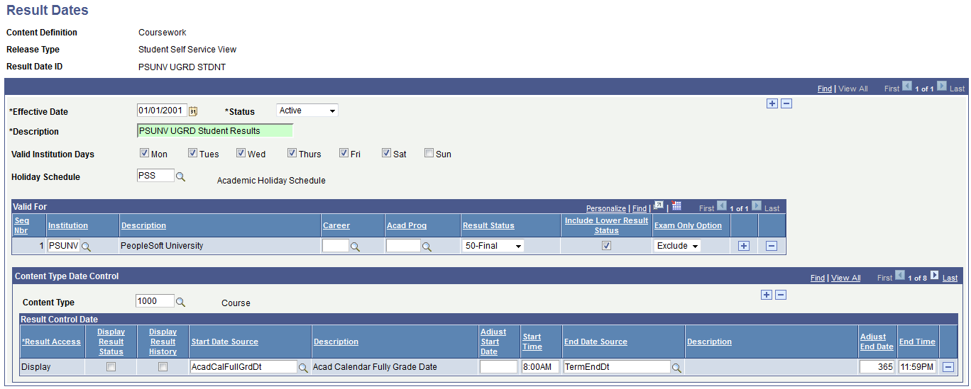

Result Dates
SSR_ADC_RSLT_CTRL
select Curriculum Management, then select Activity Management, then select Setup, then select Result Dates
Set parameters for when instructional staff can grade activities.

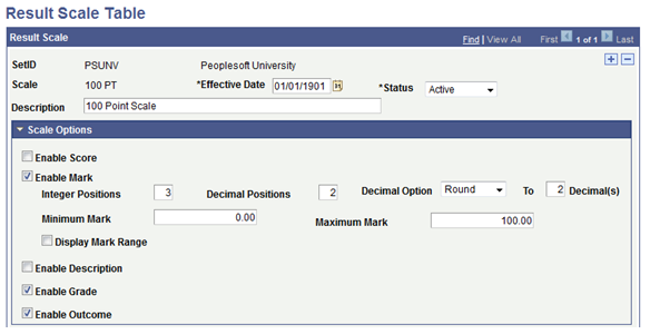

Access the Result Scale Table page (select Set Up SACR, then select Product Related, then select Student Records, then select Grading, then select Result Scale).
Image: Result Scale Table page (1 of 2)
This example illustrates the fields and controls on the Result Scale Table page (1 of 2). You can find definitions for the fields and controls later on this page.
Image: Result Scale Table page (2 of 2)
This example illustrates the fields and controls on the Result Scale Table page (2 of 2). You can find definitions for the fields and controls later on this page.
On this page you establish how scores and marks map to grades and outcomes. If using program enrollment, users can define which of these fields, calculated at the activity level, they want to update to a student's Academic Progress Tracker (APT). The Grade In/Official value can also populate the Student Enroll record (STDNT_ENRL), in much the same way as the system currently does in the Student Records core grading process. A Result Scale can be established at the Academic Institution, Career, or Organization level and can be applied automatically to course activity registries.
Scale Options
The options you select in this group box determine the appearance of the Scales group box below.
Field or Control
Definition
Enable Score
Select this check box to display the Score column below, and define the field as either Character or Numeric. If you enable the Score column, users can enter a value that can be translated to a Mark. This check box is cleared by default. The score is an optional result field that can be used to map a value that is not used in calculation to a mark that is used in calculation.
Score Value Field Type
This field appears when you select the Enable Score check box. Specify whether the free-form Score is entered as a Character or Numeric value.
Integer Positions, Decimal Positions
These fields appear when the Score Value Field Type is Numeric. Specify the position that the integer and decimal fields can use.
Enable Mark
Select this check box to display the Mark column below. Marks are required for those scales where result values require calculation. This check box is selected by default.
These fields appear when the Enable Mark check box is selected. Specify the position the integer and decimal fields can use. The default value is 0; you must define the position values.
Decimal Option, To __ Decimals
Indicate how to round or truncate the decimal position for an entered or calculated mark on a student's record.
Minimum Mark, Maximum Mark
These fields appear when the Enable Mark check box is selected. Together, they indicate the numerical range of the scale; that range is used to validate entered marks against a student's record. During the grading process if an entered mark falls outside the range of these minimum and maximum values, the user receives an error.
Display Mark Range
This field appears when the Enable Mark check box is selected. Select the check box to allow users to view the upper end of the range for each mark entered. The upper end of the range appears in the Maximum Mark column of the Scale grid below. This check box is cleared by default.
Enable Description
Select this check box to display the Score/Mark Description column below. This check box is cleared by default.
Enable Grade
Select this check box to display the Grade and Grade Description columns below. If you select this check box, the Grading Scheme and Grading Basis fields also appear. This check box is selected by default.
Note: Currently, to enter results on the Individual Activity Manager (IAM) a result scale must possess a student's enrollment grading scheme/grade basis.
Enable Outcome
Select this check box to display the Outcome column below, where you can define the outcome of a score/mark/grade combination. This check box is selected by default.

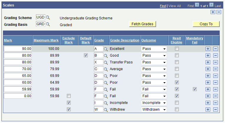

Scales
Field or Control
Definition
Grading Scheme
Identify the grading scheme from which the grade basis and grade are mapped. A result scale can have multiple grading schemes and grade bases, but the course to which the result ID is associated must have one of the grading scheme and grade bases combinations defined here.
Grading Basis
Identify the grade basis from which the grade is mapped.
Fetch Grades
You can click this button after a grading scheme and basis have been entered. The system displays all grades defined on the grade table for the given grading scheme and grading basis. The system then displays a message when grades are fetched and displays them here.
Note that you can delete any grade from the scale after the fetch process is complete.
Copy From
You can click this button if the Enable Grade check box is selected. To use Copy From, a previously saved scale within this result scale must exist. To execute the copy, insert a new row; enter the Grading Scheme and Grading Basis, then select Copy From.
Copy To
You can click this button if the Enable Grade check box is selected and a previously saved scale exists.
Score
This column appears if the Enable Score check box is selected above. Use this field if the initial result provided to the student differs from the corresponding mark or grade field. The value entered here maps to the specific mark value.
If you use this column, the Display Mark Range and Maximum Mark fields are disabled.
Mark
This column appears if the Enable Mark check box is selected above. The system maps marks in one of two ways:
  • If you enter a score here, the system maps it directly to a mark and disables the Display Mark Range and Maximum Mark fields.
  • If you do not enter a score, the system treats the mark as a range. The value entered here becomes the lowest value of the range used by the system to map to a grade and outcome. For example, the system grants an A grade for students receiving any mark from 90.00 to 97.99. A student receiving a 98.00 to 100.00 receives an A+.
Use this field, in combination with the Maximum Mark field, to indicate the range of each row.
Maximum Mark
This column appears if the Display Mark Range check box is selected above. Use this field, in combination with the Mark field, to show the full range of a specific row. The value that appears here is derived from the actual values entered in the Mark column.
Exclude Mark
This check box appears when the Mark value of a row is zero (0.00). Select this check box when a mark should not be used in a calculation.
Rows containing grade outcomes such as Incomplete and Withdrawn are the most likely candidates to be excluded.
Default Mark
This check box appears when there is duplication in the Mark column. When duplication occurs, select which mark the system should use for calculation purposes.
In the above example, a student who earns a mark between 60.00 and 69.99 receives a grade of D / Poor by default; faculty and administrative users have the ability to override and change the grade to P / Pass or X / Transfer Pass where necessary for individual students.
Grade
The values in this column are retrieved from the Grade Table when you select the Fetch button; you can also enter them manually. You can delete any fetched grade values.
Outcome
Select Passed, Failed, Withdrawn, Audit, or Incomplete.
The Outcome (SSR_RESULTS_STATUS ) is populated based on the following logic when the grade field is populated:
  1. Grades with In Progress Grade flag = Y tagged as Incomplete.
  2. Grades with Earn Credit flag = Y and Grade Points > 0, tagged as Passed.
  3. Any Convert To grade pointing to a grade identified in step 2, tagged as Passed.
  4. Any grade <=> steps 1, 2 or 3 and Include in GPA = Y, tagged as Failed.
  5. Any Convert To grade pointing to a grade identified in step 4, tagged as Failed.
  6. Any grades <=> 1, 2, 3, 4 or 5 left blank.
Note: Any values added to SSR_RESULTS_STATUS must also be set up on SSR_IAM_OUTCOME.
Resit Eligible
Indicate which mark, grade, and outcome combinations are eligible for reassessment. This field works in conjunction with the Resit Inclusion defined on the Activity Registry page and maintained on the Activity Manager page.
Mandatory Fail
This feature is used with the Mandatory Pass feature set up in the Activity Registry or the Activity Manager. It allows schools to indicate that if a particular activity of a course is failed, then the student fails the overall course. If an activity is noted as a Mandatory Pass and the student fails it, the system populates the mark indicated here as the Mandatory Fail result on the course result.
In the example above—a student who fails an activity required as Mandatory Pass—the system inserts a course result row with a mark of 59.99, the grade of F, and the outcome of Fail. Any mark/grade/outcome combination can be set as the Mandatory Fail row. Another common setting for this the result row may be 0.00 / F / Fail.
Access the Content Messages page (select Curriculum Management, then select Activity Management, then select Setup, then select Content Messages).
Image: Content Messages page
This example illustrates the fields and controls on the Content Messages page. You can find definitions for the fields and controls later on this page.
Content messages that you create here can be used within the activity registry. You can also enter free-form messages directly into the activity registry. Content messages are created as either General Content Comments or Staff Instructions. General content comments are directives for students and staff and are associated with content types in the activity. Staff instructions are associated with examination staff in the activity registry. Staff instructions are only visible to staff members assigned to a given exam.
Field or Control
Definition
Message Usage
Select either General Content Comments or Staff Instructions. General content comments are prompted as content notes in the activity registry for each content type. Staff instructions are prompted as administrative instructions in the Staffing Requirements section in the activity registry for exam content types.
Subject Area, Course ID, Offer Nbr (number), Course Topic ID
These fields serve as search filters in the activity registry and activity manager for content notes and administrative instructions. Add subject, course ID, offering number, or course topic to aid in searching on the activity registry or activity manager.
Message
Enter text here to populate the Message ID prompt in content notes or administrative instructions (based on message usage) in the activity registry.
Access the Academic Period Table page (select Set Up SACR, then select Foundation Tables, then select Term Setup, then select Academic Periods).
Image: Academic Period table page
This example illustrates the fields and controls on the Academic Period table page. You can find definitions for the fields and controls later on this page.
Academic periods are institutionally defined time periods that can be created to support exams in Activity Management. The Period Type of Exam Period is delivered for this purpose. Exam periods will be associated with exams in the Activity Generator, Activity Manager, and the Section Manager. The Program Enrollment feature also utilizes Academic Periods but with a different Period Type.
Field or Control
Definition
Period Type
Select Exam Period for Activity Management. Additional period types are delivered with Program Enrollment.
This field indicates the type of academic period. When the Period Type is Exam Period, the Academic Period Attributes section becomes available.
Last Section Number
This field indicates the most recent section number associated with an exam section in the Section Manager.
Start Date
The beginning date of the academic period being defined.
Start Time
The beginning time of the academic period being defined.
End Date
The final date of the academic period being defined.
End Time
The final time of the academic period being defined.
Max EOC Program Date (maximum exam only course program date)
The maximum date that an Exam Only Course (EOC) can be created. If this field is left as null then start date is used as the maximum EOC program date.
Related Period ID
For future use.
Career
Enter the career(s) for which this academic period is applicable. When associating an exam period with a course exam, the career entered here must match the career associated with the course.
Academic Year
For future use. This attribute is used at a later date to associate an academic period with an academic year.
Term
Enter a term to associate it with the academic period. This association is used as follows:
  • It controls which academic periods are available to students who are enrolled in a particular term.
  • It is required for schools utilizing both the Exam Only Course and the Program Enrollment features by informing the system into which academic period a student should be enrolled when the enrollment is processed by the IAM Batch Generator.
Session
Enter a session to associate it with the academic period. This association is used as follows: it controls which academic periods are available to students who are enrolled in a particular term/session combination.
Acad Org
For future use. This attribute is used at a later date to restrict processing.

This component allows administrative users to define reason codes specific to an activity, a result, or both. The extenuating circumstance is stored and can be used to drive further processing. For instance, if a student is sick on the day of the exam, users can record this against the exam activity. With future processing the system will know to defer the student’s attempt to a later exam period (Rules Engine would be incorporated into this processing).
Field or Control
Definition
Content Definition
Indicate to which Activity Definition the extenuating circumstance is applicable. Currently for Activity Management the only value is Coursework.
User-defined code to identify the extenuating circumstance.
Long Description
Long description field to explain the extenuating circumstance. In the future, this information can be provided to students and faculty in self service.
Show in Faculty Self Service
Select this check box to display the extenuating circumstances prompt in faculty self service.
Show in Student Self Service
Select this check box to display the chosen extenuating circumstance to students in student self service.
Valid for Activity Status
Indicates whether the extenuating circumstance is applicable to student’s activity status. For example, if the student missed an assignment due to illness this extenuating circumstance can be recorded against the student's assignment activity on the IAM component.
Valid for Result Status
Indicates whether the extenuating circumstance is applicable to student’s result status. For example, if a student sat for an exam but was ill, this extenuating circumstance can be recorded against the exam result to explain a poor result. This would be recorded on the Result Roster component or the IAM Result for an individual student.
Applicable Contents
Indicates to which content types the extenuating circumstance is applicable.
Access the Inclusion Types page (select Curriculum Management, then select Activity Management, then select Setup, then select Inclusion Types).
Image: Inclusion Types page
This example illustrates the fields and controls on the Inclusion Types page. You can find definitions for the fields and controls later on this page.
This page lists the delivered inclusion records available for use in the Activity Management feature. The statuses are delivered with an Active Status. Deactivate any inclusion types that your institution will not use in creating activity management coursework structures.
See Reviewing Content Inclusions

Access the Date Settings page (select Curriculum Management, then select Activity Management, then select Setup, then select Date Settings).
Image: Date Settings page
This example illustrates the fields and controls on the Date Settings page. You can find definitions for the fields and controls later on this page.
Date Settings page
This page is used to define the date sources to be used for each content type of the activity management structure. Date sources are specified as either Action Control or Result Control. Only establish date settings for action control if your school utilizes optional activities. If activities are always defined as mandatory, it is not necessary to define a date setting structure for the action control date type.
Regardless of the date type selected, you will define for each available content type all the applicable start and end date sources to be used. In the above example, one start date and two end dates are identified for the action control for the course content type. When creating Action Date IDs on the Action Date page, the Session Start Date is available for selection as the start date and the Assessment Start Date and Assessment Due Date are available for selection as the end date.
Note: For the date type Action Control, the content type Component is not available for selection. Component selection is based on enrollment and is not available in the activity management structure as an optional activity. However, Course is listed to support Exam Only Course selection, although that feature is not yet functional.
Field or Control
Definition
Content Definition
The delivered content definition value for Activity Management is Coursework.
Date Type
This indicates if the dates listed are for activity actions or activity results. Two date types are delivered: Action Control and Result Control. Action controls are specific to students being able to select optional activities in self service. Result controls are used to display results to students and to open the result roster to instructional staff for grading purposes.
Content Type
Enter a row for each content type for which you enter an action date or an result date.
Date Source ID
Enter the date source ID you use as either a start or end date for the given content type.
Use for Start Date/Time
Select to indicate if the date source is used as a start date source.
Use for End Date/Time
Select to indicate if the date source is used as an end date source.

This component controls when students can perform certain actions for optional content types in self service.
Field or Control
Definition
Content Definition
Activity Action ID
Add a unique identifier when adding a new Action Date ID.
Valid Institution Days
Indicate the valid days of the week to count when using the Adjust Start Date and Adjust End Date fields below.
Holiday Schedule
Indicate which holiday schedule to use when using the Adjust Start Date and Adjust End Date fields below.
Institution
Enter the academic institution to which the Action Date ID applies. A blank value applies to all academic institutions.
Career
Enter the academic career to which the Action Date ID applies. A blank value applies to all academic careers of the institution.
Program
Enter the academic program to which the Action Date ID applies. A blank value applies to all academic programs of the career.
Exam Only Option
(for future use) Three options are available: Include to have the Action Date ID apply to Exam Only Courses, as well as regular courses; Exclude to not have the Action Date ID apply to exam only courses, or Exam Only to have the Action Date ID only apply to exam only courses. If different action dates exist for exam only and non-exam only courses, create different Action Date IDs.
Content Type
Enter a row for each content type for which the Action Date ID applies. You are not able to enter Component as this is not an optional content type.
Action Type
Select all applicable action types for the content type. Select and Remove are applicable actions for all content types. The exam section also has actions of Confirm and Unconfirm. The exam also includes Resit Selection and Resit Remove options.
Start Date Source
Select the appropriate date source. You only see those sources defined for the specific content type that were defined on the Date Setting component as an action control start date source.
Adjust Start Date
Enter the number of days before or after the source date for which the action should be allowed. For instance, if selections can be performed starting three days after the session start date, enter 3.
Use Time from Start Source
Select to automatically use the start time associated with this source date. This field is only visible when the date source is AcadPerStartDttm or AcadPerEndDttm. Set up the academic period start time on the Academic Period Table.
Start Time
Enter a specific time the action should be allowed to start. A blank value default schedules the action to begin at 12:00AM.
End Date Source
Select the appropriate date source. You only see those sources defined for the specific content type that were defined on the Date Setting component as an action control end date source.
Adjust End Date
Enter the number of days before or after the source date for which the action should be ended. For instance, if selections should end one day prior to the assessment start date, enter -1.
Use Time from End Source
Select to automatically use the end time associated with this source date. This field is only visible when the date source is AcadPerStartDttm or AcadPerEndDttm. Set up the academic period end time on the Academic Period Table.
End Time
Enter a specific time the action should end. A blank value ends the action at 11:59PM by default.
Access the Result Dates page (select Curriculum Management, then select Activity Management, then select Setup, then select Result Dates).
Image: Result Dates page — Student View
This example illustrates the fields and controls on the Result Dates page — Student View. You can find definitions for the fields and controls later on this page.
Result Dates page - Student
Image: Result Dates page — Faculty View
This example illustrates the fields and controls on the Result Dates page — Faculty View. You can find definitions for the fields and controls later on this page.
Result Dates page - Faculty
This component controls release of results to students and roster access for instructional staff. Student result dates should be created using the Release Type Student Self Service View, while staff result dates should use the Release Type Faculty Self Service Update.
Field or Control
Definition
Content Definition
Release Type
Two release types are delivered: Student Self Service Update which is designed to only display results, and Faculty Self Service Update which is designed with calculate, grade and display options.
Result Date ID
This is a unique identifier you create when adding a new Result Date ID.
Note: For Exam-Only Courses (EOC), make sure you use a different Result Date ID from the regular courses, and use the academic period as the date source.
Valid Days
Holiday Schedule
The following fields are valid for the Student Self Service View:
Field or Control
Definition
Institution
Enter the academic institution to which the Result Date ID applies. A blank value applies to all academic institutions.
Career
Enter the academic career to which the Result Date ID applies. A blank value applies to all academic careers of the institution.
Program
Enter the academic program to which the Result Date ID applies. A blank value applies to all academic programs of the career.
Result Status
Enter the result status to display for the Result Date ID. A blank value will display all applicable result statuses.
Include Lower Result Status
Select to display the indicated result status and all other result statuses with a lower number. For example, if you select Result Status 10-Calculated and then select this check box, the 07-Imported, 05-Manual, and 00-Undetermined statuses are also displayed.
Exam Only Option
Three options are available: Include to have the Result Date ID apply to Exam Only Courses, as well as regular courses; Exclude to not have the Result Date ID apply to Exam Only Courses, or Exam Only to have the Result Date ID only apply to Exam Only Courses. If different result dates exist for exam only and non-exam only courses, create different Result Date IDs.
The following fields are valid for the Faculty Self Service Update:
Field or Control
Definition
Institution
Organization
Enter the academic organization to which the Result Date ID applies. A blank value applies to all academic organizations of the institution.
Instructor Type
Enter the instructor type to which the Result Date ID applies. The instructor type is associated to instructors on the Meetings tab of the Class Schedule. A blank value applies to all instructor types associated to the class.
Staff Type
Enter the staff type to which the Result Date ID applies. The staff type is associated with exam staff in the Section Manager. A blank value applies to all staff types associated to the exam section.
Exam Only Option
Three options are available: Include to have the Result Date ID apply to exam only courses, as well as regular courses; Exclude to not have the Result Date ID apply to exam only courses, or Exam Only to have the Result Date ID only apply to exam only courses. If different result dates exist for exam only and non-exam only courses, create different Result Date IDs.
Content Type
Enter a row for each content type for which the Result Date ID applies. The following additional system settings must also be in place for results to display: the specified Result Type must be selected to Show in Student Self-Service (Result Type Table) and the activity must be identified as Accessible (Activity Manager).
Result Access
This value defaults to Display when the release type is Student Self Service View.
When using the Faculty Self Service Update release type the values are:
  • Calculate – allows instructional staff to calculate results to parent activities for those activities which were manually entered (grade). This setting controls the calculate function found on the Activity Management WorkCenter Manage Rosters page. The Allow Calculation (WorkCenter) field on the Institution Table, Institution Table 9 page must also be selected for calculations to be enabled in the Activity Management WorkCenter
  • Grade – allows instructional staff to manually enter results onto the result roster found on the Activity Management WorkCenter
  • Display - allows instructional staff to view (no edit) their result rosters prior to the calculate and grading result access start dates or after the calculate and grading result access dates have expired. This also controls when the result roster icon is visible in the Activity Management WorkCenter, Manage Rosters page. Students must also be associated to the activity for the icon to display
Start Date Source
Select the appropriate date source. You only see those sources defined for the specific content type that were defined on the Date Setting component as a result control start date source.
Adjust Start Date
Enter the number of days before or after the source date for which the result action should be allowed. For instance, if results can be viewed starting two days after the assessment item due date, enter 2.
Start Time
End Date Source
Select the appropriate date source. You only see those sources defined for the specific content type that were defined on the Date Setting component as a result control end date source.
Adjust End Date
Enter the number of days before or after the source date for which the action should be ended. For instance, if results can be viewed forever, enter 999.
Select to automatically use the end time associated with this source date. This field is only visible when the date source is AcadPerStartDttm or AcadPerEndDttm. The setup of the academic period end time is done on the Academic Period Table.
End Time
Enter a specific time the action should end. A blank value by default ends the action at 11:59PM.
