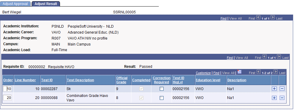

Access the Adjust Result page (select Records and Enrollment, then select Test Administration NLD, then select Adjust Evaluation Results, then select Adjust Result).
Image: Adjust Result page
This example illustrates the fields and controls on the Adjust Result page. You can find definitions for the fields and controls later on this page.
Adjust Result page
Field or Control
Definition
Order
Enter the requisite line number.
Correction Required
Select if the test ID, official grade, or test ID higher level on this line can be replaced by another test ID.
