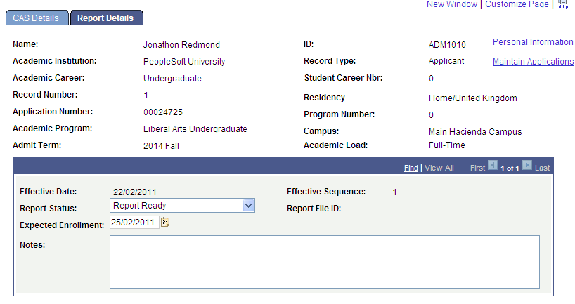

Report Details
SAD_PB_CASREPDTLS
  • select Student Admissions, then select PBI Processing , then select CAS Maintenance, then select Report Details
  • select Student Admissions, then select Application Entry, then select CAS Maintenance
  • select Student Admissions, then select Application Maintenance, then select Maintain Applications, then select Application Program Data, then select CAS Details, then select Report Details
  • select Records and Enrollments, then select Career and Program Information, then select Student Program/Plan, then select Student Program , then select CAS Details, then select Report Details
Enter or update report field values for a CAS Details record at the application or student career level.

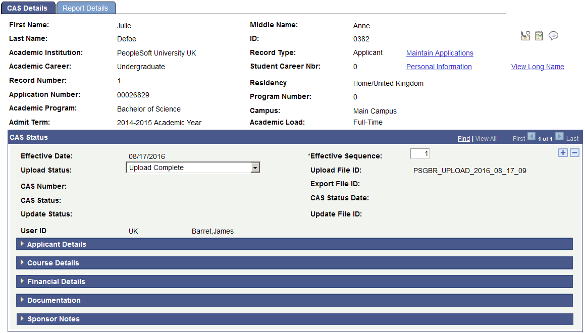

Access the CAS Details page (select Student Admissions, then select PBI Processing, then select CAS Maintenance, then select CAS Details).
Image: CAS Details page
This example illustrates the fields and controls on the CAS Details page. You can find definitions for the fields and controls later on this page.
CAS (Confirmation of Acceptance of Studies) Details page
You can use the CAS Details page to view a CAS record's history of changes throughout its processing cycle. Each history change record has a unique Effective Date and Sequence Number combination.
Field or Control
Definition
First Name, Middle Name, and Last Name
Displays the values from the most recent effective-dated primary name record for the person.
Personal Information
Click to navigate to the Biographical Details page of the Add/Update a Person component.
View Long Name
Click to access the Manage Long Name page.
This link appears only when there is a long names record associated with the primary name record
Upload Status
Identifies whether the record has been identified as:
  • Newly added (New or blank)
  • To be included in the Upload extract (Upload Ready)
  • Included in the Upload extract (Upload Complete)
Once the CAS Number and Status have been imported the system makes this field non-editable.
Upload File ID
Displays the File ID generated when the record is included in the Upload extract.
CAS Number, Export File ID, CAS Status, andCAS Status Date
Displays the values imported using the Import CAS Details process.
The CAS Number field is used to derive the corresponding field in the Update and Report extracts.
Update Status
  • Requiring inclusion in the Update extract (Update Required)
  • To be included in the Update extract (Update Ready)
  • Included in the Update extract (Update Complete)
The system enables this field once the CAS Number and Status has been imported and the CAS Status is Assigned. Once the CAS Status is updated to one of the post-assigned values, for example, Used, the field becomes non-editable.
Once the CAS Status is Assigned, the system will automatically update the Update Status to Update Required when changes are made to the Course Fees Paid, Accommodation Fees Paid or Boarding Fees paid values.
Update File ID
Displays the File ID generated when the record is included in the Update extract. If the record is included in multiple Update extracts the most recent Update File ID is displayed in the current effective date/sequence record.
User ID
Indicates the User ID and name of the user who last updated the record.
If the Create Extract Data or Import CAS Details process updated the record, the User ID field indicates the user who ran the process.

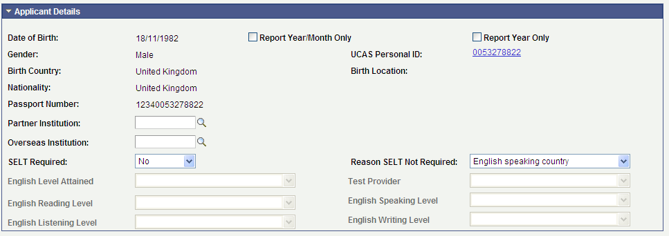

Applicant Details
The following is an example of the Applicant Details region on the CAS Details page.
Image: Applicant Details region – CAS Details page
This example illustrates the fields and controls on the Applicant Details region – CAS Details page. You can find definitions for the fields and controls later on this page.
Applicant Details region – CAS (Confirmation of Acceptance of Studies) Details page
Field or Control
Definition
Report Month/Year Only
Select to include the date of birth in CCYY-MM format in the Upload extract
Report Year Only
Select to include the date of birth in CCYY format in the Upload extract.
UCAS Personal ID
Displays the value imported from UCAS.
The system selects this value from External System ID records with ID type UC or UP. The most recent effective dated record is displayed. The same value is derived for the corresponding field in the Upload extract when the record type is Applicant.
Click the link to navigate to the UCAS Applicant Summary page.
Note: The UTT Personal ID is not included in the CAS Details page. Therefore, the UCAS Personal ID link is not functional for UTT applicants. To access a UTT application, select the Maintain Applications link on the header region of the CAS Details page, and then select the Personal ID link on the Application Program Data page.
Nationality
Displays the country value of the non-EU Citizenship record for the applicant or student.
Select Nationality
Click if you want to change the default value or select a new value for the Nationality field.
If multiple non-EU Citizenship records exist on the Campus Community Citizenship/Passport page, then the record with the lowest country code is displayed by default in the Nationality field and the link is displayed to allow an alternative record to be selected.
Passport Number
Displays the passport number of the record associated with the Citizenship record displayed in the Nationality field.
Select Passport
Click if you want to change the default value or select a new value for the Passport field.
If multiple Passport records exist on the Campus Community Citizenship/Passport page for the selected Nationality , then the passport record with the most recent Issue Date is displayed by default in the Passport Number field and the link is displayed to allow an alternative record to be selected. Passport records with an Expiration Date in the past are not considered.
Partner Institution and Overseas Institution
The system automatically populates this field when a new CAS record is created. The value is populated from the Academic Plan PBI data page if a value is defined for the Academic Plan of the application or student career. If a value is not defined for the Academic Plan, the value is populated from the Academic Program PBI data page if a value is defined for the Academic Program of the application or student career.
Enter an external ID value if the value has not been set up on the Academic Program or Plan PBI data pages or if you want to enter a different value for the applicant or student.
The Overseas Institution prompt is restricted to organizations where the primary location has a country other than GBR.
SELT Required
The system automatically populates this field when a new CAS record is created. The value is populated from (a) Academic Plan PBI Data page, (b) Academic Program PBI Data page, or (c) PBI Configuration page. If default value does not exist at these three levels, then the system sets the field as blank.
Reason SELT Not Required
This field becomes available when the value is No in the SELT Required field.
The value is populated from (a) Academic Plan PBI Data page or (b) Academic Program PBI Data page. If default value does not exist at these two levels, then the system sets the field as blank.
English Level Attained, Test Provider, English Reading Level, English Speaking Level, English Listening Level, and English Writing Level
These fields become available when the value is Yes in the SELT Required field.
Note: Fields related to personal details, such as Date of Birth, Gender, Birth Country and Birth Location, display values from the core person record. This is different from the Nationality and Passport Number fields whose values the system stores in the CAS Details record rather than just display the values from the core person record.

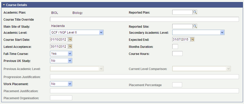

Course Details
The following is an example of the Course Details region on the CAS Details page.
Image: Course Details region – CAS Details page
This example illustrates the fields and controls on the Course Details region – CAS Details page. You can find definitions for the fields and controls later on this page.
Course Details region – CAS (Confirmation of Acceptance of Studies) Details page
Field or Control
Definition
Academic Plan
For record type Applicant, if multiple plans exist in the Application Plan Data record, the field displays the plan code which is alphabetically lowest.
For record type Student, if multiple plans exist in the Student Program/Plan record, the field displays the plan code which has lowest sequence number
Reported Plan
Select an alternative plan if the required value is different to the default value displayed in the Academic Plan field. This value will be used in place of the Academic Plan in deriving values in the Upload extract.
Course Title Override
Enter the course title that the system uses in the Upload extract. The system uses this value in place of the subplan level values or plan level values in the Upload extract.
Main Site of Study
Displays the value defined for your institution from the PBI Configuration page. If no value is defined in the configuration record the field displays the primary Location of the Campus displayed for the applicant or student.
Reported Site
Select an alternative Location if the required value is different to the default value displayed in the Main Site of Study field. This value will be used in place of the Main Site of Study value in deriving the Main Site address fields in the Upload extract.
Academic Level
The system automatically populates this field when a new CAS record is created. The value is populated from HESA Plan Data page if a COURSEAIM value is defined for the Academic Plan of the application or student career.
If a value is not defined for the Academic Plan, the value is populated from the HESA Program Data page if a COURSEAIM value is defined for the Academic Program of the application or student career.
The first letter of the COURSEAIM value is translated to an NQF level as follows: D (doctoral) = 8, M (masters) = 7, H (honours) = 6, I (intermediate) = 5, C (certificate) = 4.
Enter a value if a COURSEAIM value has not been set up on the HESA data pages or if you want to enter a different value for the applicant or student.
Secondary Academic Level
Select a secondary NQF level if required.
NQF values for this field and Academic Level are delivered as translate values with the system (SAD_PB_ACAD_LEVEL). You can define additional translate values for qualification types if required.
Course Start Date
The system automatically populates this field when a new CAS record is created. The value is populated based on the value defined for the Admit Term and Cohort Tag (if defined) from:
  • Academic Plan PBI Data page
  • Academic Program PBI Data page
  • PBI Configuration page
  • For applicants, the term begin date of the Admit Term on the Application Program Data page; for students, the earliest effective date on the Student Program page.
You can override the default value.
Course Start Date must be equal to or greater than the current system date when the Upload Status is set to Upload Ready.
Expected End Date
The system automatically populates this field when a new CAS record is created. The value is populated based on the value defined for the Admit Term and Cohort Tag (if defined) from (a) Academic Plan PBI Data page, (b) Academic Program PBI Data page, (c) PBI Configuration page or (d) the end date of the Expected Graduation Term.
Latest Acceptance Date
The system automatically populates this field when a new CAS record is created. The value is populated based on the value defined for the Admit Term and Cohort Tag (if defined) from (a) Academic Plan PBI Data page, (b) Academic Program PBI Data page or (c) PBI Configuration page. If default value does not exist at these three levels, then the system sets the field as blank.
You can override the default value. The value must be on or after the Course Start Date and on or before the Expected End Date.
Months Duration
The system automatically populates this field when a new CAS record is created. The value is populated from (a) Academic Plan PBI Data page or (b) Academic Program PBI Data page. If default value does not exist at these two levels, then the system sets the field as blank.
You can override the default value by entering a number in the range of 0 and 99.
This field is informational only and is not included in the Upload, Update or Report extract.
Full-Time Course
If the Academic Load field displays Full-Time, the system automatically populates the value Yes when a new CAS record is created.
Course Hours
You can override the default value by entering a decimal value in the range of 0.0 and 168.0.
Previous UK Study
The system automatically populates this field when a new CAS record is created. The value is populated from the PBI Configuration page. If default value does not exist at the configuration level, then the system sets the field as blank.
You can select a different value if required.
Previous Academic Level, Current Level Comparison, and Progression Justification
These three fields become available when the value is Yes in the Previous UK Study field.
Work Placement
The system automatically populates this field when a new CAS record is created. The value is populated from (a) Academic Plan PBI Data page, (b) Academic Program PBI Data page or (c) PBI Configuration page. If default value does not exist at these three levels, then the system sets the field as blank.
Placement Organization
Enter an external ID value if required.
This field becomes available when the value is Yes in the Work Placement field.
Placement Justification
Placement Percentage
Note: For Placement Percentage, Placement Justification and Placement Organisation: If Work Placement defaults to No from the academic plan, then the system skips step (b) for these three fields and values for these fields are not derived from the academic program. In such a case, the value for each of these three fields will either default from (a) academic plan or will be blank to ensure that the default Work Placement details are consistent.

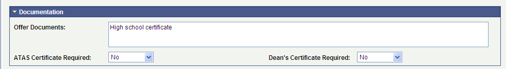

Documentation
The following is an example of the Documentation region on the CAS Details page.
Image: Documentation region – CAS Details page
This example illustrates the fields and controls on the Documentation region – CAS Details page. You can find definitions for the fields and controls later on this page.
Documentation region – CAS (Confirmation of Acceptance of Studies) Details page
Field or Control
Definition
Offer Documents
Enter a value up to a maximum of 2000 characters.
The value is used to derive the DocumentsUsedToObtainOffer field in the Upload extract.
ATAS Certificate Required
Dean's Certificate Required

Access the Report Details page (select Student Admissions, then select PBI Processing, then select CAS Maintenance, then select Report Details).
Image: Report Details page
This example illustrates the fields and controls on the Report Details page . You can find definitions for the fields and controls later on this page.
Report Details page
Field or Control
Definition
Report Status
  • To be included in the Report extract (Report Ready).
  • Included in the Report extract (Report Complete).
You can set report status to Report Ready, only if the CAS Number is populated and the CAS Status of the record is Used.
Report File ID
Displays the File ID generated when the record is included in the Report extract.
Expected Enrollment
You can override the default value. The value must be on or before the Latest Acceptance Date defined on the Course Details region of the CAS Details page.
Notes
The value is used to derive the Notes field for the Report extract.
