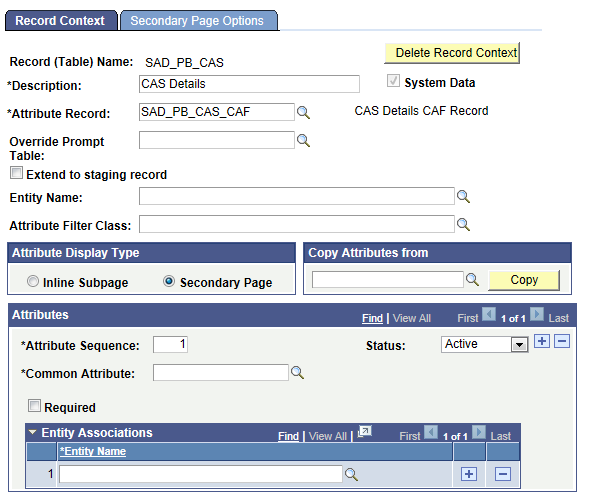

  • Configuring common attributes for PBI.

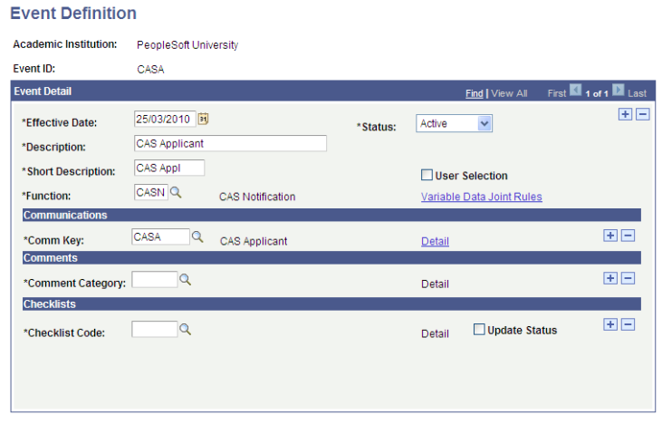

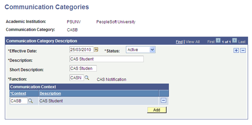

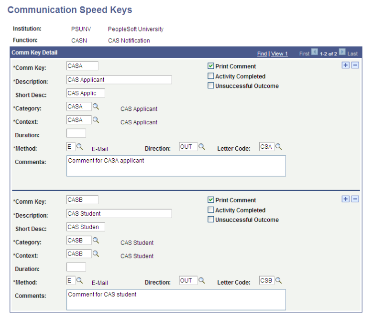

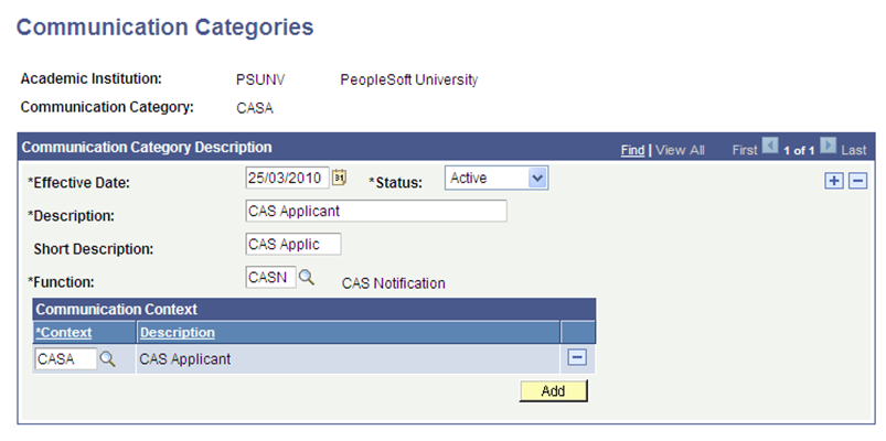

Communication Details
Use this region to set up the event IDs that are used in the communication generation process to notify applicants or students about their CAS number or fee updates.
Field or Control
Definition
Notification Type
Indicate whether you want to notify CAS Number or Fee Update.
Record Type
Indicate whether you want to notify the applicant or student.

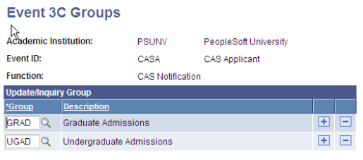

Event ID
Select the event ID that you want the system to assign the applicant or student.
You can select only event IDs defined for the CASN administrative function in Campus Community. The CASN function captures Academic Career, Career Number and CAS Number as variable data. Refer to "Setting Up PBI Communications" in this section for information about the event ID setups.
The system assigns an event ID for CAS Number notification type to a person when the Import CAS Details process loads the CAS number from the inbound XML file for the first time.
For more information about how the process assigns event IDs for CAS Number notification, see Importing CAS Details.
The system assigns an event ID for Fee Update notification type when the Create Extract process creates the update extract data.
You can create one or more communication records using the Communication Generation process to notify applicants or students about their CAS number or fee updates.

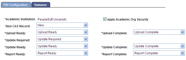

Access the Statuses page (select Student Admissions, then select PBI Processing, then select PBI Configuration, then select Statuses).
Image: Statuses page
This example illustrates the fields and controls on the Statuses page. You can find definitions for the fields and controls later on this page.
Statuses page
Field or Control
Definition
Apply Academic Org Security (apply academic organization security)
Select to have the Create Extract process choose only that CAS record for which the user ID has access to at least one academic organization.
Clear this check box if you want the process to choose a CAS record regardless of whether the user ID has access to the related academic organization.
Refer to the following "Applying Academic Organization Security to the Create Extract Process" topic for more information about this setup.
New CAS Record
Choose an Upload status value that the system assigns to new CAS records. If you do not choose a value, the system assigns a blank Upload status.
Upload Ready
Choose an Upload status value. The Create Extract Data process uses this value to select CAS records for inclusion in the Upload extract.
Upload Complete
Choose an Upload status value. The Create Extract Data process uses this value to create a new effective dated record to indicate that a CAS record has been included in the Upload extract.
Update Required
Choose an Update status value that the system assigns to CAS records where the CAS number has been imported and a subsequent change is made to one of the fees paid fields.
Update Ready
Choose an Update status value. The Create Extract Data process uses this value to select records for inclusion in the Update extract.
Update Complete
Choose an Update status value. The Create Extract Data process uses this value to create a new effective dated record to indicate that a CAS record has been included in the Update extract.
Report Ready
Choose a Report status value. The user uses this value to indicate that a record is ready to be included in the Report extract. The Create Extract Data process uses this value to select records for inclusion in the Report extract.
Report Complete
Choose a Report status value. The Create Extract Data process uses this value to create a new effective dated record to indicate that a CAS record has been included in the Report extract.
Statuses are delivered as translate values for Upload (SAD_PB_UPLOAD), Update (SAD_PB_UPDATE) and Report (SAD_PB_REPORT). You can amend or add to the translate values as required.
If additional verification steps are required before a CAS record is ready for inclusion in the Upload extract, additional interim statuses can be defined and used to manage individual CAS records. Additional statuses can be defined and used to prevent CAS records from being included in the Upload extract if required.
If a verification step is required between one of the fees paid values being updated and the record being included in the Update extract, different status values can be defined for Update Required and Update Ready. If no verification step is required the same status value for Update Ready can be used for both fields.
Note: To allow records to be retrieved using the single Processing Status search field in the CAS Maintenance component it is recommended that distinct status values are defined for Upload, Update and Extract.
The following is a scenario on how the statuses work where there are verification steps before a CAS record is included in an extract:
  1. Use PeopleTools to create additional status values required. For example: new Upload Statuses of Upload Exclude and Upload Pending and a new Update Status of Update Pending.
  2. Use the Statuses page to define the required values.
  3. Use the CAS Maintenance component to create CAS records. The Upload Status is automatically set to New when you create the records.
  4. Use the CAS Record Update process or CAS Details page to set the Upload Status to Upload Exclude for records that should be excluded from the Upload extract. For example, for a second CAS record for an applicant where the previous CAS record has already been sent and a CAS number requested.
  5. Use the CAS Record Update process or CAS Details page to set the Upload Status to Upload Pending for records where all the details have been entered and the record needs to be verified before it is included in an Upload extract.
  6. Use the CAS Record Update process or CAS Details page to change the Upload Status from Upload Pending to Upload Ready for records that have been verified and are ready to be included in an Upload extract.
  7. Run the Create Extract Data process with the Create Upload option selected. The process picks up only those records that have an Upload Status of Upload Ready.
  8. After including the record data in the extract, the Create Extract Data process sets the Upload Status to Upload Complete and saves the Upload File ID to each CAS record included.
  9. After importing the CAS number, when you update the fees paid details on the CAS Details page, the system automatically sets the Update Status to Update Required.
  10. Use the CAS Record Update process or CAS Details page to set the Update Status to Update Pending for records where the fees paid changes need to be verified before the record is included in an Update extract.
  11. Use the CAS Record Update process or CAS Details page to change the Update Status from Update Pending to Update Ready for records that have been verified and are ready to be included in an Update extract.
  12. Run the Create Extract Data process with the Create Update option selected. The process picks up records that have an Update Status of Update Ready.
  13. After including the record data in the extract, the Create Extract Data process sets the update status to Update Complete.
  14. Use the CAS Record Update process or CAS Details page to set the Report Status to Report Ready for the CAS records where the CAS number has been used and the applicant or student has not enrolled at your institution.
  15. Run the Create Extract Data process with the Create Report option selected. The process picks up only those records that have a Report Status of Report Ready.
  16. After including the record data in the extract, the Create Extract Data process sets the status to Report Complete.

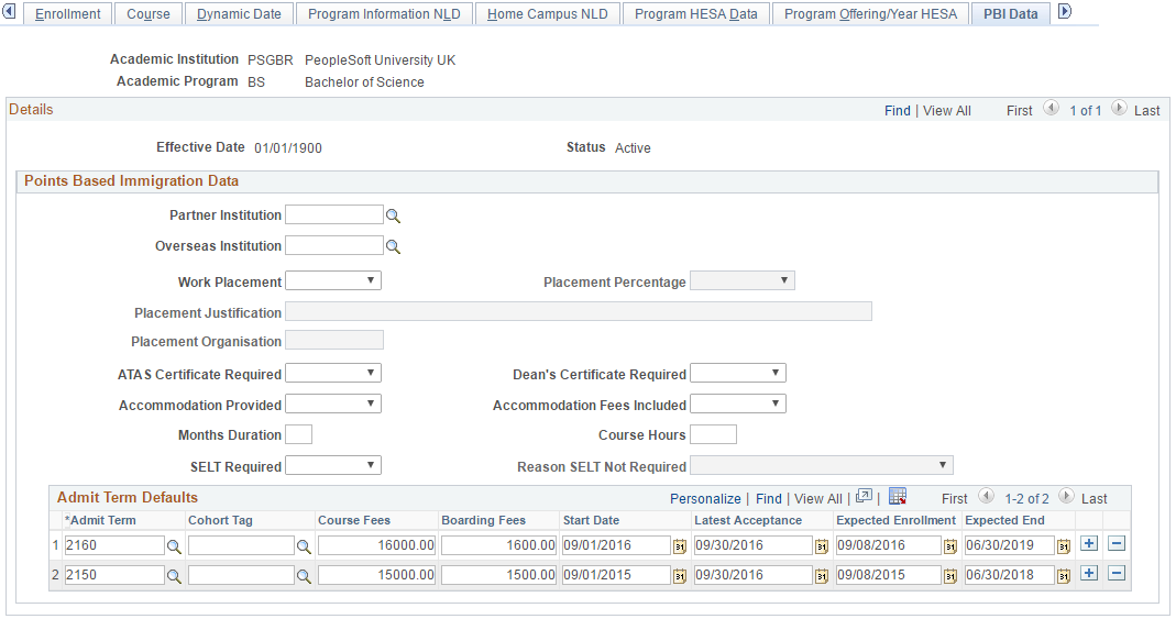

Access the Academic Program PBI Data page (select Set Up SACR, then select Foundation Tables, then select Academic Structure, then select Academic Program Table, then select PBI Data).
Image: Academic Program PBI Data page
This example illustrates the fields and controls on the Academic Program PBI Data page. You can find definitions for the fields and controls later on this page.
Academic Program PBI (Points Based Immigration) Data page
This page appears only if you have selected the PBI check box on the Academic Institution 6 or SA Features page. The values defined are used to populate the corresponding fields in new CAS records if no value is defined for the field at plan level. Values are also used during field derivation.
Field or Control
Definition
Cohort Tag
(Optional) Select the appropriate cohort tag as set up for your institution.
Use this field to allow different dates and fees to be defined for different cohorts within the same Admit Term. The value you set in this field is used by the CAS Details component as well as the processes that are used to add new CAS records to evaluate the default dates and fees for an applicant or student.
The Placement Percentage, Placement Justification, and Placement Organisation fields become available for entry if you select Yes in the Work Placement field. The Reason SELT Not Required field becomes available for entry if you select No in the SELT Required field.
Refer to the PBI Field Derivation documentation for information about derivation of the individual fields.
Access the Academic Plan PBI Data page (select Set Up SACR, then select Foundation Tables, then select Academic Structure, then select Academic Plan Table, then select PBI Data).
Image: Academic Plan PBI Data page
This example illustrates the fields and controls on the Academic Plan PBI Data page.
Academic Plan PBI (Points Based Immigration) Data page
This page appears only if you have selected the PBI check box on the Academic Institution 6 or SA Features page. The values defined are used to populate the corresponding fields in new CAS records. Values are also used during field derivation.
Field or Control
Definition
Cohort Tag

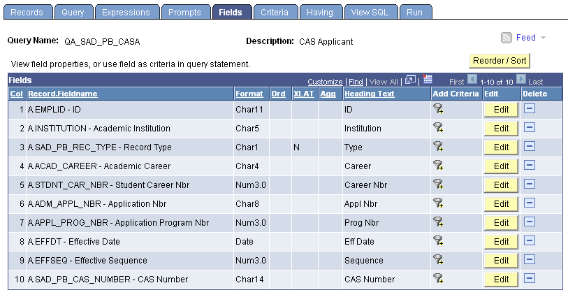

Creating Queries
Access the Query Manager page (select Reporting Tools, then select Query, then select Query Manager).
The PeopleSoft system delivers example queries, one for CAS Number notifications to applicants (QA_SAD_PB_CASA) and one for CAS Number notifications to continuing students (QA_SAD_PB_CASB).
Create your own queries to select all the data you require for your communications. Refer to "Defining Communication Data Sources" in this section for information about data sources.
Each query requires the following:
  • The core record must be included in the query associated with the administrative function. For the CASN function, the CAS Details record (SAD_PB_CAS) must be included.
  • A prompt must be created for the applicant/student ID. The Unique Prompt Name must be changed to Person_ID.
  • Prompts must also be created for the variable data fields relating to the administrative function, ACAD_CAREER, STDNT_CAR_NBR and SAD_PB_CAS_NUMBER.
Image: Fields page for the QA_SAD_PB_CASA query
This example shows the selected fields for the QA_SAD_PB_CASA query.

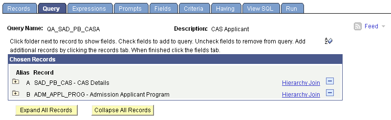

Image: Query page for the QA_SAD_PB_CASA query
This example shows the selected records for the QA_SAD_PB_CASA query.

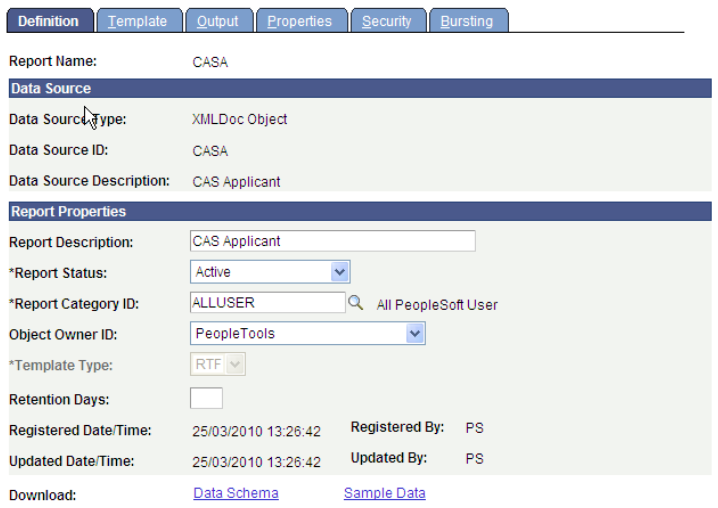

Defining Report Definitions
Access the Definition page (select Reporting Tools, then select BI Publisher, then select Report Definition).
Example templates are delivered that can be used in Report Definitions for CAS Number notifications to applicants (CASA_1) and CAS Number notifications to students (CASB_1). The templates have been created from the XML file downloaded from each Data Source using Oracle BI Publisher.
Create your own template files. There are several possible methods including installing BI Publisher for Word which creates a new menu option in Word. A template can then be created from the XML document downloaded from the Data Source page.
Image: Definition page for CASA
This example shows the Definition page for CASA.
Definition page for CASA (Confirmation of Acceptance of Studies Number notifications to applicants)

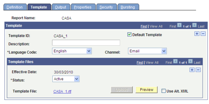

Image: Template page for CASA
This example shows the Template page for CASA.
Template page for CASA (Confirmation of Acceptance of Studies Number notifications to applicants)

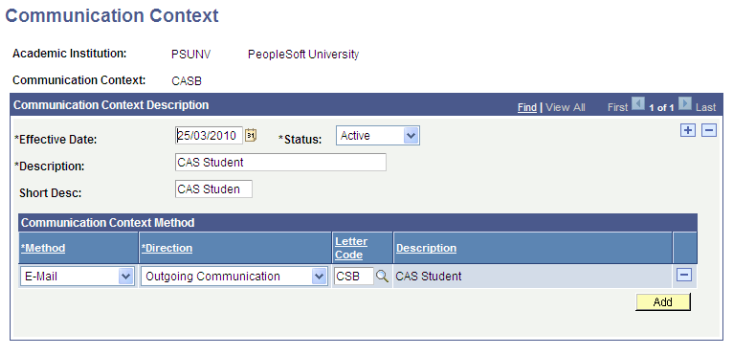

Defining Communication Contexts
Access the Communications Context page (select Campus Community, then select Communications, then select Set up Communications, then select Communications Context Table).
Create communication contexts for applicants and students.
Image: Communications Context page for CASA
This example shows Communications Context page for CASA.
Communications Context page for CASA (Confirmation of Acceptance of Studies Number notifications to applicants)
Image: Communications Context page for CASB
This example shows Communications Context page for CASB.
Communications Context page for CASB (Confirmation of Acceptance of Studies Number notifications to continuing students)
Defining Communication Categories
Access the Communications Category page (select Campus Community, then select Communications, then select Set up Communications, then select Communications Category Table).
Create communication categories for applicants and students using the CASN administrative function and the communication contexts created in the previous step.
Image: Communications Categories page for CASA
This example shows the Communications Categories page for CASA.
Communications Categories page for CASA (Confirmation of Acceptance of Studies Number notifications to applicants)
Image: Communications Categories page for CASB
This example shows the Communications Categories page for CASB.
Communications Categories page for CASB (Confirmation of Acceptance of Studies Number notifications to continuing students)
Defining Communication Speed Keys
Access the Speed Key Table page (select Campus Community, then select Communications, then select Set up Communications, then select Speed Key Table).
Create speed keys for applicants and students using the CASN administrative function and the communication contexts and categories created in the previous steps.
Image: Communications Speed Keys page for CASA and CASB
This example shows the Communications Speed Keys page for CASA and CASB.
Communications Speed Keys page for CASA (Confirmation of Acceptance of Studies Number notifications to applicants) and CASB (Confirmation of Acceptance of Studies Number notifications to continuing students)

Creating Event Definitions
Access the Event Definition page (select Campus Community, then select 3C Engine, then select Set Up 3C Engine, then select Event Definition).
Define events using the CASN administrative function and communication keys defined in previous steps. Additional communications, comments or checklists can be added to the events if required.
Image: Event Definition page for CASA
This example shows the Event Definition page for CASA.
Event Definition page for CASA (Confirmation of Acceptance of Studies Number notifications to applicants)
Image: Event Definition page for CASB
This example shows the Event Definition page for CASB.
Event Definition page for CASB (Confirmation of Acceptance of Studies Number notifications to continuing students)

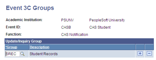

Defining Event 3C Groups
Access the Event 3C Groups page (select Campus Community, then select 3C Engine, then select Set Up 3C Engine, then select Event 3C Groups).
Define the new event IDs for the appropriate Communication 3C Groups for the user depending on your institutions group setup (Set Up SACR, User Defaults, User 3C Group Summary).
Image: Event 3C Groups page for CASA
This example shows the Event 3C Groups page for CASA.
Event 3C (communications, comments, and checklists) Groups page for CASA (Confirmation of Acceptance of Studies Number notifications to applicants)
Image: Event 3C Groups page for CASB
This example shows the Event 3C Groups page for CASB.
Event 3C (communications, comments, and checklists) Groups page for CASB (Confirmation of Acceptance of Studies Number notifications to continuing students)

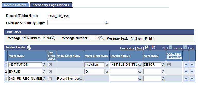

Common Attribute Framework is enabled for the CAS Details page (SAD_PB_CAS) with a delivered record context. You can use this framework to add an additional fields link and secondary page to the CAS Details page. For more information on the CAS Details page, see the next section:
Creating and Maintaining CAS Details
For information on using Common Attribute Framework, refer to the Campus Community — Common Attribute Framework documentation.
See Understanding Common Attribute Framework
Image: Record Context page (Delivered Record Context for SAD_PB_CAS)
This example shows the delivered record context for SAD_PB_CAS.
Record Context page for CAS (Confirmation of Acceptance of Studies) Details page
Image: Secondary Page Options page (Delivered Record Context for SAD_PB_CAS)
Secondary Page Options for CAS (Confirmation of Acceptance of Studies) Details page
When you add a minimum of one attribute to this record context, the Additional Details link will appear on the CAS Details page. Click that link to capture additional data. If no attribute is added to this record context, the CAS Details page will not display the link.
