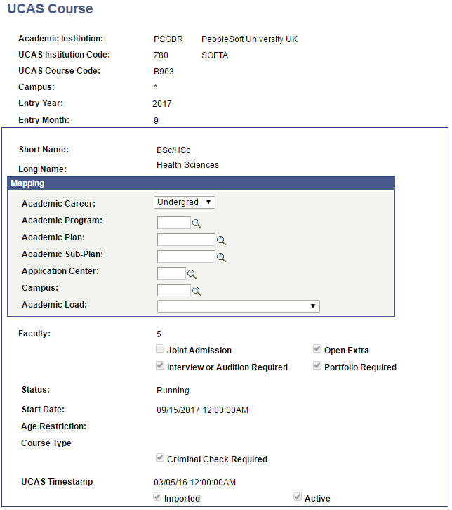

UCAS Courses |
SAD_UC_COURSE |
View the imported cvCourse data or manually enter the UCAS course data into your database. Also, map a UCAS course with a Campus Solutions academic career, program, plan, subplan, application center, and campus. |

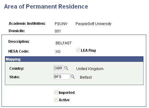

Area of Permanent Residence |
SAD_UC_APR |
View the imported cvRefAPR domicile data or manually enter the APR data into your database. Also, map the UCAS domicile to the Campus Solutions country code. |

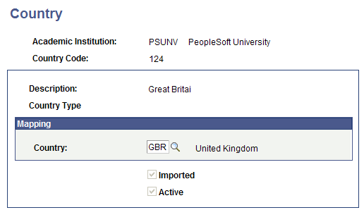

Country |
SAD_UC_CNTRY |
View the imported cvRefCountry data or manually enter the UCAS country data into your database. Also, map the UCAS country code to the Campus Solutions country code. |

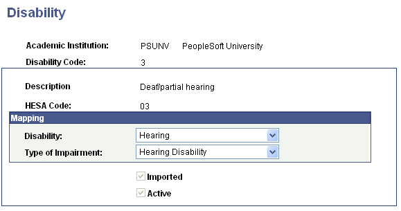

Disability |
SAD_UC_DIS |
View the imported cvRefDis data or manually enter the UCAS disability data into your database. Also, map the UCAS disability code to the Campus Solutions disability code and type of impairment. |

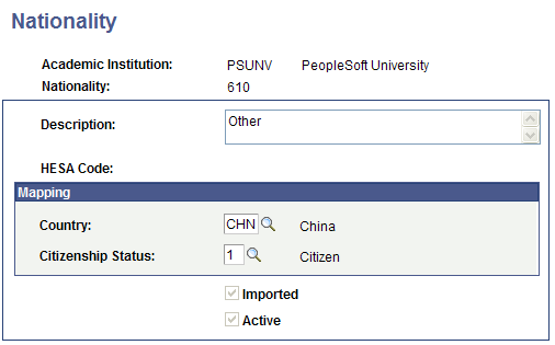

Nationality |
SAD_UC_NATION |
View the imported cvRefNationality data or manually enter the UCAS nationality data into your database. Also, map the UCAS nationality code to the Campus Solutions country and citizenship codes. |

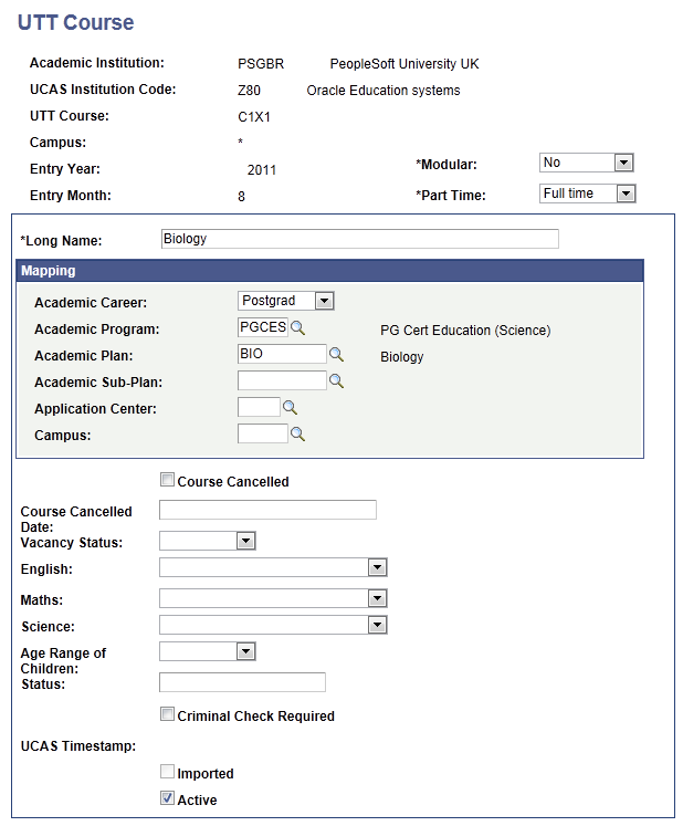

UTT Course |
SAD_UC_GCOURSE |
View the imported cvgCourse data or manually enter the UTT course data into your database. Also, map a UTT course with a Campus Solutions academic career, program, plan, sub-plan, application center, and campus. |

Access the UCAS Course page ().
Image: UCAS Course page
This example illustrates the fields and controls on the UCAS Course page . You can find definitions for the fields and controls later on this page.
Note: If the UCAS Campus value in cvCourse is null (that is, the institution does not have separate UCAS campus codes), then the Import Reference Data process imports the value as *. If you are adding course records manually, you need to add either a valid UCAS campus value or *.

Definition |
| UCAS Timestamp |
Displays the date and time when UCAS updated the cvCourse view. This field is read-only and only appears for imported records. For manually added records, this field is blank and you do not need to enter a value. |
Mapping
You must map a Campus Solutions academic career, program, and plan for each combination of UCAS course code, entry year and entry month that may exist in an imported application choice. The remaining fields in the Mapping group box are optional. The system uses the mapped values when creating or updating the Campus Solutions application record related to the UCAS application choice.
If you do not map the Application Center and Campus values on this page, then the system uses the default values defined in the UCAS Application Import page.
Access the UTT Course page ().
Image: UTT Course page
This example illustrates the fields and controls on the UTT Course page. You can find definitions for the fields and controls later on this page.
Note: If the UTT Campus value in cvgCourse is null (that is, the institution does not have separate UTT campus codes), then the Import Reference Data process imports the value as *. If you are adding course records manually, you need to add either a valid UTT campus value or *.
Field or Control |
Definition |
| UCAS Timestamp |
Displays the date and time when UTT updated the cvgCourse view. This field is read-only and only appears for imported records. For manually added records, this field is blank and you do not need to enter a value. |
Mapping
You must map a Campus Solutions academic career, program, and plan for each combination of UTT course code, entry year and entry month that may exist in an imported application choice. The remaining fields in the Mapping group box are optional. The system uses the mapped values when creating or updating the Campus Solutions application record related to the UTT application choice.
If you do not map the Application Center and Campus values on this page, then the system uses the default values defined in the UTT Application Import page.
Access the Area of Permanent Residence page ().
Image: Area of Permanent Residence page
This example illustrates the fields and controls on the Area of Permanent Residence page. You can find definitions for the fields and controls later on this page.
Mapping
In the Country and the State fields, enter the Campus Solutions country and state codes to map to the UCAS domicile code.
Access the Disability page ().
Image: Disability page
This example illustrates the fields and controls on the Disability page. You can find definitions for the fields and controls later on this page.
Mapping
In the Disability and Type of Impairment fields, enter the Campus Solutions disability and type of impairment codes to map to the UCAS disability code.

Access the Country page ().
Image: Country page
This example illustrates the fields and controls on the Country page. You can find definitions for the fields and controls later on this page.
Mapping
In the Country field, enter the Campus Solutions country code to map to the UCAS country code.
Access the Nationality page ().
Image: Nationality page
This example illustrates the fields and controls on the Nationality page. You can find definitions for the fields and controls later on this page.
Mapping
In the Country and Citizenship Status fields, enter the Campus Solutions country and citizenship status codes to map to the UCAS nationality code.
