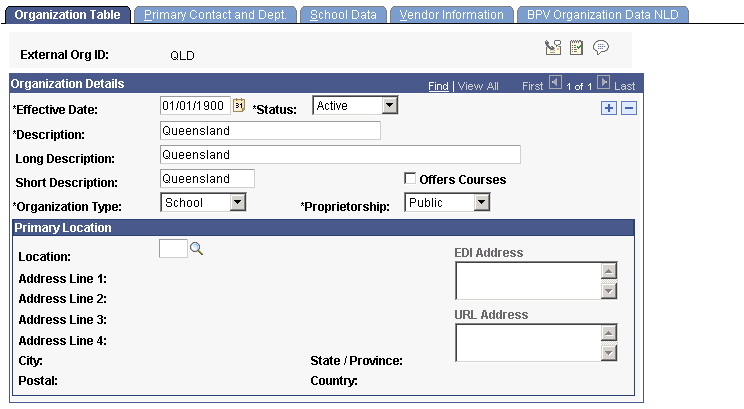

Organization Table
EXT_ORG_TABLE
Campus Community > Organization > Create/Maintain Organizations > Organization Table > Organization Table
Enter external organizations codes into the system for posting applicants' external education data and the last school attended. Education data may include an applicant's qualifications.

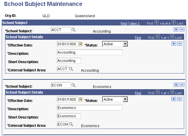

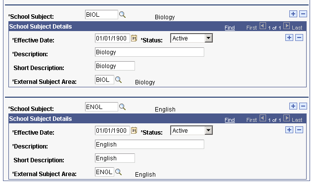

School Subject Maintenance
SCHOOL_SUBJECTS
Campus Community > Organization > Create/Maintain Organizations > School Subject Maintenance
Define academic subjects for the external organizations.

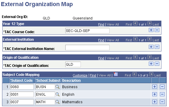

External Organization Map
SAD_TAC_MAP_EXT
Set Up SACR > Product Related > Recruiting and Admissions > TAC > External Organization Map
Map year 12 types, TAC external institutions, origin of qualification values, and subject codes to the external organizations.

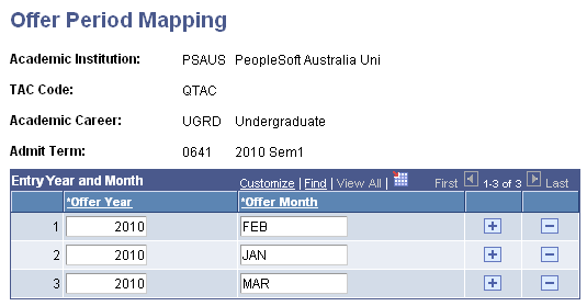

Offer Period Mapping
SAD_TAC_MAP_OFR
Set Up SACR > Product Related > Recruiting and Admissions > TAC > Offer Period Mapping
Map the Offering Month and Year provided in the TAC File to an admit term.

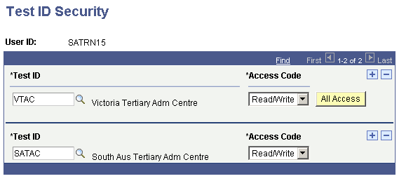

Access the Test ID Security page (Set Up SACR > Security > Secure Student Administration > User ID > Test ID Security).
Image: Test ID Security page
This example illustrates the fields and controls on the Test ID Security page.
Assign the TAC test IDs that a user can access. The system enforces test ID security in several components throughout the system.

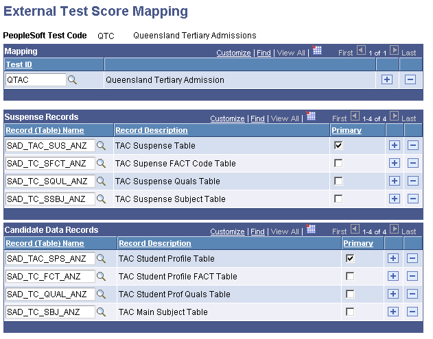

Access the External Test Score Mapping page (Set Up SACR > Product Related > Recruiting and Admissions > External Test Scores > External Test Score Mapping).
Image: External Test Score Mapping page
This example illustrates the fields and controls on the External Test Score Mapping page. You can find definitions for the fields and controls later on this page.
Field or Control
Definition
Test ID
Enter a TAC test ID for each PeopleSoft TAC test code. The PeopleSoft system delivers the following TAC test codes: QTC, VTC, UAC, and STC
Note: On this page, you only have to enter a TAC test ID that corresponds to a PeopleSoft test code. The PeopleSoft system delivers the rest of the page complete. It is important that all TAC test IDs you have defined are mapped to a PeopleSoft test code or you will not be able to load TAC data.

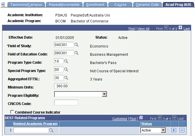

Access the Acad Prog AUS page (Set Up SACR > Foundation Tables > Academic Structure > Academic Program Table > Acad Prog AUS).
Image: Acad Prog AUS (academic program Australia) page (1 of 2)
This example illustrates the fields and controls on the Acad Prog AUS (academic program Australia) page (1 of 2). You can find definitions for the fields and controls later on this page.
Image: Acad Prog AUS (academic program Australia) page (2 of 2)
This example illustrates the fields and controls on the Acad Prog AUS (academic program Australia) page (2 of 2). You can find definitions for the fields and controls later on this page.
Field or Control
Definition
Program Code
Associate a TAC program code with an academic program that your institution offers. TAC program codes can be mapped to only one academic program.
TAC Stream Code
Applicable to only SATAC and VTAC.
Academic Load
Enter the academic load that the TAC Load process assigns to the admission applications for the program.
Academic Plan
Enter the academic plan that the TAC Load process assigns to the admission applications for the program.
Mode of Attendance
Enter the mode of attendance that the TAC Load process assigns to the admission applications for the program.
Campus
Enter the campus that the TAC Load process assigns to the admission applications for the program.

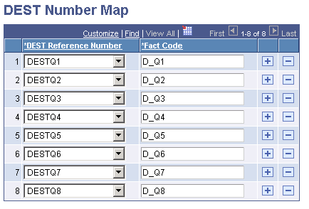

Access the DEST Number Map page (Set Up SACR > Product Related > Recruiting and Admissions > TAC > DEST Number Map).
Image: DEST Number Map page
This example illustrates the fields and controls on the DEST Number Map page. You can find definitions for the fields and controls later on this page.
DEST (Department of Education, Science and Training) Number Map page
DIISRTE - Department of Industry, Innovation, Science, Research and Tertiary - was previously known as DEEWR and before that, as DEST.
For TACs that provide prior education data as FACT codes, associate a FACT code with the applicable DEST Reference Number. The system uses the DEST Reference Number and Fact Code mapping to report highest education attainment so that DIISRTE can track the applicant's prior educational details. The following table lists the DIISRTE (DEST) reference numbers:
DIISRTE Reference Number
Description
1
Post Graduate Program
2
Degree Program
3
Sub Degree Program
4
VET Sub Degree Program
5
VET Award Program
6
VET Secondary Program
7
School Secondary Program
8
Other Program
You can set up FACT codes that are not associated with the applicant's prior education data. In this case, the DEST Reference Number for these FACT codes must be set to Not DEST. The Not DEST mapping setup is optional, and the system uses this setup for its internal processes.
The TAC Load process posts all FACT codes into suspense records. These codes form a part of the candidate data records after the application is posted, regardless of whether the configuration for these codes is maintained on the DEST Number Map page. The system posts the prior education data into the PeopleSoft database only if you have mapped the DEST numbers on the DEST Number Map page.
Note: SATAC provides the prior education data in the applicant file, not the FACT file. Therefore, DEST number mapping is optional for SATAC.
To view the student DEST information after you import the TAC data, select Campus Community > Personal Information > Biographical > Personal Attributes > Student Data AUS.

Access the Organization Table page (Campus Community > Organization > Create/Maintain Organizations > Organization Table > Organization Table).
Image: Organization Table page
This example illustrates the fields and controls on the Organization Table page. You can find definitions for the fields and controls later on this page.
Add external organization codes that represent the applicants' schools. The TAC Load process uses the organization codes to post applicant's external education and last school attended data.
You must add the following organization codes if you want to import VTAC files:
Organization Code
Description
NON VIC SCH
Add this organization code for non-Victorian secondary school qualification records in the VTAC offer file.
If you add this organization code, the TAC Load process assumes the external organization code as NON VIC SCH for qualifications where the School Code is blank.
EXT INSTITN
Add this organization code if you do not want to configure an external organization for each institution that may exist in the overseas qualifications data.
If the TAC Load process does not find a mapping between the TAC External Institution Name and an external organization on the External Organization Map page and you have added EXT INSTITN as an organization code, the process assumes EXT INSTITN as the organization code for the post-secondary level overseas qualifications.
Access the School Subject Maintenance page (Campus Community > Organization > Create/Maintain Organizations > School Subject Maintenance).
Image: School Subject Maintenance page (1 of 2)
This example illustrates the fields and controls on the School Subject Maintenance page (1 of 2).
Image: School Subject Maintenance page (2 of 2)
This example illustrates the fields and controls on the School Subject Maintenance page (2 of 2).
Enter the TAC subject codes and subject code details that you want to associate with each external organization.
Access the External Organization Map page (Set Up SACR > Product Related > Recruiting and Admissions > TAC > External Organization Map).
Image: External Organization Map page
This example illustrates the fields and controls on the External Organization Map page. You can find definitions for the fields and controls later on this page.
Year 12 Type
Enter the valid year 12 course codes for this organization. This data corresponds to the year 12 type in the applicant subject file for QTAC.
Use this field for VTAC when you want to map overseas institution names to a specific external organization ID. VTAC data related to the Overseas Post Secondary Qualifications contain only an overseas institution name; this field allows you to map an overseas institution to an external organization ID.
You must set up an organization ID with a value of EXT INSTITN if you do not want to maintain separate organization IDs for the overseas institutions that may exist in the VTAC overseas qualifications data. If the external institution and external organization ID mapping does not exist, the TAC Load process assigns EXT INSTITN as the external organization ID for the overseas qualifications.
Origin of Qualification
Map origin of qualification values to the external organization. The values that you enter here correspond to the origin of qualification values in the application qualification file for QTAC and UAC.
Subject Code Mapping
Map TAC subject codes to the school subjects of the external organization.

Access the Offer Period Mapping page (Set Up SACR > Product Related > Recruiting and Admissions > TAC > Offer Period Mapping).
Image: Offer Period Mapping page
This example illustrates the fields and controls on the Offer Period Mapping page . You can find definitions for the fields and controls later on this page.
You must have a offer period mapping record for each career and admit term combination.
Field or Control
Definition
Copy from Career
Copy a offer period mapping record of a career. The system displays the Copy from Career field when you enter the page on an add mode.
Offer Year and Offer Month
You must enter all the possible offering year and month combinations that may be provided in a TAC file relevant to the career and admit term.
When a QTAC File is posted, the TAC Search/Match/Post process will assign the admit term according to the offering year and month mapping for the career applicable to the applicant's program. If there is no mapping for the year and month combination, the admit term on the run control will be assigned.
Note: This logic is relevant to only QTAC. For UAC, SATAC and VTAC the system assigns the admit term directly from the TAC load files.
