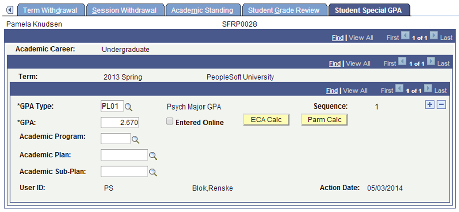

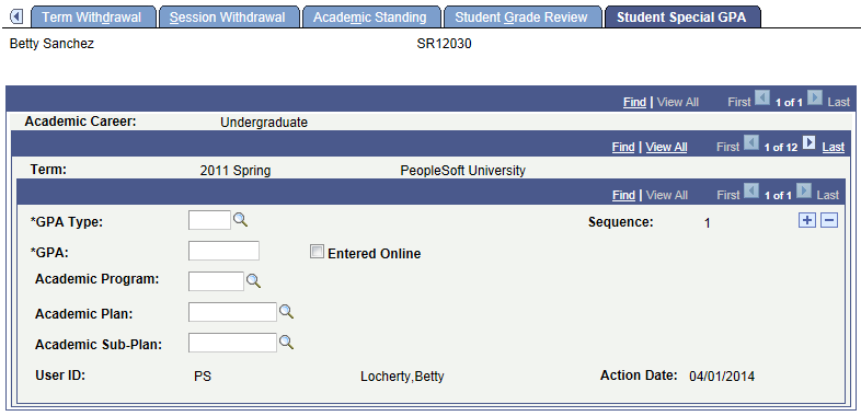

In this example, the Student Grade Inquiry page (Records and Enrollment > Student Term Information > Student Grades) is based on the record view CLASS_TBL_SE_VW, which contains all the information needed for this Rule. Since record tables are not being updated with this Rule, a record view is suitable.
Image: Student Special GPA page before Customization for Rule Engine User Interface Example
This example illustrates the Student Special GPA page before a custom integration with the Rules Engine.

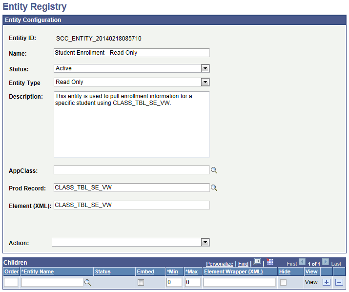

Navigate to the Entity Registry () to find that there is an existing matching Entity, Student Enrollment – Read Only, for record view CLASS_TBL_SE_VW. For this Entity, Entity Type is set to Read Only for Prod Record CLASS_TBL_SE_VW. The Read Only Entity Type does not allow an update or save to be executed by the Rules Engine. The Entity Status is set to Active. No AppClass (application class) is needed for Read Only Entities. The AppClass is reserved for Application Class PeopleCode which controls the save Validation logic for the Entity. Use the Action drop down and select View Hierarchy to view the Entity structure and its properties.
Image: Entity Registry page for Student Enrollment - Read Only for Rules Engine User Interface Example
This example illustrates the Entity Registry page for the Student Enrollment – Read Only Entity.

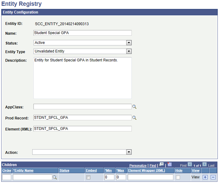

Navigate to the Entity Registry ( ) to find that there is an existing matching Entity, Student Special GPA, for production record STDNT_SPCL_GPA. For this Entity, Entity Type is set to Unvalidated Entity for Prod Record STDNT_SPCL_GPA. The Unvalidated Entity Type allows data to be inserted and updated with no validation. The Entity Status is set to Active. No AppClass (application class) is needed for Unvalidated Entities. The AppClass is reserved for Application Class PeopleCode which controls the save Validation logic for the Entity. Use the Action drop down and select View Hierarchy to view the Entity structure and its properties.
Image: Entity Registry page for Student Special GPA for Rules Engine User Interface Example
This example illustrates the Entity Registry page for the Student Special GPA Entity.

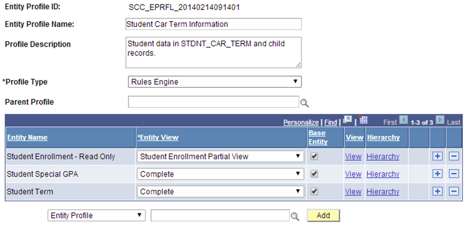

The Entity Profile controls how the Entity can be accessed by selection of a Profile Type. In this example, Rules Engine. The Entity Profile also controls whether the Rule is allowed to use the Entity Structure as a starting point for data access in the Rule. This is controlled by the selecting Base Entity for each Entity Name in the Entity Profile to which you want to have access.
Image: Entity Profile page for Student Car Term Information for Rules Engine User Interface Example
This example illustrates the Entity Profile page for Student Car Term Information for the Rules Engine User Interface Example.

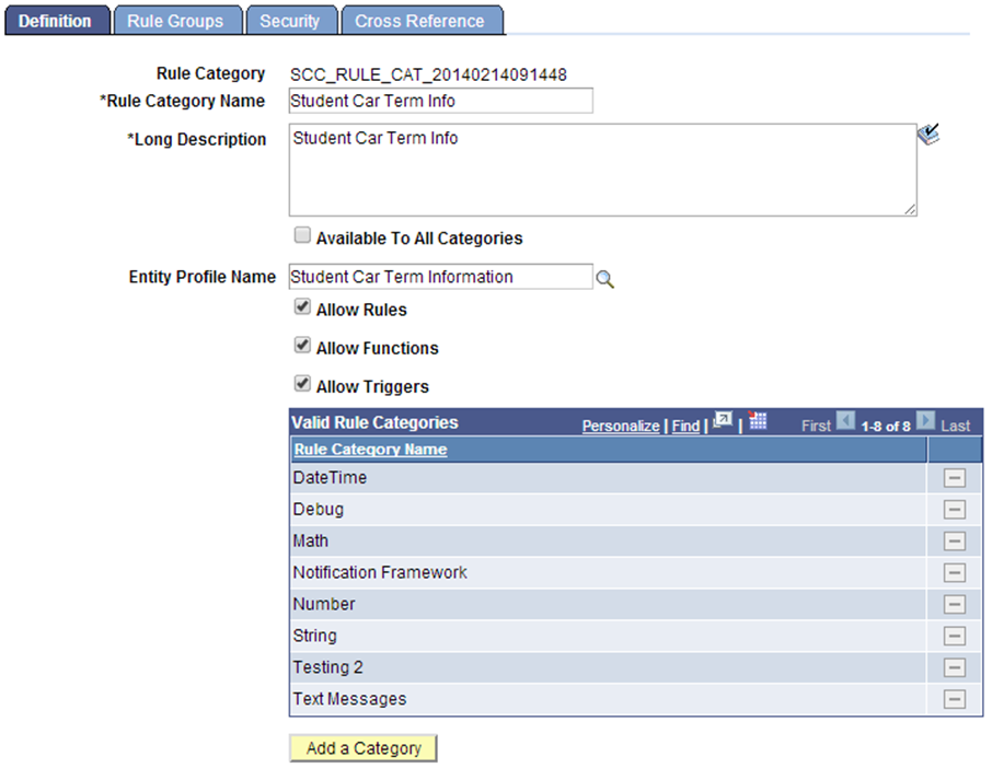

The next part of Entity Security is setup using Rule Category Definition. Here, you can:
Create a Category in which to create the Functional Rule. In this example, we want all Student Car Term related Rules created in one Rule Category.
Grant access to the Entity Profile Student Car Term Information.
Control access to types of Rules. we want to create Functions, Rules and Triggers.
Control which from Valid Rule Categories business logic can be accessed. We are creating a Rule that uses business logic from other Rule Categories; for example, to perform calculations (category Math) .
Control who can create Rules for Student Car Term Information; this may be one or more specified users or all users in associated Role.
Image: Define Categories page for Rules Engine User Interface Integration Example
This example illustrates the Define Categories page for Rules Engine User Interface Integration Example.

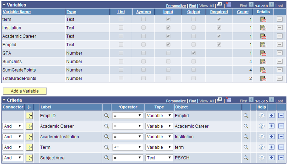

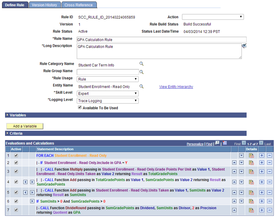

This Functional Rule uses the Student Enrollment – Read Only Entity, created from production record CLASS_TBL_SE_VW. Assumed is the selection of data using the following Criteria:
EmplID
Academic Career
Institution
Term
Subject
Using these Criteria, the Rule returns all Psychology class results for the specified Student ID, Academic Career, Institution and those Academic Terms which are less than or equal to the specified Term. The Criteria need to be passed into this Rule. The needed Values are obtained from Variables designated as required input:
Image: Variables and Criteria for Define Rule Page for Functional Rule for Rules Engine User Interface Example
This example illustrates the Variables and Criteria for Define Rule Page for Functional Rule for Rules Engine User Interface Example.
Test the Rule (select Test Rule from the Action drop down on the Define Rule page) to ensure it is producing the desired results before proceeding with the next step of generating a Trigger to call the Rule.

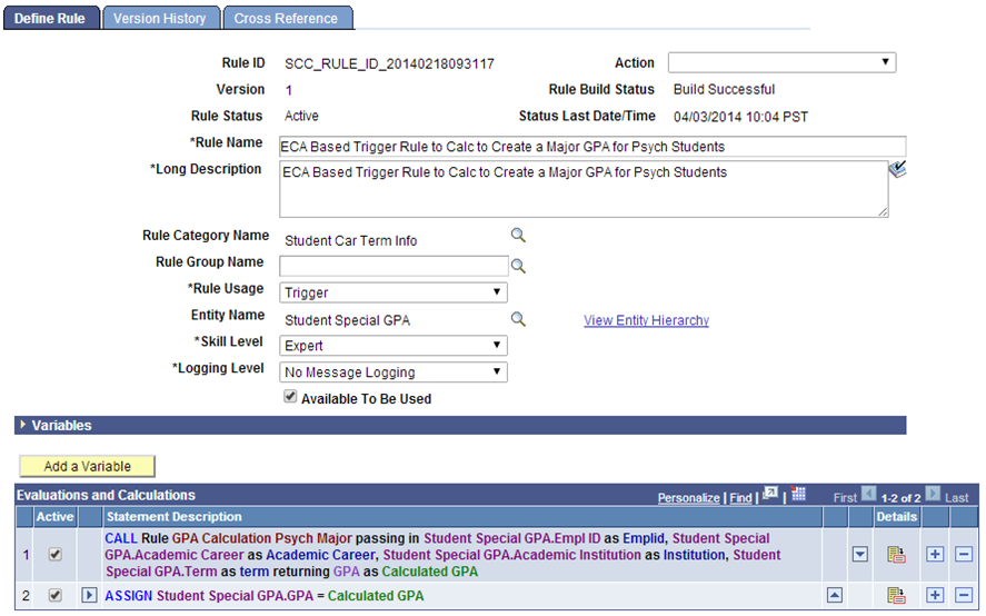

Creating a Trigger Using Method A: Passing an Entity using an Entity
In Method A, the Trigger is defined to work with the Student Special GPA Entity as a Base Entity. The production record for this Base Entity, STDNT_SPCL_GPA, is available on the user interface from which the Trigger is called. The needed information from the Entity can be passed directly to the Trigger. Although the Trigger has no Criteria, the correct Entity is provided to the Trigger.
Image: Define Rule page for Creating Method A Trigger for Rules Engine User Interface Integration Example
This example illustrates the Define Rule page for Creating Method A Trigger for Rules Engine User Interface Integration Example.
This Trigger updates the Student Special GPA Entity with the calculated GPA. This update is displayed on the Special GPA page. This is the Define Call Statement to the GPA Calculation Rule:

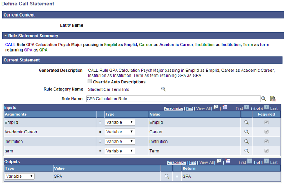

Image: Define Call Statement page for Creating Method A Trigger for Rules Engine User Interface Integration Example
This example illustrates the Define Call Statement page for Creating Method A Trigger for Rules Engine User Interface Integration Example
From the call to the Functional GPA rule, it is apparent that the input values needed are passed in using Entity Properties from Student Special GPA Entity.

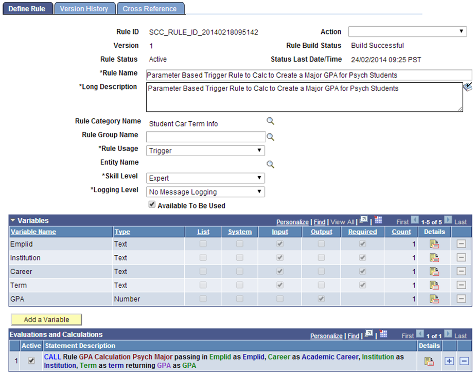

Creating a Trigger Using Method B: Passing Parameters
In Method B, the Trigger is defined to receive all input values as Variables from the user interface. There is no Base Entity as it is not needed to provide the called GPA Functional Rule with the values it needs.
Image: Define Rule page for Creating Method B Trigger for Rules Engine User Interface Integration Example
This example illustrates the Define Rule page for Creating Method B Trigger for Rules Engine User Interface Integration Example
The calculated GPA is passed into a GPA output Variable. The calling PeopleCode event takes this value and updates the GPA on the Special GPA page. This is the Define Call Statement to the GPA Calculation Rule:
Image: Define Call Statement page for Creating Method B Trigger for Rules Engine User Interface Integration Example
This example illustrates the Define Call Statement page for Creating Method B Trigger for Rules Engine User Interface Integration Example.
With a Trigger created, the boilerplate code can be generated and connected it to a Component Event. In this example, the code calls the Rule to calculate the GPA by clicking a button on the Student Special GPA page. The example shows two new buttons added: ECA Calc, representing the Method A approach to the Trigger, and Parm Calc, representing the Method B approach to the Trigger. You would likely only use one approach in the customization of your system and would, therefore, only have one button.
Image: Student Special GPA page after Customization for Rule Engine User Interface Example
This example illustrates the Student Special GPA page after Customization for Rule Engine User Interface Example.

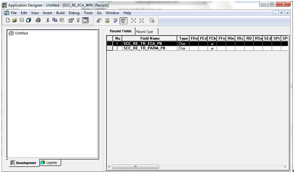

The act of clicking a button is the FieldChange Event to which the PeopleCode should be added to call the Trigger.
Use the Define Rule Triggers page (Set up SACR > System Administration > Rules Engine > Setup > Define Rule Triggers) to generate boilerplate code and attach that code to the Component Event. The setup created here also acts as an administrative reference to Events and associated Rules. You must minimally specify a PeopleCode Event, a Record, and a Field. The following PeopleCode Events can be selected:
FieldChange
FieldEdit
SavePostChange
SavePreChange
You may also add a Component for reference. Once you have the setup, click the Generate Code button to generate the boilerplate PeopleCode. The Generate Code option uses information from the Trigger to create a Code example which can be used to call the Trigger from the Component.

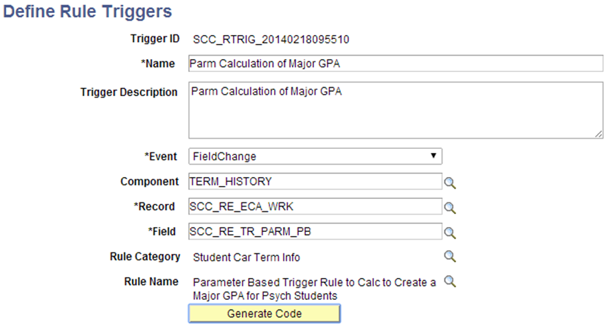

Access the Define Rule Triggers page ().
Image: Define Rule Triggers page for Parm Calc for Rules Engine User Interface Integration Example
This example illustrates the Define Rule Triggers page for Parm Calc for Rules Engine User Interface Integration Example.
Here is the example generated code:

Open the FieldChange event and paste the Generated Code for the ECA Trigger into the appropriate event. Adjust the code to retrieve the correct row from which to select the Entity. This is the adjusted PeopleCode on the FieldChange Event of field SCC_RE_TR_ECA_PB which is the field for the ECA Calc button:

Based on the level 1 row in this example, the Entity can be selected from the current row. References to Variable and Calculated_GPA have been removed from code. As we are using the Rule to update the GPA Entity Property, there is no need to declare or assign a value to the &Calculated_GPA variable in this PeopleCode.
This is the adjusted PeopleCode on the FieldChange Event of field SCC_RE_TR_PARM_PB which is the field for the Parm Calc button:
