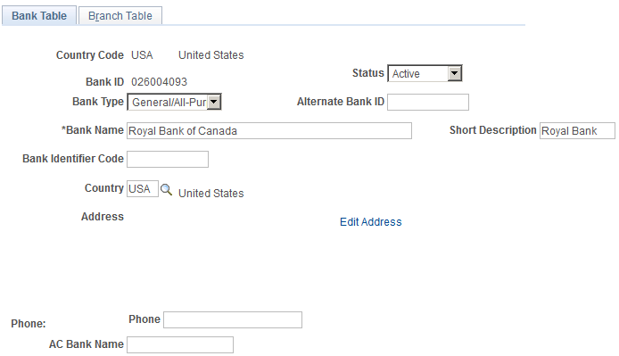

Access the Bank Table page (Set Up Common Objects > Common Definitions > Banking > Banks > Bank Table).
Image: Bank Table
This example illustrates the fields and controls on the Bank Table. You can find definitions for the fields and controls later on this page.
Bank Table
Use this page to set up basic information for all financial institutions.

Bank ID
System-generated. There are different formats for each country. Some are numeric, and others are alphanumeric.
Alternate Bank ID
If applicable, enter the bank's national ID. If the bank participates in an international banking consortium or system, it is given an alternate bank ID that is used in international transactions.
Bank Identifier Code
Enter the Bank Identifier Code (BIC) provided by SWIFT. When saved, the system checks whether this entry is 8 or 11 characters long. The system does not validate the accuracy of the BIC, only its length.

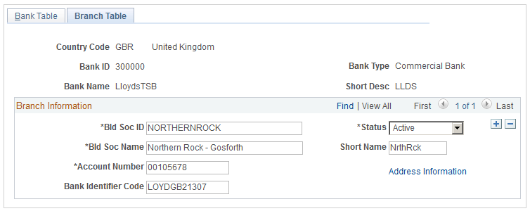

Access the Branch Table page (Set Up Common Objects > Common Definitions > Banking > Banks > Branch Table).
Image: Branch Table
This example illustrates the fields and controls on the Branch Table. You can find definitions for the fields and controls later on this page.
Branch Table page
Not all countries require bank branch information.

(GBR) Special Considerations for the UK
Warning! You must set up a building society on the Branch Table page, linking the society to its clearing bank on the Bank Table page.
In the example page, the building society is linked to LloydsTSB bank (bank ID 30000) that handles clearing for the building society. The building society's clearing account is shown in the Account Number field.
To set up UK building societies, the following information applies.
Field or Control
Definition
Account Number
Enter the number of the building society's account at the clearing bank.
Address Information
Click the Address Information link to access the Building Society Address page. On this page you enter the building society's head office address.
