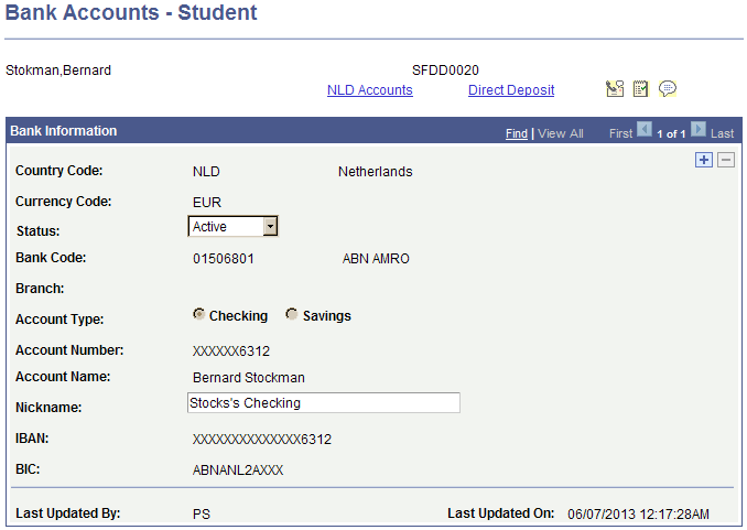

Image: Bank Accounts - Student page
This example illustrates the fields and controls on the Bank Accounts - Student page. You can find definitions for the fields and controls later on this page.

Field or Control |
Definition |
| Country Code |
Select a country code. Otherwise, the default value from the Common Objects component () is retrieved. |
| Currency Code |
Select a currency code. Otherwise, the default value from the Common Objects component () is retrieved. |
| Status |
Displays whether the bank account is active or inactive. By default, it is set to Active. This field is disabled when you are setting up a new bank account. If you want to deactivate a bank account, change its status to Inactive. However, if a bank account is used for direct deposit distribution, this field is disabled and the message “This account is in use.” is displayed. To change the status to Inactive for a bank account used in direct deposit distributions, you must first deactivate the direct deposit distribution. When a bank account is inactive, you can no longer make changes from the Bank Accounts - Student page nor the Self Service page. |
| Routing Number |
Select a routing number. The bank details record in the Common Objects component () controls which values are available. If you provide a BIC Code, this field displays the information derived from the BIC and appears as view-only. |
| Branch |
Select a branch ID. This field appears depending on the country code and routing number. If you provide a BIC Code, this field displays the information derived from the BIC and appears as view-only. |
| Account Type |
Select an account type. By default, Checking is selected. |
| Account Number |
Enter an account number. For security reasons, the account number is masked to show only the last 4 digits after you save the page. The account number is also encrypted and stored in the database. If you provide a value in the IBAN field, this field displays information derived from the IBAN and appears as view-only. |
| Confirm Account Number |
Enter the same value you entered in Account Number. This field is an added security measure and ensures that you provided the correct account number. |
| Check Digit |
This field is available only when the IBAN field is not used. If the IBAN field is used, the value is derived from the IBAN and appears as view-only. |
| Account Name |
Enter the name as it appears on the bank account. |
| Nickname |
(Optional) Enter an alias for the bank account. |
| IBAN and BIC Code |
If you provide the IBAN, you must also provide a BIC Code. Student Financials uses the information on the IBAN Country Setup page () to perform the required validation and prompt for values in the lookups.
For security reasons, only the last four digits of the IBAN appear after you save the page. It is also encrypted and stored in the database. See: |
| Direct Deposit |
This link is available only after you save the page and only if you are authorized to access the Direct Deposit - Student page. Also, the AP Refunding Option must be set to Use Single Payment Voucher on the SF Installation page. Click to access the Direct Deposit - Student page to set up or view direct deposit distributions. |
| NLD Accounts |
This link is available only after you save the page and if you are authorized to access the NLD Student Accounts page. Click to access the NLD Student Accounts page for the student whose bank account you are creating or updating. See: |
| Last Updated By and Last Updated On |
Last Updated By shows the OPRID and Last Updated On shows the date and time that the past was last modified. |
