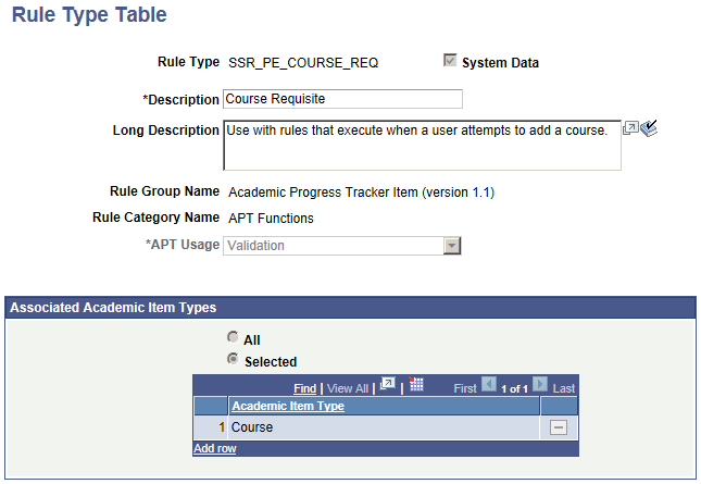

Access the Program Enrollment - Rule Type Table page (Set Up SACR > Product Related > Student Records > Program Enrollment > Rule Type Table).
Image: Program Enrollment - Rule Type Table page
This example illustrates the fields and controls on the Program Enrollment - Rule Type Table page. You can find definitions for the fields and controls later on this page.
Field or Control
Definition
Rule Type and Description
Enter a Rule Type code (20 character limit) and a Description (30 character limit).
System Data
If a rule type is delivered as system data, this check box is selected and is not available for edit.
Rule Group ID, Search, Rule Group Name, and Rule Category Name
A Rule Type must be associated with a single Rule Group. Click the Search button to launch a search using a standard Rules Engine search utility. When you select a Rule Group ID, the Rule Group Name and Rule Category Name are displayed.
APT Usage
Determines how rules of this type relate to an APT Instance. Select from:
  • Validation: Rules of this type can be associated with an Execution Event and can be used to validate APT entries. A Validation rule type must be associated with at least one academic item type.
  • Result Calculation: Rules of this type can be associated with an academic item type on the Result Type component as the default calculation rule for that result type/academic item type combination.
  • APT Status Evaluation: Rules of this type can be associated with an academic item type on the Rule Type table. Academic Item types associated on the rule type table can be used in APT Status Evaluation rules in the APT Administrative Roster.
See Setting Up Result Types.
Copy
This button is available only when you add a new rule type. The copy feature provides a prompt against all rule types defined in the system, including those for which the System Data check box is selected (delivered rule types).
Delete
When a rule type is saved successfully, a Delete button is available. Delete is not available for rule types for which the System Data check box is selected.
Associated Academic Item Types
This grid is available only when the APT Usage value is Validation or Evaluation.
Field or Control
Definition
All
Select this option to indicate that this rule type can be assigned to any academic item regardless of academic item type. Assign rule types to academic items on the Rules / Results page in the Academic Item Registry component.
Note: This option is not available for APT Status Evaluation
Selected
When you select this option, the Academic Item Type field becomes available and you can select the academic item types to which the rule type can be assigned. The Rules / Results page is available in the AIR component only for academic items of the type selected here.
Delivered Rule Types

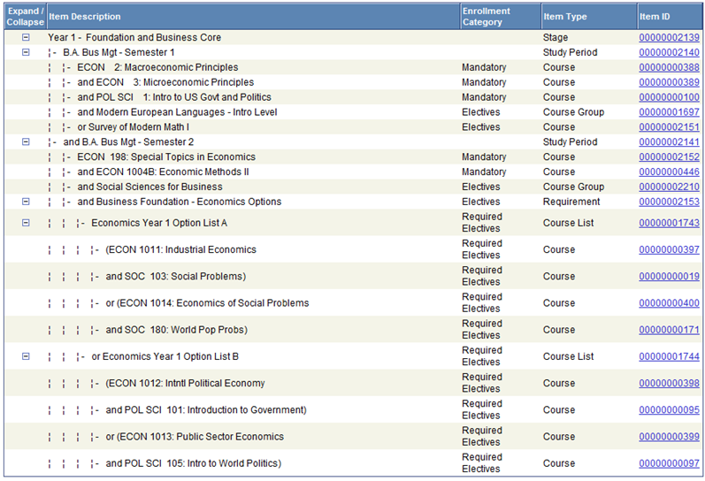

Image: Program Tree Requirements example
The following example shows the program tree requirements for year one of a program. In this particular case, the Item Type Stage is a planning node for this program.
To satisfy the course requirements for Year 1, students must satisfy the course requirements for each Study Period within the year, Semester 1 and Semester 2 as follows:
  • For Semester 1, students must have ECON 2 and ECON 3 and POL SCI 1 and select a course from the Modern Languages Course Group or select Survey of Modern Math.
  • For Semester 2, students must have ECON 198 and ECON 1004B and select a course from the Social Sciences Course Group and satisfy the Business Foundation options requirement.
  • For Business Foundation options, students must select one pair of courses from List A or List B.
  • To satisfy List A or List B student must select a matching pair of courses.
The Air Connector Engine (ACE) process traverses this tree and verifies that each of these requirements – as defined by the AND/OR connectors in AIR – have been met. If all items are not satisfied, an error message is returned.

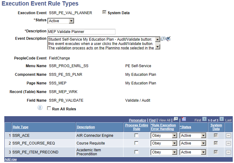

Access the Program Enrollment - Execution Event Rule Types page (Set Up SACR > Product Related > Student Records > Program Enrollment > Execution Event Rule Types).
Image: Program Enrollment - Execution Event Rule Types page
This example illustrates the fields and controls on the Program Enrollment - Execution Event Rule Types page. You can find definitions for the fields and controls later on this page.
Field or Control
Definition
System Data
This check box displays for Execution Event Rule Types definitions delivered by Campus Solutions Development. See further information below.
Status
Campus Solutions Development events are delivered as Inactive. Events must be Active for Rules Engine invocation to occur.
Copy
This button is available only when you add a new execution event. The copy feature provides a prompt against all execution events defined in the system, including those for which the System Data check box is selected. (see below).
Delete
When an execution event is saved successfully, a Delete button is available (Delete is not available for execution events for which the System Data check box is selected).
PeopleCode Event
Select a value: Field Change, Field Edit, Save Edit, or Save Pre-Change. The event selected here documents where the trigger PeopleCode that invokes the Rules Engine is called from by the component processor. In most cases, and specifically for the delivered self-service execution events, the PeopleCode event is Field Change.
Menu Name, Component Name, Page Name and Field Name
These fields are used to document the actual page/field location where the execution event occurs.
Run All Rules
When this check box is deselected, rule execution stops when the first error is encountered. For example, if a student adds three courses to their planner in self-service and each of those courses has a Course Requisite rule attached to them, and the student fails the first requisite, an error is returned for the first requisite but the other two requisite rules are not checked. If the Run All Rules check box is selected, all three rules are executed.
Rule Types Grid
Use this grid to indicate which types of rules should be executed when the triggering event occurs.
Field or Control
Definition
Rule Type
Prompts against the Program Enrollment - Rule Type table.
Process Entire Rule
This check box determines whether the entire rule (of this type) is executed when it is invoked for this event. For example, if a Course Requisite rule requires successful completion of Course A and Course B and the Process Entire Rule check box is selected, the Rules Engine checks to see if both conditions are satisfied and can return the results of both parts of the rule to the User Interface (for example, Course A was not satisfied but Course B was satisfied). Otherwise the Rules Engine executes the rule until the first error condition. Using the same requisite example, processing stops when the Course A component of the rule fails.
Rule Execution Error Handling
Determines whether a rule type is applicable to a certain event and – if it is applicable – whether the user or process can proceed with a task (or system process) if the called rule(s) return errors or failure. Select from:
  • Obey: If error/failure is returned by the called rule, the user cannot proceed; record would not be processed in a batch process.
  • Warn: If error/failure is returned by the rule, the system returns a warning message, but the user/process can continue.
  • N/A (not applicable): Rules of this type are not invoked for this event.
Status
Determines whether a rule type is active for a particular event. If the status is Inactive, rules of this type are not executed.
