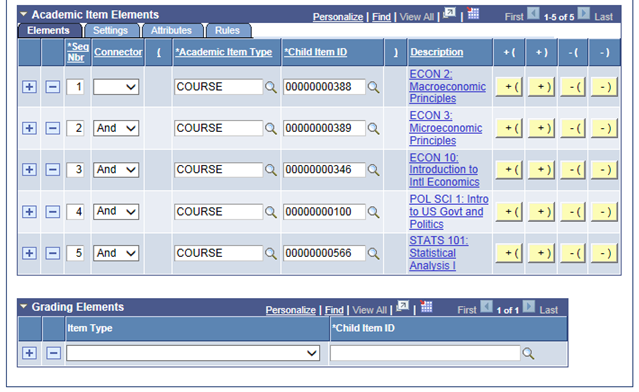

The academic item elements (child academic items) of an academic item must have an effective date that is less than or equal to the item itself. For example, you set up 3 COURSE items with the following effective dates:
  • Course 1: 01/01/1900
  • Course 2: 01/01/2000
  • Course 3: Today’s date
A STUDYPERIOD item with an effective date of 01/01/1900 can use only Course 1 as a child item.
A STUDYPERIOD item with an effective date of today’s date can use all three courses as child items.

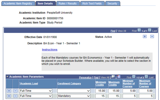

Item Details
SSR_AIR_DTL
Access this page from the AIR Search component.
Define academic item type details
Element Parameters
SSR_AIR_ENPARM_SEC
Click the Element Parameters link on the Item Details page.

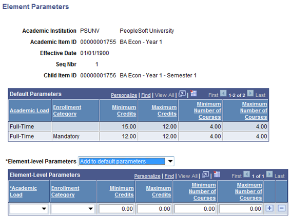

View and update parameters

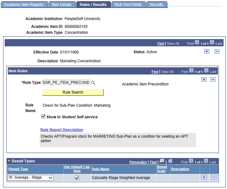

Rules / Results
SSR_AIR_RULE
Assign rules and result types to academic items.

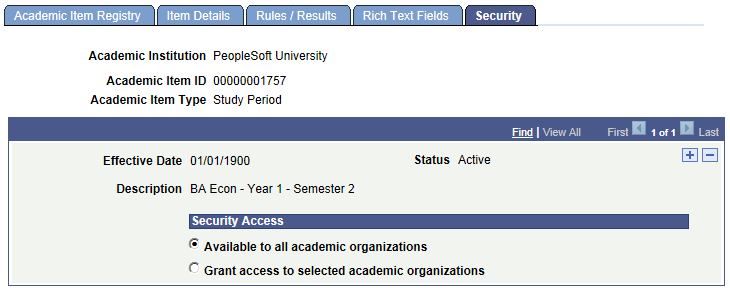

Security
SSR_AIR_SCRTY
Define academic item security.

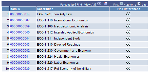

Search Results
Image: Academic Item Registry Search Results example
The system returns a list of academic items matching the search criteria. The results grid can be used to retrieve a selected item in the Academic Item Registry component or to search for references for that item by other academic items.
Field or Control
Definition
Item ID
Click this link to access the Academic Item Registry component.
Find References
Click this icon to access the Find References page of the search component.

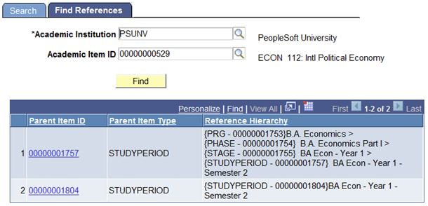

Using the Find References Page
Use the Find References page to find out where a particular academic item ID is being used in the Academic Item Registry.
Image: Academic Item Registry Find References page
This example illustrates the fields and controls on the Academic Item Registry Find References page. You can find definitions for the fields and controls later on this page.
Field or Control
Definition
Parent Item ID
Click this link to view the AIR item for which the selected item is an immediate child item.
Parent Item Type
The Academic Item Type value of the parent item.
Reference Hierarchy
Displays a representation of the AIR based tree in which the Parent Item ID exists. The system displays the data as follows: {Academic Item Type/Academic Item ID} Academic Item description.

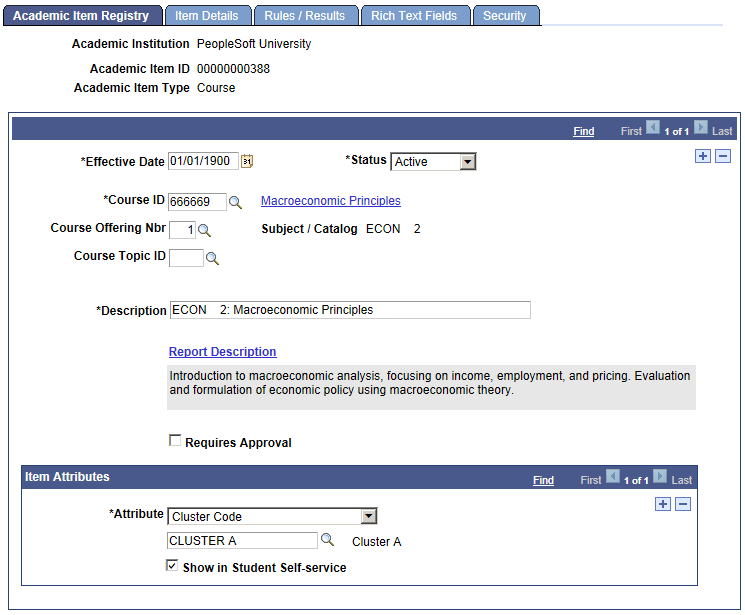

Access the Academic Item Registry page (access this page from the AIR Search component).
Image: Academic Item Registry (PRG) page

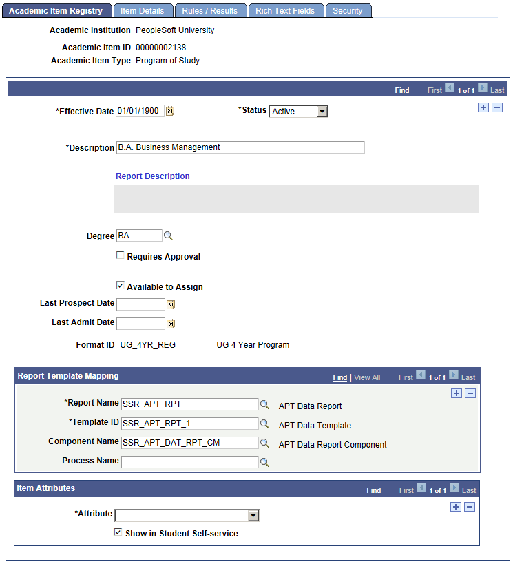

Here is an example of the Academic Item Registry page for Academic Item Type: Program of Study.
Academic Item Registry (PRG) (program) page
Image: Academic Item Registry (COURSE) page
Here is an example of the Academic Item Registry page for Academic Item Type: Course.
Some fields appear on this page only when a particular extension record is used. You associate extension records with academic item types on the Attributes page (Set Up SACR, Foundation Tables, Academic Structure, Academic Item Type, Attributes).
See Defining Academic Item Type Attributes
The Course ID, Course Offering Nbr, and Course Topic ID fields are available when the extension record SSR_AIR_H_CRSE is used (associated with the delivered item type of COURSE). Course Offering Nbr and Course Topic ID may or may not be required depending on the way that you have configured the extension record for the COURSE academic item type.

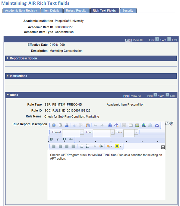

Report Description
Click this link to move to the Rich Text Fields page of this component where Rich Text Editor features are available for this for this description field.
See Maintaining AIR Rich Text Fields

Report Template Mapping
The Report Template Mapping fields appear on the page only for Program item types.
The flexible nature of the Academic Item Registry requires that users have a way to define reports that can interpret and illustrate their user defined program structures. This is particularly important in the area of student results and outcomes, where user defined result types can allow an institution to hold and report student results (grades, scores, credits and so on) and statistics at any point in a program tree. For this reason, we have delivered a self-service component that can be populated with HTML via a Peoplesoft BI Publisher Report Definition. This feature allows users to create a Results page referencing their user defined program structures and result/statistics profile. The AIR Report Template Mapping feature allows users to map a specific BI Report to specific program. The same report can also be shared by different programs with the same program format and result profile.
Currently the Report Template Mapping feature is used solely to attach a user defined BI report definition to the student self-service results component. The steps for associating a report to the self-service results component are:
  • In BI Publisher:
    • Create a data source/upload a sample data file.
    • Design and define a report definition.
  • In AIR: Associate the report with the self-service Results component using Report Template Mapping.
A sample report has been delivered with the April 2014 updates.
See the following document in My Oracle Support (ID 1400723.1): Using BI Publisher and the XMLP Results Template to Display Students’ Results and Outcomes in Program Enrollment Self Service: Sample Template.
See PeopleTools: BI Publisher for PeopleSoft
Field or Control
Definition
Report Name
Prompts against a view of active BI reports defined with a type of ‘XML’ (XML File) or ‘XMD’ (XML Doc Object).
Template ID
Prompts against valid templates for the selected Report Name.
Component Name
Currently prompts against a view that returns components enabled for the program enrollment student self-service XML menu (currently the delivered SSR_APT_DAT_RPT_CM component).
Process Name
Planned for the future.

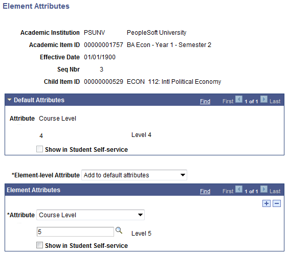

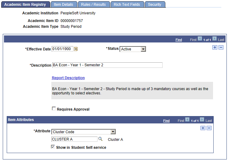

Item Attributes
The Item Attributes area is available when a Common Attribute(s) has been associated with an academic item type entity. Associate item attributes and academic item types on the Common Attributes – Record Context page. See the following section “Using Item Attributes to Extend AIR Data Elements”.
The Common Attribute Framework allows you to extend the delivered AIR functionality without customizations, by enabling you to add different types of data elements to your program structures. An item attribute can be associated with one or more academic item types, and after it is linked to an academic item type, that attribute can be assigned to all academic items of that type. You can link to the attribute at the academic item level itself, or when the attribute is added as a child academic item of another academic item.
Note: Any existing academic item attributes (created prior to Additional Features July 2012) must be recreated using the Common Attribute Framework.

An academic item:
  • Can have multiple item attributes, at the academic item level itself or as a child item of another academic item (see Child Academic Items below).
  • Can have multiple rows for the same item attribute as long as the attribute Value is different (for example Attribute A, with Value 1, Attribute A with Value 2).
Image: Academic Item Registry page Item Attributes example
When attributes have been assigned to the SSR_AIR_HDR context, the Item Attributes scroll area is available on the Academic Item Registry page.
Field or Control
Definition
Attribute
The name of the attribute. This value comes from the description entered for the attribute on the Common Attribute component.
Value
This field changes depending on the type of attribute. This could be a numeric, date, time or text field. Alternatively, the field could prompt against a list of values if one has been defined for the attribute.
Show in Student Self-service
If you select this check box, the attribute is displayed in the filter results in Course Groups component.
Wider use of this check box is planned for the future.
See Defining Filters
See Setting Up Academic Item Registry Entries, Item Details, and Item Security
As mentioned previously, item attributes can be assigned to child academic items, allowing you to assign attributes to academic items in the context of a parent item. For example, an item that represents a course CHEM 399 might have a requirement for minimum score, but only when the course is taken at a certain point in certain program (for example, semester 3 of the Nursing program). This could be coded as a numeric attribute (applicable to the COURSE item type) that can be applied to CHEM 399 as a child of the item representing semester 3 of the nursing program.
Note: An element attribute can override or add to any and all attributes attached to that item at the header level.
Access the Element Attributes (SSR_AIR_ENATTR_SEC) page (click the Element Attributes link in the Attributes tab, Academic Item Elements grid on the Item Details page in AIR).
Image: Item Details example page
Here is an example of the AIR Item Details page from which you access the Element Attributes page:
The Element-level Attribute value selected on the Attributes tab carries over to the Element Attributes page but can be changed:
Image: Element Attributes page
This example illustrates the fields and controls on the Element Attributes page. You can find definitions for the fields and controls later on this page.
Field or Control
Definition
Default Attributes
All attributes linked to this academic item (ECON 112 in the example) at the item header level are displayed. This attribute is associated with the Record Context SSR_AIR_HDR and stored in the SSR_AIR_ADD table.
The value selected in the Attributes tab (on the Item Details page) appears by default but can be changed. Values are:
  • Use default item attributes: The user cannot enter new values.
  • Add to default attributes: The Attribute and Value fields in the Elements Attributes group box are available. Any value that is added is used in addition to the default value(s). In the example above, ECON 112 would have two attributes when used as child of BA Econ – Year 1 – Semester 2: Level 2 and Level 3.
  • Override default attributes: The Attribute and Value fields are available in the Element Attributes group box. Any value that is added is used instead of the default value(s). In the example above, ECON 112 would have an attribute of Level 3 rather than Level 2 when used as child of BA Econ – Year 1 – Semester 2.

Access the Item Details page (access this page from the AIR Search component.)
Image: Item Details page (1 of 2)
This example illustrates the fields and controls on the Item Details page (1 of 2). You can find definitions for the fields and controls later on this page.
Image: Item Details page (2 of 2)
This example illustrates the fields and controls on the Item Details page (2 of 2). You can find definitions for the fields and controls later on this page.
Field or Control
Definition
Instructions
This field is available if the Instructions check box is selected on the Attributes page in Academic Item Type setup. Click the Instructions link to access the AIR Rich Text Fields page and enter instructions for self-service users.
Academic Item Parameters
This grid is available if the Item Parameters check box is selected on the Attributes page in the Academic Item Type setup.
Enter parameter data by load and enrollment category, to be used in Self Service (planned for the future).
Parameters can be overridden at the child item level.
This grid is available if the Child Academic Items check box is selected on the Attributes setup page for an academic item type.
Academic Item Elements establish the relationship between one academic item and one or more other academic items, where one or more items are connected as children of another item. Child elements typically represent all of the items that a student must complete in order to satisfy the requirements for a particular academic item. For example a Program of Study academic item might have a number of child elements that are Year or Stage academic items, and the student might need to successfully complete each of those stages in order to complete the program.
Elements Tab:
Field or Control
Definition
Connector
This field is available if the Show Connectors check box is selected on the Attributes page for an academic item type. The And option is selected by default, except for COURSELIST items—when child COURSE items are added, the Connector default option is Or.
Special processing applies when a child item with an academic item type identified as a Program Format Tree Node is used - the child item connector attribute is limited to And. An error message is returned on save if the Academic Item Elements grid contains one or more items that are identified as Program Format Tree Nodes and there is one row in which the connector is Or.
See Setting Up Academic Item Types
Academic Item Type
Select a child academic item type based on the values that you set up in the Item Type Matrix component. Only items identified in the Item Type Matrix as valid child items of this AIR item are available for selection.
See Using the Item Type Matrix
Available values are also dependent on the AIR security of the user. Academic Item Types defined as Program Format tree nodes are excluded from the prompt unless the user has been authorized as an AIR administrator.
SeenSetting Up AIR Administrator Security
Child Item ID
Select a child item ID. The values that are available here are based on the Academic Item ID value (system generated) that appears on the Academic Item Registry page for the academic item type.
Description
Displays the description for the Child Academic Item ID. Click the link to view the item definition for the child item.
Use the Parentheses buttons to add or delete left or right parentheses. Parentheses are used to group items for AND/OR constructs. For example: (course 1 and course 2) or (course 3 and course 4).

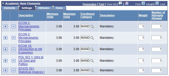

Settings Tab:
Image: Item Details page: Settings tab
This example illustrates the fields and controls on the Item Details page: Settings tab. You can find definitions for the fields and controls later on this page.
In order to show all fields on this tab, the example Settings tab is for a different academic item – Study Period - than the one used in the example of the Elements tab – Stage of Program.
Minimum Units and Maximum Units values are displayed if the child academic item is a Course.

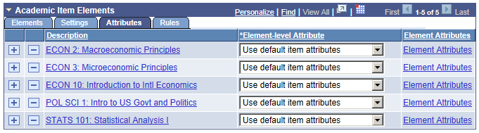

Attributes Tab:
Image: Item Details page: Attributes tab
This example illustrates the fields and controls on the Item Details page: Attributes tab.
Field or Control
Definition
Determines how attributes that are linked to the child element are to be used in the context of the parent item. The values are:
Use default item attributes: Any attributes linked to this element at the item header level apply in the context of the parent. For example if ECON 2 has attribute ‘Level’ with a value of ‘2’, this value applies when the course is used as a child of this item (for example, a semester or study period).
Override default attributes: Any attributes linked to this element at the item header level are to be ignored in favor of attributes that are applied to this item in the context of the parent (see Element Attributes below).
Add to default attributes: Any attributes linked to this element at the item header level are used in addition to Element attributes defined at this level (see Element Attributes below).
Element Attributes
Click this link to access the Element Attributes page to view, override or add attributes.
See Assigning Item Attributes to Child Academic Items

Viewing and Updating Parameters
Access the Element Parameters page (click the Element Parameters link on the Item Details page).
Image: Element Parameters page
This example illustrates the fields and controls on the Element Parameters page.
Use the Element Parameters page to view the parameters defined for this item. You can also override the parameters or make additions to them. This allows the overridden (or additional) values to be used for display purposes when an item is accessed in the context of its parent.

Access the Rules / Results page (access this page from the AIR Search component.)
Image: Rules / Results page
This example illustrates the fields and controls on the Rules / Results page. You can find definitions for the fields and controls later on this page.
The Rules / Results page is available if an item is configured to have Rules and/or Result Types attached to it as explained in the following documentation.
Item Rules
The Item Rules section is available only if the academic item type (of the item) is associated with at least one rule type on the Rule Type Table page.
See Setting Up Rules for Program Enrollment
You can assign multiple rules to an academic item but each rule must be of a different rule type.
The rules that you assign here are available for use in User Interfaces and batch processing.
Field or Control
Definition
Rule Type
Select a rule type from those defined on the Program Enrollment - Rule Type Table page.
Rule Search
Click to launch the standard Rules Engine search:
  • The Rule Group Name associated with the rule type on the Program Enrollment - Rules Type Table is passed to the search criteria and cannot be changed.
  • Rule Category is required.
  • Rule Engine Search is used to return rules with the passed group name as well as any criteria that you add.
See Understanding the Rules Engine
See Setting Up the Rules Engine
When this check box is selected, the Rule Name and associated description appear on the self-service Item Details page.
Rule Report Description
When a rule is returned from the search, the Rules Engine Long Description is used as a default but you can edit it by clicking the Rule Report Description link and accessing the Rich Text fields page.
Result Types
The Result Types grid is available only if the academic item type (of the item) is associated with at least one result type on the Result Type page.
Note: Any result type, for which the Auto-create in AIR check box is selected (by academic item type) on the Result Type setup component, is inserted into the Result Types grid when a new academic item is created. Calculation rules associated to the result type are also inserted in the grid.
Field or Control
Definition
Result Type
The result types available here are those attached to the academic item type in the Item Type Usage grid on the Result Type page.
Use Default Calc Rule
If this check box is selected, the default calc rule associated with this item type/result type combination on the Result Type setup component is used and cannot be changed. If the check box is deselected, the Rule Name field is available and the prompt can be used to select a valid rule.
See Setting Up Result Types
The result types assigned to an item are moved to APT when the item is added for a student.
See Creating and Managing APT Instances Using the Academic Progress Tracker Component
Access the Rich Text Fields page (click the Report Description link on the Academic Item Registry page).
Image: Rich Text Fields page
This example illustrates the fields and controls on the Rich Text Fields page.
The Rich Text fields page allows you to maintain all three AIR Rich Text enabled fields in one place. A rich text field is available for Report Description and Instructions. Each Rule associated with this item can also have its own rich text enabled description.

Access the Security page (Click the Item ID link or Add New Item button on the AIR Search page).
Image: AIR Security page
This example illustrates the fields and controls on the AIR Security page. You can find definitions for the fields and controls later on this page.
AIR (Academic Item Registry) Security page
Security for AIR Entries
AIR items are secured using the existing User ID based Campus Solutions Academic Organization security. A user’s academic organization privileges (as defined under Academic Organization Security (SACR, Security, Secure Student Administration, User ID, Academic Org Security) determine whether a user has update or read only access to a particular academic item.
See Securing Academic Organizations
  • Updating or viewing an existing academic item:
    When a user retrieves an AIR entry, the system compares the entries in the AIR security table (SSR_AIR_SCRTY) to the user’s academic organization security profile (SCRTY_TBL_ACAD). If the security option is Grant access to selected academic organizations and a matching academic organization row is found (or if Available to all academic organizations is selected), the user has update access to the item. If no match is found, the user has read only access to the component.

  • Course Academic Items:
    When a user creates a new course item, the Grant access to selected academic organizations option is selected by default and not available for edit. If the user specifies a course offering, the system also displays the relevant academic organization. If the user does not specify a course offering, the system retrieves the academic organizations for all offerings of the course when the component is saved. Only users with access to the organizations listed on the Security page can maintain the course.
Academic items with the delivered item type of COURSE, COURSEGROUP, and COURSELIST are subject to a series of edits and restrictions:
  • Course Item (Academic Item Type = COURSE):
    • Only one instance of a Course ID/Offer Number/Topic ID combination is allowed in AIR. When a COURSE academic item type is saved, an edit is performed to check for a match on Course ID, Course Offer Nbr, and Topic ID. If you try to create an academic item with the following attributes: Course ID: 007125, Course Offer Nbr: 1 (ECON 198), Course Topic ID: 1, and a match is found, you receive an error message pointing to the existing academic item. The same edit applies for offerings for which no course topics are defined - only one academic item is allowed for the course offering.
    • When a COURSE item is added as a child of another academic item other than COURSELIST (see the following information about COURSELIST items), the COURSE item must have an Enrollment Category.

Course List Copy Function
For Course List academic items, in Add mode, the Copy AA Course List button is available in addition to the Copy from AIR button. If you select the Copy AA Course List option, only those rows in the AA course list that do not have a wild card indicator are copied. Click the button to access a look up page:
  • AA Academic structure fields are available for searching, in addition to Course List.
  • When an item is selected, all course list rows that do not have wild card indicator rows are copied over: that is any row from CLST_DETL_TBL where WILDCARD_ID = Y is excluded.
