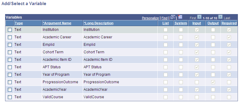

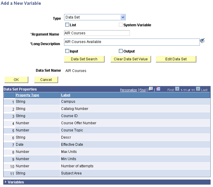

Add a New Variable |
SCC_RULE_VARD_SEC |
Click the Add a New Variable button on the Define Rule page. |
Add Variables to a Rule. |

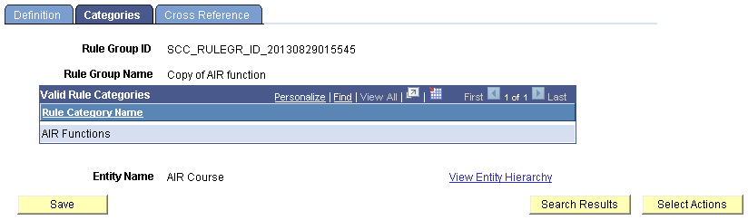

Rule Groups Categories |
SCC_RULEGR_CAT |
, select the Search for a Rule Group radio button and click Next. Enter Search criteria, click the Search button, select a Rule Group from the results, and click the Categories tab. , select the Add a New Rule Group radio button, click Next and click the Categories tab. , select the Create a Rule Group from Group radio button and click Next. Enter Search criteria, click the Search button, select a Rule Group from results, and click the Categories tab. |
Define valid Rule Categories for a Rule Group. |

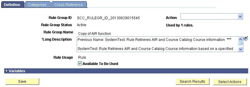

Define Rule Groups Definition |
SCC_RULEGR_MGR |
, select the Search for a Rule Group radio button and click Next. Enter Search criteria, click Search button, select a Rule Group from results. , select the Add a New Rule Group radio button and click Next. , select the Create a Rule Group from Rule radio button and click Next. Enter Search criteria, click the Search button, and select a Rule from the results. , select the Create a Rule Group from Group radio button and click Next. Enter Search criteria, click the Search button, and select a Rule Group from the results. |
Define Rule Groups. |

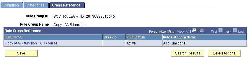

Rule Groups Cross Reference |
SCC_RULEGR_MGR |
, select the Search for a Rule Group radio button and click Next. Enter Search criteria, click the Search button, select a Rule Group from results, click the Cross Reference tab. , select the Add a New Rule Group radio button, click Next, and click the Cross Reference tab. , select the Create a Rule Group from Rule radio button and click Next. Enter Search criteria, click Search button, select a Rule from results, and click the Cross Reference tab. , select the Create a Rule Group from Group radio button and click Next. Enter Search criteria, click Search button, select a Rule Group from results, click the Cross Reference tab. |
View Rules associated with the Rule Group. |

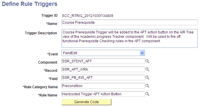

Define Rule Triggers |
SCC_RULE_TRIG |
Define Rule Triggers to determine from where in the system a Rule can be called. |

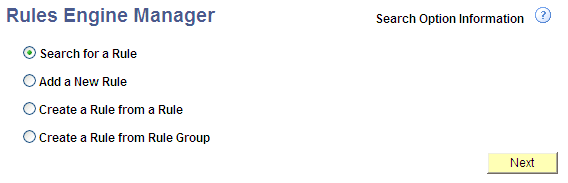

Rules Engine Search is the starting point for the following activities:
Searching for Rules.
Adding new Rules.
Creating a new Rule from an existing Rule.
Creating a new Rule for a Rule Group.
Access the Rules Engine Search page ().

Searching for a Rule
In the Rule Engine Manager search page, select Search for a Rule and click on the Next button to open Rules Search options page.

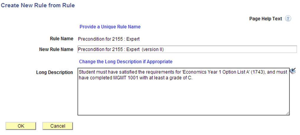

Creating a New Rule from an Existing Rule
In the Rules Engine Manager search page, select Create a Rule from a Rule and click on the Next button to open the Rule Search page.
When you have found the Rule you want to clone, click Next to open the Create New Rule from Rule page and provide a New Rule Name and/or Long Description.
Image: Create New Rule From Rule page
This illustrates the Create New Rule From Rule page.
A new Rule is created with Rule Status In Progress , and it inherits all the Variables, Criteria, and evaluative statements from the Rule you selected to clone
Field or Control |
Definition |
| New Rule Name |
Enter a name for the new Rule. The New Rule Name must be different from the original Rule Name. |
| Long Description |
The Long Description of the original Rule populates this field and can be edited for the new Rule. |

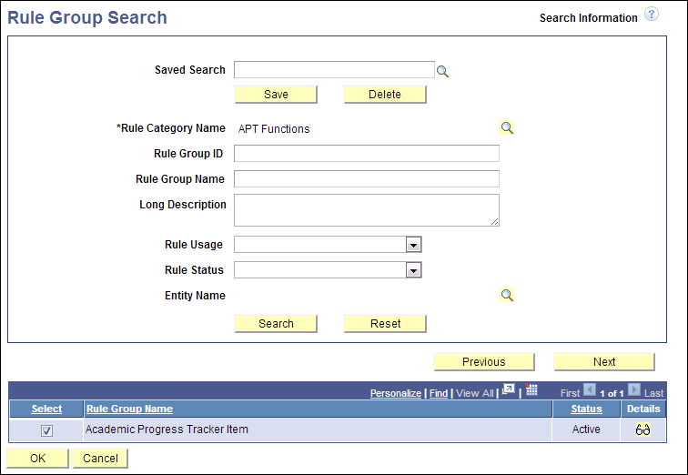

Searching for a Rule Group
In the Rule Group search page, select Search for a Rule Group and click on the Next button to open Rule Group Search options page.
Image: Rule Group Search Options page
This example illustrates the fields and controls on the Rule Group Search Options page. You can find definitions for the fields and controls later on this page.
Rule Category Name is a required field. If a unique Rule Group ID is known and the user has access to the Rule Category, the Rule Category is automatically selected and not required.

Adding a New Rule Group
In the Define Rule Groups page, select Add a New Rule Group and click on the Next button to open the Rules Groups Definition page where you can define the parameters of your new Rule Group.
For more information, see Defining Rule Groups.
Creating a New Rule Group from an Existing Rule
In the Define Rule Groups search page, select Create a Rule Group from Rule and click on the Next button to open the Rule Search options page.
When you have found the Rule you want to base your new Rule Group on, click Next to open the Rule Groups Manager component. A new Rule Group is created with Rule Group Status In Progress, and it has inherited all the Variables, Entity Name, Skill Level and Rule Usage from the Rule you selected.
Note: The Rule Name is also copied. As a first step, you should rename the Rule Group Name to avoid confusion.
Creating a New Rule Group from an Existing Rule Group
In the Define Rule Groups search page, select Create a Rule Group from Group and click on the Next button to open the Rule Group Search page, which is similar to the Rule Search page.
When you have found the Rule Group that you want to clone for a new Rule Group, click Next to open the Rule Group Manager component. A new Rule Group is created with Rule Group Status In Progress, and it has inherited the Input and Output Variables, Entity Profile, Rule Category Name, Rule Usage, Entity Name, and Skill Level of the Rule Group chosen to clone.
Note: The Rule Group Name is also copied from the selected Rule Group. As a first step you should rename this Rule as to avoid confusion.
For more information on how to create and edit Rules, see Defining Rule Groups.

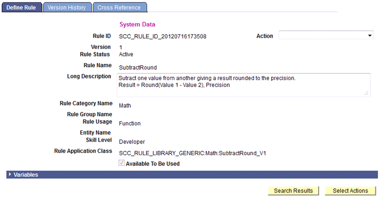

The section describes how to create functional Rules.
Access the Rules Engine Manager Define Rule page (, select Add a New Rule, Define Rule).
Image: Define Rule page
This example illustrates the fields and controls on the Define Rule page. You can find definitions for the fields and controls later on this page.
Note: For Rules delivered with the system and that have System Data displayed in the Rules Engine user interfaces, only the Long Description can be modified.
Field or Control |
Definition |
| Rule ID |
Displays a unique ID generated by the system. When adding a new value the default value is NOID. The unique ID is generated when the Rule is saved. The Rule ID is created by combining prefix SCC_RULE_ID_ with the system date and time stamp in format YYYYMMDDHHMMSS. |
| Action |
Note: The list of available Actions is dynamic depending upon the Rule Status. Note: For System-delivered Rules, only the Build Rule, Create New Group from Rule, Create New Rule from Rule, and Update Status Information (if Rule Status is Not Built) Actions are available. Select an Action for this Rule Group:
| Version |
Displays the Version number of the Rule. Rules are automatically versioned. The first version of a Rule is 1. Only one version of a Rule can be active at any given time. The Action drop down can be used to inactivate an Active Rule and to create a new Rule Version. When creating a new Version, the previous Version automatically becomes Inactive. |
| Rule Status |
Displays the Rule Status
| Rule Build Status |
Displays the Rule Build Status. Values are:
| Status Last Date/Time |
Displays the Last Date/Time of the Rule Build Status in native format including an indication of time zone. This field does not display until after an attempt to build this Rule. |
| Rule Name |
Enter a Rule Name. The Rule Name is used when searching for a Rule and for display. |
| Long Description |
Enter descriptive text explaining the function of the Rule. |
| Rule Category Name |
Enter the Rule Category Name. The Rule Category restricts access to Rule Usages, Rule Categories, and Entities. Available Rule Categories are limited to those for which you have been authorized. This is determined by a Role or our User ID. If you have access to multiple Rule Categories, you should choose the Rule Category that is most appropriate considering the data that the Rule needs to access and any Functions that the Rule may need to call. Functional Expert users who create Rules may not necessarily be familiar with how to create Rule Categories so should be provided with instructions by Rules Engine Administrators about the Rule Categories for which they have been authorized. For example, depending on your institution's policy, Functional Experts may only be authorized to use a single Rule Category. |
| Rule Group Name |
Enter a Rule Group Name if this Rule needs to conform to a specific template with predefined input and output Variables and a predetermined Base Entity. Note: Oracle recommends adding a Rule Group Name directly after you have created your Rule or Function and before adding Entity Profiles, Rule Usages, or Variables as they may conflict with those that are defined in the Rule Group. If you select a Rule Group that has Variables, a Rule Usage, or Base Entity that conflicts with the Rules you are creating, a warning message appears and the Rule Group is not added. |
| Rule Usage |
Select a Rule Usage of Function, Rule, or Trigger. The available Rule Usages are limited to those for which the user has been authorized through Rule Category setup. The selected Rule Usage impacts availability of Rules Engine Manager functionality as follows:
Selection of Rule Usage needs to consider how this Rule is used and what tasks it needs to perform.
| Entity Name |
Enter the Entity to use as the Base Entity for the Rule. The Base Entity controls which application data you have access to when creating a Rule, Function, or Trigger. The Entities available are limited to those for which user has been authorized by attaching Entity Profiles to Rule Categories in the Rule Category setup. Identifying which data to use by designating the Base Entity can be considered the “starting point” of the creation of a functional Rule. Further, using the designated Base Entity with the Rule Criteria makes it possible to identify the exact record to use in the Rule. For a Function that uses a Base Entity, the exact data needed is passed from caller to called Function using Contextual Reference. In this example, a Rule is being created that look at Student Progression; therefore, the Rule needs to access Student Results Data as stored in the Academic Progress Tracker (APT) records. The APT data is represented in the Entity APT Header. By selecting the APT Header as the Base Entity, you can access all of the data associated with the APT Header Entity Tree. This means that you have access to all logical child Entities in that Tree structure like APT Program of Study, APT Course List, and APT Course as well as other data associated with those Entities. As with Rule Categories, Functional Expert users should be provided with instructions on selecting Base Entities. Also consider that since the available Base Entity is determined by the selected Rule Category, it could be that only one Base Entity is presented for selection. For more information, refer to Defining Rule Category Security and Understanding Contextual Referencing. |
| View Entity Hierarchy |
Click this link to display the Entity Hierarchy view for the Base Entity attached to the Rule. |
| Skill Level |
Select the Skill Level required for creating this Rule:
In this example, a functional Rule is being created and there is no “coding” occurring. Therefore, a Skill Level of Expert is being used to demonstrate the Statement, Operator, Function, and Variable features. |
| Rule Application Class |
Note: This field is available and required when Skill Level is Developer. Enter or select a Rule Application Class. A Rule Application Class can be selected from a list of Extension Application Classes. Warning! Developer Rules should be built by Developers/Programmers who have extensive experience with Application Package/Class PeopleCode programming. Developers working with the Rules Engine should be familiar with Entity Registry concepts. |
| Entity Data Load Option |
Note: This field is available and required when the Rule Usage is Rule and an Entity Name has been entered. Select the Data Load Option when creating a Rule.
| Logging Level |
Select the Logging Level to use when testing this Rule:
Note: Oracle recommends using the Trace Logging option to see correct trace results when testing Rules. |
| Available To Be Used |
Select this check box if you want to allow this Rule or Function to be available for use by other Rules or feature functionality. If you do select this check box, it is recommended that you do so after adding Variables and Criteria to the Rule and finalizing the functionality for your Rule. |
Note: Save the Rule after completing the first portion of the Definition tab (everything above the Available in Other Rules check box) and before adding Variables and Criteria. At this point the Rule Status is In Progress, and the Rule can still be changed and retested.
Note: You cannot version Rules with a Rule Usage of Rule or Function that are delivered with the System and that have System Data displayed in the Rules Engine user interfaces. These Rules must be copied (cloned) and a new Rule or Function created.
You can version Rules with a Rule Usage of Trigger that are delivered with the System and have System Data displayed in the Rules Engine user interfaces.

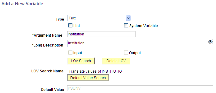

To add a Variable, access the Add a New Variable page (click the Add a Variable button on the Rule Definition page).
Image: Add a New Variable page
This example illustrates the fields and controls on the Add a New Variable page. You can find definitions for the fields and controls later on this page.
Field or Control |
Definition |
| Type |
Select the Variable Type that you want to add:
Type is displayed in the Variables grid and can be selected when viewing or adding Variables. |
| List |
Select this check box if the variable is a List variable which can contain multiple values. Use this option in combination with Type to obtain a list of specific values. List is displayed in the Variables grid and can be selected when viewing or adding Variables. Selecting this check box activates the Default Values button and the Default List Values field. |
| System Variable |
Select this check box if the variable is a System Variable predefined in setup outside of this Rule. System Variable is displayed as System in the Variables grid and can be selected when viewing or adding Variables. Selecting this check box activates the System Variable Search button and the System Variable Name field. |
| Argument Name |
Enter an Argument Name for Variable. The Argument Name is used when searching for a Variable and for display. |
| Long Description |
Enter descriptive text explaining the function of the Variable. |
| Input |
Select this check box if the variable is an Input Variable. Input is displayed in the Variables grid and can be selected when viewing or adding Variables. |
| Required |
Select this check box if the variable is required. Required is displayed in the Variables grid and can be selected when viewing or adding Variables. |
| Output |
Select this check box if the variable is an Output Variable. Output is displayed in the Variables grid and can be selected when viewing or adding Variables. |
| Default Value |
Click this button to open the Create Default List Values page. Add List Values in the Value column and click the OK button. Note: This button is available when the List option is selected. To remove a List Value, select the corresponding Remove check box for a Value and click the Remove Selected Values button. Note: If the List option is not selected, Default Value is an edit field. A Default Value can be entered here for this Variable. |
| Default List Values |
Displays values for this Variable created using the Create Default List Values page. |
| System Variable Search |
Click this button to open the Prompt for Rules Engine System Variables page. This button only appears when System Variable is selected above. |
| System Variable Name |
Displays the selected System Variable Name. This field only appears when System Variable is selected above. |
| LOV Search |
Click this button to open the Prompt for LOV Searches page. Search on a Field Name of Description, Dropdown Prompt Filed, Edit Table, LOV Context, or LOV Unique ID. Results display a Descr (description) link. Click the link to select an LOV. This returns you to the Add a New Variable page with the LOV Search Name displayed. Note: LOV Search results display a list of all available LOV values. The list is not limited to those LOV values which have been created specifically for the Rules Engine. |
| Delete LOV |
Click this button to remove an LOV. This button becomes visible when a LOV has been attached to the variable |
| LOV Search Name |
Displays selected LOV. |
| Default Value Search |
Click this button to open the Prompt for (selected LOV) page. Search on a Field Name of Description or Value. Results display a Values link. Click the link to select a Default Value. This returns you to the Add a Variable page with the Default Value displayed. |
| Default Value |
Displays Default Value. |
| Clear Default Value |
Removes default value from Variable. |
Adding a Data Set Variable to a Rule
When a Data Set variable Type is selected, there are different options to select.
Image: Add a New Variable – Data Set Option
This example illustrates the fields and controls on the Add a New Variable – Data Set Option. You can find definitions for the fields and controls later on this page.
Field or Control |
Definition |
| Data Set Search |
Click this button to open the Prompt for Entity page. Search on a Field Name of Data Set ID, Entity Name, or Entity Profile Name. Results display a Entity Profile link. Click the link to select an Entity. This returns you to the Add a New Variable page with the Data Set Name and the Data Set Properties grid displayed. The Data Set Properties grid displays the Property Type and Label of each Variable in the Data Set |
| Data Set Name |
Displays the Data Set Name. |
| Clear Data Set Value |
Click this button to remove the Data Set from the Variable. |
| Edit Data Set |
Click this button to open a secondary page to add default values to the Data Set. |

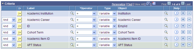

To add Criteria, expand the Criteria group box by clicking the arrow to the left of Criteria in the group box header.
Image: Criteria Grid – Initial Row
This example illustrates the fields and controls on the Criteria Grid – Initial Row. You can find definitions for the fields and controls later on this page.

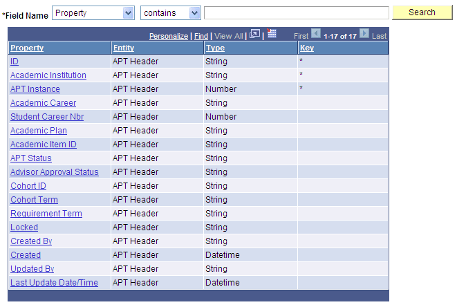

Then, click the Search icon to the right of the Label field to open the Prompt for page where you can select an Entity Property.
Image: Prompt for page
This example illustrates the fields and controls on the Prompt for page. You can find definitions for the fields and controls later on this page.
Click the Academic Institution link to select it as a Property. The Prompt for page closes, and you return to the Criteria grid with the Label column in the first row populated with Academic Institution. The Operator you want to use is = and the Variable Type you want to use is Variable, both of are already populated by default in this case. Since Type Variable is selected, the Search icon appears to the right of the Object field.
Image: Example of Criteria Grid – Label Populated
This example illustrates the fields and controls on the Example of Criteria Grid – Label Populated. You can find definitions for the fields and controls later on this page.
Click the Search icon to the right of the Object field to open the Add/Select Variable page.
Image: Add/Select a Variable page
This example illustrates the fields and controls on the Add/Select a Variable page. You can find definitions for the fields and controls later on this page.
Select the check box next to the Variable you want to add, and click the Add button.
Once you've selected all the Criteria you want to add, the Criteria grid looks something like this:
This example illustrates the fields and controls on the Example of Criteria Grid. You can find definitions for the fields and controls later on this page.
In this example, there is an assumption that a batch process is responsible for supplying the correct Variables to our Rule. This is why the Variables selected for the Criteria grid are Input Variables.

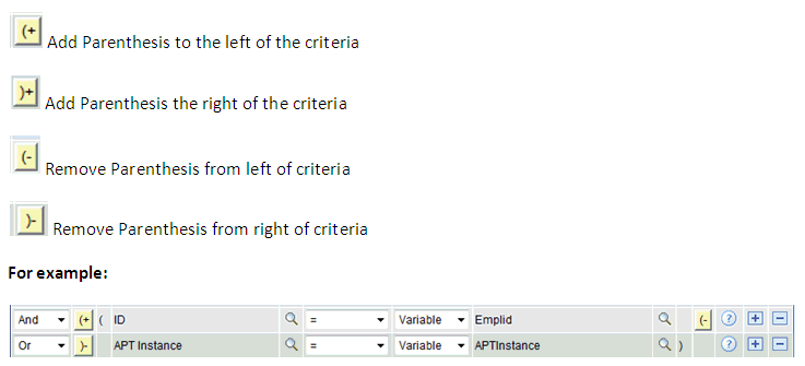

| Connectors and Parentheses |
In the left-most columns of the Criteria grid are the AND/OR connectors and parenthesis. Select these to create complex (nested) Select Criteria. |
Image: Example of Connectors and Parentheses
This example illustrates the fields and controls on the Example of Connectors and Parentheses. You can find definitions for the fields and controls later on this page.

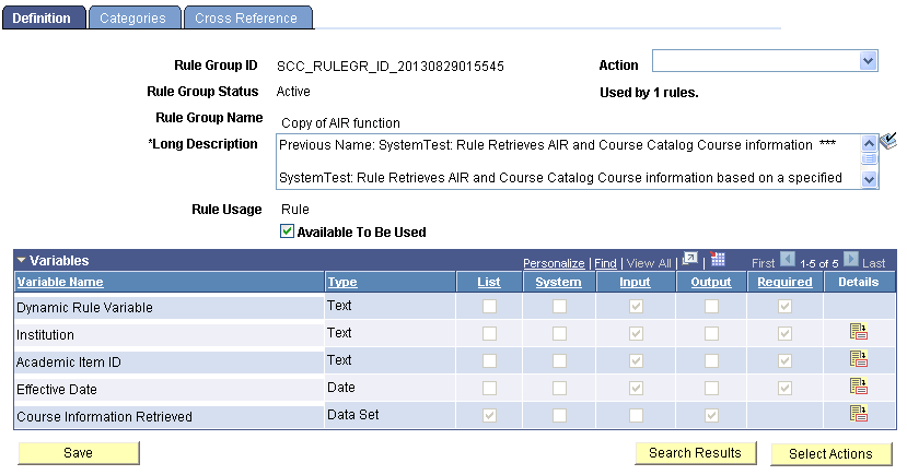

This section covers defining Rule Groups.
Understanding Rule Groups
Rules that share the functional purpose and have similar functionality, input and output can be grouped together in a Rule Group. For Rules to share the same Rule group, they must:
Be based on data in the same Entity Tree and use the same Entity Registry item as the basis for that Rule. This Entity is known as the Base Entity.
Share the same required input parameters.
Share a subset of non-required input parameters.
Share the same output parameters and can pass back required output.
Belong to the same Rule Category, giving them the same security Rules.
One advantage of combining Rules in Rule Groups is that it allows you to call all Rules associated with a Rule Group dynamically. You would not have to know before the fact which Rules you are calling. Rule Groups that have been created can be called from other Rules, Triggers or Functions in the Rules Engine Manager using the “CALL DYNAMIC RULE GROUP” Statement. In short, by allowing Rules to call Rules from Rule Groups dynamically without specifying Rules or Functions directly, it is possible to dynamically call one or more Rules with similar functionality.

Access the Rule Groups Manager Categories page (, select Add a New Rule Group, select the Categories tab).
Image: Define Rule Groups Categories page
This example illustrates the fields and controls on the Define Rule Groups Categories page. You can find definitions for the fields and controls later on this page.
Note: For Rule Categories delivered with the system, only the Long Description on the Definition page and Rule Groups and Security pages can be modified
Field or Control |
Definition |
| Rule Category |
Enter the Rule Categories for this Rule Group. Rule Groups are tied to one or more Rule Category Names. Note: Assign categories first before selecting a Base Entity in the Definition tab. |
| Entity Name |
Enter the Entity for the Rule Group. The Entity entered here is the Default Base Entity for any Rules added to this Rule Group. The Base Entity controls which application data You have access to when building the Rule, Function, or Trigger. |
Click this link to display the Entity Hierarchy view for the Base Entity attached to the Rule Group. |
Access the Rule Groups Manager Definition page (, select Add a New Rule Group, select the Definitions tab).
Image: Define Rule Groups Definition page
This example illustrates the fields and controls on the Define Rule Groups Definition page. You can find definitions for the fields and controls later on this page.
Field or Control |
Definition |
| Action |
Note: For System-delivered Rule Groups, only the Create Rule from Rule Group and Create Rule Group from Group Actions are available. Select an Action for this Rule Group:
Note: The Inactivate Rule Group and Delete Rule Group actions are not available for Rule Groups with Active Rules attached. |
| Rule Group ID |
Displays a unique ID generated by the system. When adding a new value the default value is NOID. The unique ID is generated when the Rule Group is saved. The Rule Group ID is created by combining prefix SCC_RULEGR_ID_ with the system date and time stamp in format YYYYMMDDHHMMSS. |
| Rule Group Status |
| Used By X Rules |
Displays the number of Rules associated with this Rule Group; includes Active and Inactive Rules. |
| Rule Group Name |
Enter a Rule Group Name. The Rule Group Name is used when searching for a Rule Group and for display. |
| Long Description |
Enter descriptive text explaining the function of the Rule Group. |
| Rule Usage |
Select this check box if you want this Rule Group to be available for use by the statement CALL DYNAMIC RULE GROUP. Note: If the Allow Changes to Active Rules check box on the Rule Engine Install Options page is not selected, the Available in Dynamic Rules check box cannot be selected here. |
| Dynamic Rule Variable |
A Dynamic Rule Variable is always created when a Rule Group is created. This Variable is used when calling Rules using the Dynamic Rule Group statement to call the required Rule ID. |
| Add a Variable |
Select this button to open the Add a New Variable page. For more information, see Adding Variables to a Rule. |
Access the Rule Groups Manager Cross Reference page (, search for a Rule Group and select the Cross Reference tab).
Image: Define Rule Groups Cross Reference page
This example illustrates the fields and controls on the Define Rule Groups Cross Reference page. You can find definitions for the fields and controls later on this page.
This page shows Rules and Rule Groups associated with this System Variable.
Field or Control |
Definition |
| Rule Name |
Displays to authorized users links for Rules attached to this Rule Group. If a user is not authorized, the link is disabled. Click a link to transfer out of the component and to the referenced object. Warning! Make sure you have saved any data that you need to before confirming you want to transfer to the referenced object in a new component. If no objects use the Rule Group, a notification is shown in place of the object details; for example, “This Rule Group is not used by any Rules”. |
| Version |
Displays the Rule Version Number. |
| Rule Status |
Displays the status of the Rule (In Progress, Active, In-active). |
Displays the Rule Category Name in which the Rule has been created. |
After a Trigger Rule is defined, a Trigger Definition can be created. Trigger Definitions allow you to associate the Trigger Rule to a Component Event or an Entity Method and generate PeopleCode that can be added to the associated component, record, or field event specified on the Define Rule Triggers page using the Generate Code button.
Note: The component helps to generate Template PeopleCode but does not automatically add this code to the specified event. You may want or need to adjust generated code to add institution specific business logic.
Access the Define Rule Triggers page ().
Image: Define Rule Triggers page
This example illustrates the fields and controls on the Define Rule Triggers page. You can find definitions for the fields and controls later on this page.
Field or Control |
Definition |
| Trigger ID |
Displays a unique ID generated by the system. When adding a new value the default value is NOID. The unique ID is generated when the Rule Trigger is saved. The Trigger ID is created by combining prefix SCC_RTRIG_ with the system date and time stamp in format YYYYMMDDHHMMSS. |
| Name |
Enter a Trigger Name. The Trigger Name is used when searching for a Trigger and for display. |
| Trigger Description |
Enter descriptive text explaining the function of the Trigger. |
| Event |
Note: This field is only available if the Trigger Type is Online Application. Choose the PeopleCode Component Event to add to the Trigger:
| Component |
Note: This field is only available if the Trigger Type is Online Application. Select from a list of available Components in the environment by Component Name or Description. |
| Record |
Note: This field is only available if the Trigger Type is Online Application. Select from a list of available records for the selected Component or any record in the system if no Component is selected by Record Name or Description. |
| Field |
Note: This field is only available if the Trigger Type is Online Application. Select from a list of available fields for the selected Record selected by Field Name or Description. |
Select from a list of Rule Categories for which the “Allow Trigger” option has been selected on the Define Rule Categories definition page by Rule Category Name or Long Description. |
| Rule Name |
Select a Rule to associate with the Trigger. |
