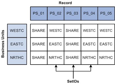

This example illustrates tableset sharing:
Image: Tableset sharing matrix
A sample tableset ID sharing matrix using three business units and five records

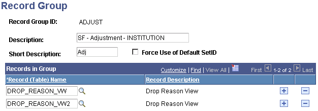

Access the Record Group page ().
Image: Record Group page
This example illustrates the fields and controls on the Record Group page. You can find definitions for the fields and controls later on this page.
In the record group table, group the record definitions for the tables that you want to share, as well as any dependent record definitions. If you're adding a table to a PeopleSoft application, an appropriate record group may already be defined. But if you are adding new functionality, you may need to add a new record group for the tables that you define.
Warning! Record group definitions and the assignment of the individual tables and views to specific groups are provided to ensure complete and accurate tableset sharing within each functional area. You should not change these record group assignments.

| Record Group ID |
Displays the record group ID. The name that you give the record group ID should be descriptive enough to encompass a category of related tables, not just the table that you are specifically sharing. |
| Force Use of Default SetID |
Select to force the use of the default setID. Set up the default setID on the TableSet Control - Record Group page. |
Records in Group
Field or Control |
Definition |
| Record (Table) Name |
Displays the record name of all of the records that are part of the record group ID. Records (tables) are identified by a _TBL extension, and views are identified by a _VW extension. A record group can contain a single table or many tables and views. |
| Record Description |
Displays the description of the associated record (table) name. |
Note: When you add a new record group ID, the system automatically adds the new record group ID to all current set control values (business units). The default setID for the new record group ID is based on the default setID for each set control value, as defined for that set control value on the TableSet Control - Record Group page.

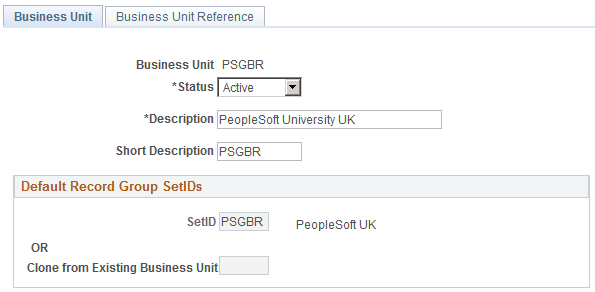

Access the Business Unit page ().
Image: Business Unit page
This example illustrates the fields and controls on the Business Unit page. You can find definitions for the fields and controls later on this page
Warning! For optimal system performance, business units must be five characters. Significant performance degradation occurs if the business units have fewer than five characters.
When you define a business unit, you can specify that the system establish default tableset IDs for the business unit by using the Default Record Group SetIDs group box. This indicates to the system which tableset ID is associated with the business unit. The tableset ID determines the preliminary tableset sharing for the business unit by associating the business unit with a record group.

| Status |
Select a status. Business units are not effective-dated, so use this field to implement or retire business units. |
Field or Control |
Definition |
| SetID |
Enter an existing tableset ID to be used with the business unit. When you're adding a new business unit to the system, the system automatically populates this field with the same name as the new business unit. For example, if the business unit is called MAINC, then the setID appears by default as MAINC. You can override the setID as necessary. |
| Clone from Existing Business Unit |
Enter a business unit code. With this feature, you can clone the tableset sharing setup of an existing business unit. When the record groups are linked to the new business unit, the system assigns each record group the same setID that is used for the record group by the business unit that you selected as the clone unit. For example, you can use this field to have the tableset sharing for the new business unit mirror that of another business unit, or to make the two business units similar except for a few record groups. Note: When you first access the Business Unit page, theClone from Existing Business Unit option is cleared. To activate the option, clear any setID values from the SetID field, and exit the field. |
Note: When you save a new business unit for the first time, the system makes the default setID or clone unit unavailable for entry. You cannot change the default record group setID information for this business unit again. This rule prevents you from accidentally overwriting the tableset record group controls for the defined business units.
When you add a new business unit and save the page, the system creates all of the appropriate table values provided by PeopleTools that connect the business unit ID, record group ID, and setID.

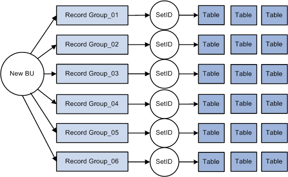

Example of Business Unit and Tableset ID Association
This diagram illustrates how the business unit, record groups, and tableset ID are associated. The business unit and tableset ID can have the same value:
A sample association between a business unit, six record groups, and their corresponding SetIDs.

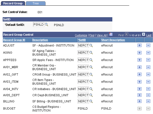

Access the TableSet Control - Record Group page ().
Image: TableSet Control - Record Group page
This example illustrates the fields and controls on the TableSet Control - Record Group page. You can find definitions for the fields and controls later on this page.
Field or Control |
Definition |
| Default SetID |
Enter the default setID to use for the set control value. The default setID is the tableset ID that the system uses when you add additional record definition groups to be shared within this tableset. If you have the system require a default setID (by using the Record Group page), then you cannot change the setID for the record group with a setID that is different from the default setID that you indicate here. The setID for that record group ID becomes unavailable for entry. Remember, most record groups contain a number of tables and views. The tableset ID that you assign to that record group must represent the information that you want to use from each of the control tables contained in that record group. |
| SetID |
For each record group ID, enter the setID to use. |
