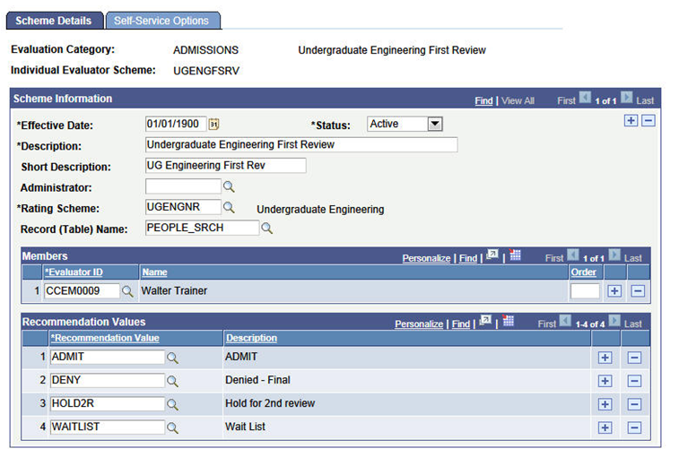

Access the Scheme Details page ((Set Up SACR > Common Definitions > Evaluation Management System > Define Individual Evaluator Scheme > Scheme Details).
Image: Scheme Details page
This example illustrates the fields and controls on the Scheme Details page. You can find definitions for the fields and controls later on this page.
Scheme Details page for defining individual evaluator scheme
The individual evaluator scheme allows for an individual to act as an evaluator without having to be part of a committee. Evaluators can be indicated here, but can also be added on the administrative component.
Field or Control
Definition
Administrator
Select an administrator who is responsible for entering recommendation and status for the scheme in the Manage Evaluation component or the Evaluation Decision Entry self-service page.
If you leave this field blank, you can select an administrator in the Evaluation Schemes setup page where you assign the scheme to an evaluation code.
See Setting Up Evaluation Codes.
Rating Scheme
Enter a value to designate what the evaluators under this scheme will be evaluating. Rating Schemes are defined on the Define Rating Scheme page, where the Evaluation Category is the same for this scheme.
Evaluator Prompt Table
Select the prompt table or view from which you want to assign evaluators to this scheme (evaluators are assigned to the scheme using the Evaluator ID field on this page).
This prompt table defines a group of specific IDs from which evaluators can be assigned. For example, if you are using the Research Tracking feature, you may want to assign evaluators from a group of thesis evaluators. Use PeopleSoft Application Designer to create a prompt table.
If you want to assign evaluators from any ID in the system regardless of their status (such as students, staff, recruiters, prospects, alumni and so on), select PEOPLE_SRCH as the evaluator prompt table.
Evaluator ID
Enter the ID of each person you want to assign to this scheme.
The prompt values depend on the prompt table that you selected in the Evaluator Prompt Table field.
Order
Enter a value here to establish the order in which the workflow processes various individual evaluators. If you do not impose any order, all evaluators work in parallel.
For information about workflow, refer to the Committee Order field description in the preceding Defining Committee Schemes section.
See Defining Committee Schemes.
Recommendation Value
Enter all recommendation values that are applicable to this evaluation. The values apply to all individuals that are part of the scheme. Recommendation values are defined on the Define Recommendation page.
