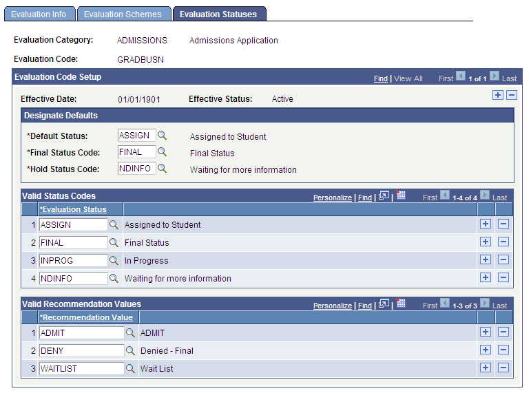

Evaluation Statuses
SCC_GE_EC_STATUS
Set Up SACR > Common Definitions > Evaluation Management System > Define Evaluation Code > Evaluation Statuses
Specify which evaluation status and recommendation field values are to be used for an evaluation code.

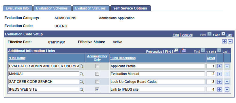

Self-Service Options
SCC_GE_EC_SS_OPT
Set Up SACR > Common Definitions > Evaluation Management System > Define Evaluation Code > Self-Service Options
Configure options for deployment of the Additional Links section in the Evaluation Center for all evaluators associated in the evaluation. Additional Links may be for BI Publisher Reports which will contain data relevant to the evaluation and links to instructional content for conducting the evaluation. These links may be used in conjunction with setup on the Individual Evaluator Scheme and Committee Scheme levels.

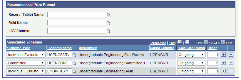

Recommended Prize Prompt
The fields in this group box enable you to specify the table that the system should prompt against to return values for the Recommend Prize field in the Manage Evaluations administrative component. If you do not specify values in these fields, the system will use the Honors and Awards table as the default.
Field or Control
Definition
Record (Table) Name
Enter the table name that the system should reference during prompting.
Field Name
Enter the field from the record that the system should reference during prompting.
LOV Context
If using with List of Values (LOV) functionality, enter the LOV context to be referenced.
See Setting Up List of Values.
Associated Schemes
The fields in this group box list which individual or committee schemes are part of this evaluation.
Field or Control
Definition
Scheme Type
Select either Committee or Individual Evaluator.
Scheme Name
Enter either an Individual Evaluator Scheme or Committee Scheme name, based on the value you selected in the Scheme Type field.
Calculate Option
Select On-going or At End to indicate whether the system should update overall ratings as ratings are entered for the evaluation, or wait until the end to calculate it.
Order
Enter a numeric value to establish the order in which the system should process the various levels.
Note: Specify each scheme's administrator and workflow settings on the Evaluation Schemes page.

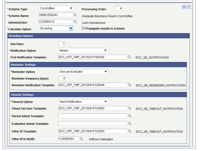

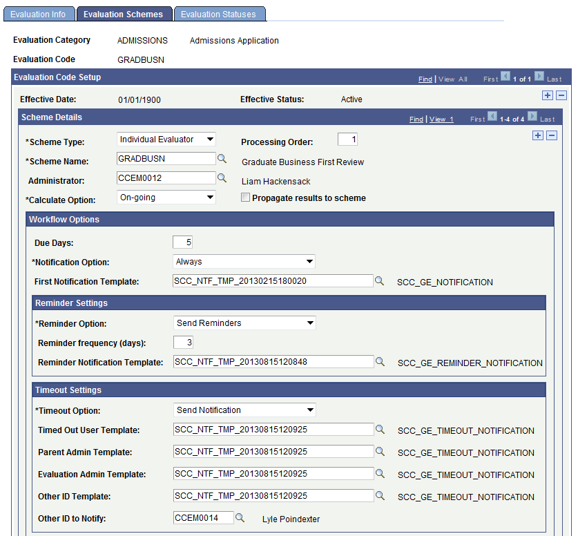

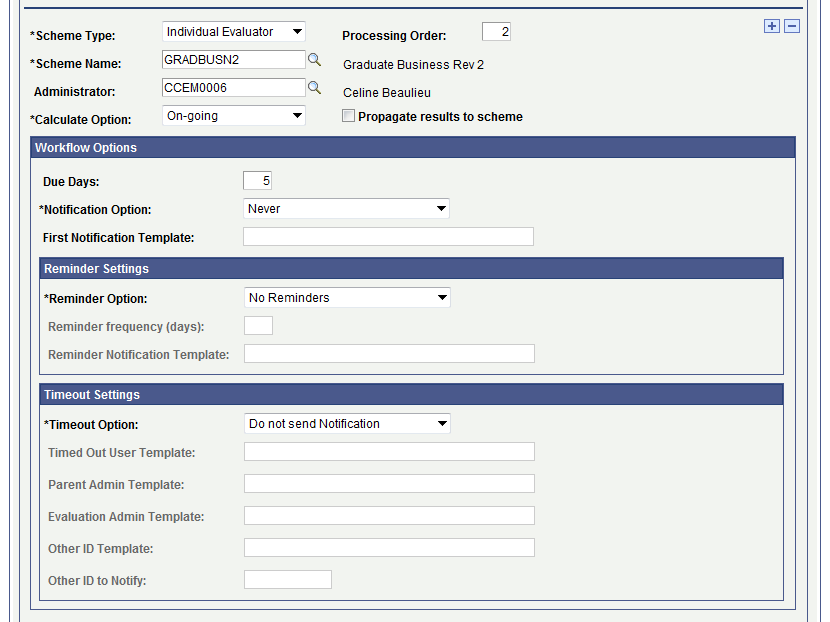

Access the Evaluation Schemes page (Set Up SACR > Common Definitions > Evaluation Management System > Define Evaluation Code > Evaluation Schemes).
Image: Evaluation Schemes page (1 of 4)
This example illustrates the fields and controls on the Evaluation Schemes page (1 of 4). You can find definitions for the fields and controls later on this page.
Image: Evaluation Schemes page (2 of 4)
This example illustrates the fields and controls on the Evaluation Schemes page (2 of 4). You can find definitions for the fields and controls later on this page.
Image: Evaluation Schemes page (3 of 4)
This example illustrates the fields and controls on the Evaluation Schemes page (3 of 4). You can find definitions for the fields and controls later on this page.
Image: Evaluation Schemes page (4 of 4)
This example illustrates the fields and controls on the Evaluation Schemes page (4 of 4). You can find definitions for the fields and controls later on this page.
Each scheme that you enter on the Evaluation Info page automatically appears on the Evaluation Schemes page. You can add more schemes on the Evaluation Schemes page and the system will add those schemes automatically to the Evaluation Info page.
Use the Evaluation Schemes page to specify the administrator and workflow options for each scheme. For example, if you entered four schemes in the Associated Schemes group box of the Evaluation Info page, use this page to specify the administrator and workflow options for each of the schemes.
Workflow options defined for each scheme apply to the administrator of the scheme and all members of the scheme.
Field or Control
Definition
Administrator
Indicates the person responsible for the scheme who will enter the final results at the scheme level in the Manage Evaluation component's Individual Evaluator Scheme page or Committee Scheme page or the Evaluation Decision Entry self-service page. The system populates this field by default from the scheme setup level (Define Individual Evaluator Scheme and Define Committee Scheme pages). If an administrator value does not exist at the scheme setup level, the system populates this field by default from the Evaluation Info page. You can override the default value for this field.
Calculate Option
This field refers to the Overall Rating field associated with the scheme in the Manage Evaluation component's Individual Evaluator Scheme page or Committee Scheme page or the Evaluation Decision Entry self-service page and provides some control over how you will want the system to calculate the Overall Rating value.
On-going: Select if you want that the Overall Rating field should display the accumulative value as the evaluation progresses with evaluators entering rating values for each component in the Individual Evaluator Scheme page or Committee Scheme page or the Evaluation Decision Entry self-service page.
At End: Select if you want that the Overall Rating field should not display a value until all evaluators have provided rating values for each required component in the scheme and marked their evaluation Final.
Processing Order
This field establishes the order in which the workflow should process the various schemes.
You can also define the workflow order among evaluators of an individual evaluator scheme in the Define Individual Evaluator Scheme page. Additionally, you can also define the workflow order among committees of a committee scheme in the Define Committee Scheme page.
See Defining Individual Evaluator Schemes.
See Defining Committee Schemes.
For information on the self-service worklist, refer to “Using Self-Service Worklist” topic in Campus Community - Evaluation WorkCenter documentation.
For an example of how the EMS workflow processes the evaluators and administrators for an evaluation, refer to “Entering Evaluations” topic in Campus Community - Evaluation WorkCenter documentation.
Propagate results to scheme
If you select this check box, the system automatically completes the higher level(s) of the scheme when one of the following conditions is true:
  • Only one evaluator exists in an individual evaluator scheme.
  • Only one committee exists in a committee scheme.
  • Only one evaluator exists in a committee.
Individual Evaluator Scheme: If only one evaluator exists in the scheme, the system will automatically complete the scheme level when the evaluator completes his or her evaluation. The system copies the values for recommendation, status, and overall rating to the scheme level.
Committee Scheme: If only one committee exists in the scheme, the system will automatically complete the scheme level when the committee completes their evaluation. The system copies the values for recommendation, status, and overall rating to the scheme level.
Committee: If only one evaluator exists in the committee, the system will automatically complete the committee level when the evaluator completes his or her evaluation. The system copies the values for recommendation, status, and overall rating to the scheme level. If there is only one committee in the scheme, the values will also be copied to the scheme level.
Note: When this check box is selected, the system does not send an email notification to the committee or scheme administrators whose evaluations were automatically marked as completed.
Workflow Options
Most of the fields in this group box are similar to those on the Evaluation Info page.
Use this group box to specify the due date, notification option for the first notification, email notification template, reminder settings and timeout settings for each scheme.
Schemes may have different due dates (for example, an individual evaluator scheme may take less days to complete the evaluation as compared to a committee scheme). For a scheme you may decide that the workflow should send the first email notification (by setting the scheme's notification option to Always), while for another scheme you may decide that the workflow should not send the first email notification (by setting the scheme's notification option to Never). In addition, schemes may have different first email notification templates (for example, members in an individual evaluator scheme may need less instructions in their email notifications as compared to members of a committee scheme).
The difference between the Timeout Settings sections on the Evaluation Schemes page and the Evaluation Info page is that the section on the Evaluation Schemes page contains two additional fields: Timed Out User Template and Parent Admin Template.
Field or Control
Definition
Select a Notification Template ID of email notification type defined for the Evaluation Management System consumer. The template that you specify in this field will be used by Notifications Framework when sending a timeout notification to the evaluator or committee or scheme administrator who has the past due evaluation.
Select a Notification Template ID of email notification type defined for the Evaluation Management System consumer. The template that you specify in this field will be used by Notifications Framework when sending a timeout notification to the person who is the immediate administrator of the evaluator who has the past due evaluation. Who that person is depends on where in the flow the evaluator is. For example, if it is an individual evaluator scheme, then for the evaluator, the immediate administrator will be the scheme administrator. If it is a Committee Scheme, then for a committee member, it would be the committee administrator. For a committee administrator, it would be the committee scheme administrator.
Access the Evaluation Statuses page (Set Up SACR > Common Definitions > Evaluation Management System > Define Evaluation Code > Evaluation Statuses).
Image: Evaluation Statuses page
This example illustrates the fields and controls on the Evaluation Statuses page. You can find definitions for the fields and controls later on this page
Designate Defaults
The fields in this group box list enable you to define default statuses for three key evaluation actions. The system will use these statuses for processing such as auto-calculation and the evaluation batch creation. The field values you enter here affect the values available in the Valid Status Codes group box.
Field or Control
Definition
Default Status
Enter the default status value for the system to use during the batch evaluation code assignment process. The system will also use this value when you manually assign an evaluation code, but it can be overwritten.
Statuses are defined on the Define Evaluation Status page.
Final Status Code
Enter the status value for the system to use to signify that the evaluation or a level of the evaluation is complete.
Hold Status Code
When an evaluation is placed on hold, this value will signify to the system to suspend processing for the evaluation.
Valid Status Codes
The fields in this group box enable you to indicate any statuses applicable to this evaluation. If you entered a default value in the Designate Defaults group box above, those values automatically display here. However, you can add to the list.
Note: The system forces all Evaluation Status codes you enter here at all levels throughout the evaluation (such as at the individual evaluator level, committee level, or committee member level).
Valid Recommendation Values
The fields in this group box enable you to indicate which recommendation values are applicable to this evaluation. The values you enter here apply to the highest level of the evaluation; you can designate other recommendation values at the individual evaluator and committee scheme levels.
Access the Self-Service Options page (Set Up SACR > Common Definitions > Evaluation Management System > Define Evaluation Code > Self-Service Options).
Image: Self-Service Options page
This example illustrates the fields and controls on the Self-Service Options page. You can find definitions for the fields and controls later on this page
Self-Service Options page for evaluation code
Additional Information Links
Use this group box to enter all links that should be made available to all the participants in this evaluation. Links values are defined in Define Links component. Adding a Link Name here defaults in the Link Description but you can change this description here, if for this code, another descriptive named is desired. Links may be designated as only for Administrator access and will only appear on the Evaluation Administrator self-service page.
Links may also be defined at the Individual Evaluator Scheme and Committee Scheme levels. If links populated at the scheme level are repeats of the Evaluation Code level setup (and not set as Administrator Only), then the repeated scheme link will be filtered out so it will not appear twice. In that instance, the description from the Evaluation Code level will display. You may give an order to how you would like the links to display on the self-service page. If the same links are provided at the scheme levels, the Evaluation Code setup takes priority in terms of the display in the self-service page. In other words, Evaluation Code links will display as numbered, then the scheme links will display in the order indicated, after the Code links
See the Campus Community - Evaluation WorkCenter documentation for examples of how the Additional Information section appears on the self-service pages.
