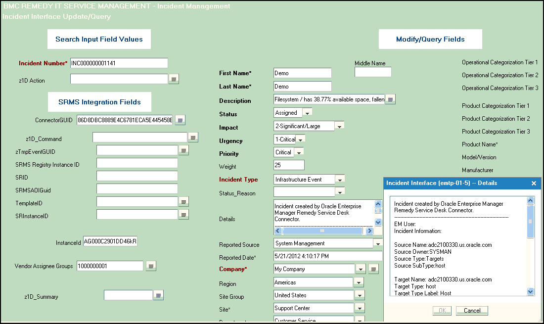

A ticket is updated if there is an existing active ticket for an incident. Figure 3-4 shows the ticket in the Remedy console.

Figure 3-4 Remedy Console Ticket
