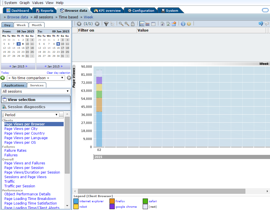

The information available within the Data Browser is divided across groups. At the highest level, there are two types of groups: application-related groups and services-related groups. Each group provides a number of perspectives, or views, on the collected data. These views can be selected from the View selection panel, located on the left-hand side of the Data Browser window (Figure 3-1).
Each main group within the View selection panel relates to a broad category of information. There are groups available about the pages visited on the monitored web environment, visitor sessions, user flows, failed URLs and pages, and key pages.
Within each of these groups, sub-groups offer information about a specific aspect of the selected category. More specifically, they offer information across specific dimensions. These dimensions are indicated in the name of the sub-group. For example, within the All sessions group, views are available across the dimensions domain, period, user ID, client browser, language, location, and operating system. This is shown in Figure 3-3.
Figure 3-3 Data Structure Selection Panel
Individual views are grouped according to a standard classification (failure, performance, overall, and size) that reflects the type of information they provide. Within these, you can select the active dimension you want to use to explore the underlying data.
