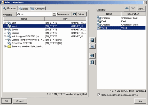

The following figure shows the Member Selection dialog box for the product dimension. The Available area shows the members, member lists, and functions available for the specified dimension. For information on updated functions, see Using Functions.
Figure 1. Member Selection Dialog Box
The image shows the Member Selection Dialog box.
Substitution variables are placed in a directory.
The Selected area shows the names and descriptions of the members you selected for most data sources (SSAS shows Name and Key). You can rearrange the display of the columns in the Available and Selected areas of the Select Members dialog box by dragging the column headings. You can also add columns to the display.
