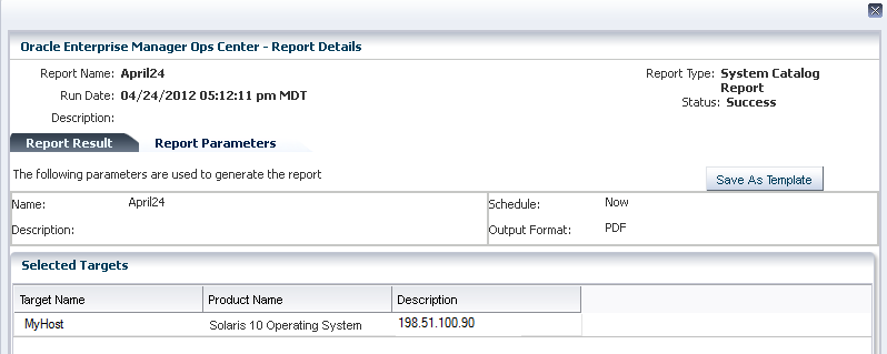

You can view the report from the Report Results section of the center pane. You can select a report and click PDF or CSV to view and export the report result. The figure below displays the PDF output of the report result.

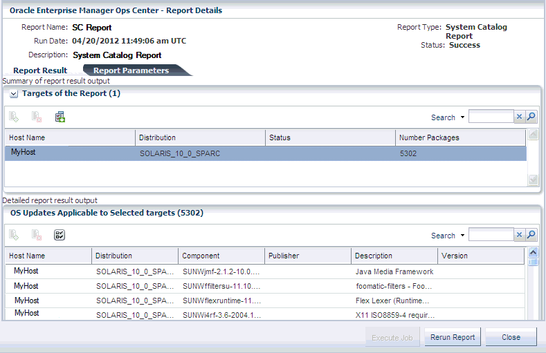

You can view the report interactively. The View Interactive option enables you to view the generated report in detail. Report result displays the Report name, Report type, Run Date, Status, Targets of the Report, OS updates applicable to selected targets. Report parameters show the target name, product name, description. You can save the report as a template and also rerun the report.
Double-click the report in the Report Results section of the center pane to display the details of the generated System Catalog Report. It details out the summary of the report result and the detailed report result displaying the OS updates applicable to the selected targets.
