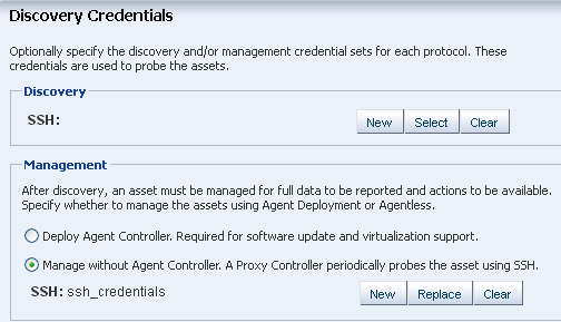

Enter a name and description for the discovery profile. Expand Operating Systems and select Solaris, Linux OS. Click Next.
(Optional) Click Next to skip tags.
(Optional) Click Next to skip adding IP Ranges. You are prompted to provide IP addresses and host names during discovery.
Select Manage without Agent Controller. Click Replace and choose the SSH management credentials. Click Next.
Review the Summary page, then click Finish.

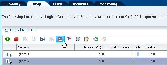

The following options are available for moving metadata:
The following conditions must be met before you can move the logical domain metadata to another library:
The Control Domain must be managed with an OVM Server for SPARC VC Agent.
The Logical Domain must be known to Oracle Enterprise Manager Ops Center.
The Logical Domain and its associated resources are created with Oracle Enterprise Manager Ops Center
A manually created logical domain is agent managed with Oracle Enterprise Manager Ops Center
The logical domain is in a shutdown state.
When the job completes, the logical domain's metadata is located on the new library.
