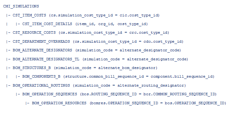

The Simulations web service set provides you with view-only (through http GET) simulation data. The simulation data includes all the data generated or related to one or more simulations. In particular, the response from this web service retrieves data in the following tables and organizes it in the hierarchy shown here:

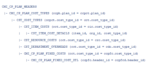

The Planned Costs web service provides you with view only plan cost data. The plan cost data includes all the data generated and related to one or more cost plans. In particular, the response from this web service retrieves data in the following tables and organizes it in the hierarchy shown here:

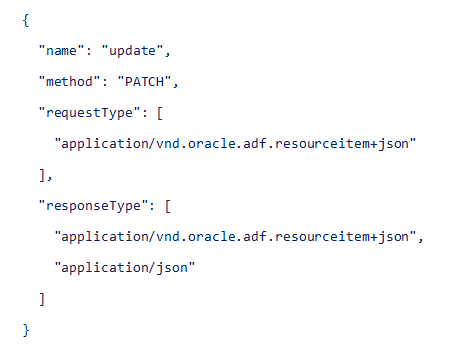

Describe also returns available actions and their request/response type. For example, the following JSON node associated with the resource URL following shows that this resource accepts http PATCH requests with the mentioned content-type:
http://slce201cn14:7002/IMCMCSREST/rest/v1/GPAPlanInterface/{id}
The acceptable http request content-type is:
application/vnd.oracle.adf.resourceitem+json, instead of application/json

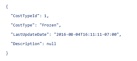

You can add query criteria and/or other conditions to the URL. For example, to query simulation_code Atest3 of the root resource of web service “Simulations”, use:
<host>:<port>/IMCMCSREST/rest/v1/IMCMCSREST/rest/v1/Simulations/Atest3
The simulation_code is the primary key of this resource. To filter by a non-primary-key attribute, e.g., RollupId, use:
<host>:<port>/IMCMCSREST/rest/v1/IMCMCSREST/rest/v1/Simulations/Atest3?q=RollupId=1002

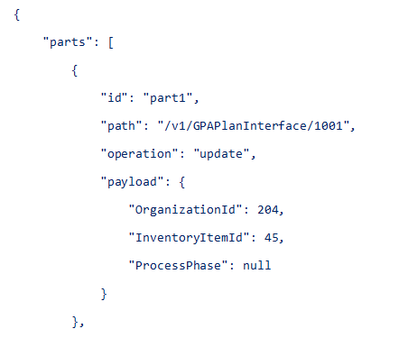

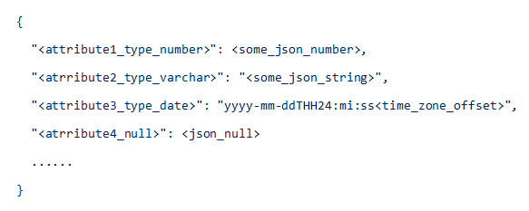

The POST, PUT, PATCH requests must use content-type:
The request body should be in the following format:
For example:

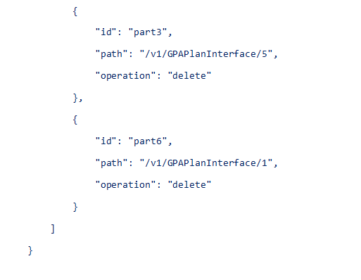

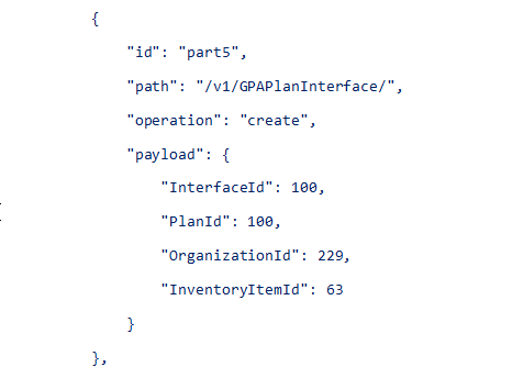

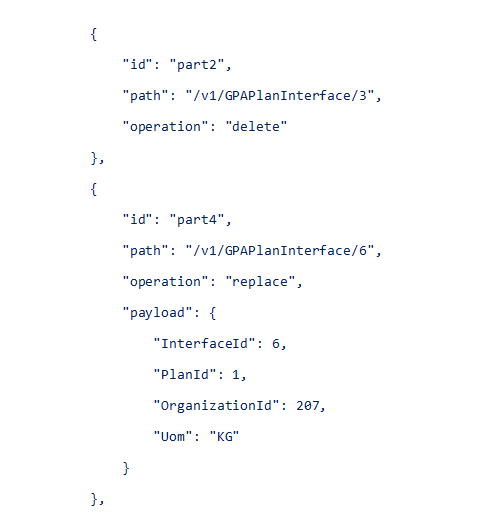

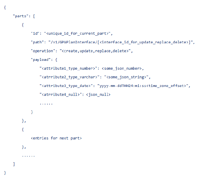

IMCMCS REST Web Service also supports batch requests. To submit a batch request, use the following:
URL
HTTP Method
POST
Content-Type
application/vnd.oracle.adf.batch+json
Payload
For example:
