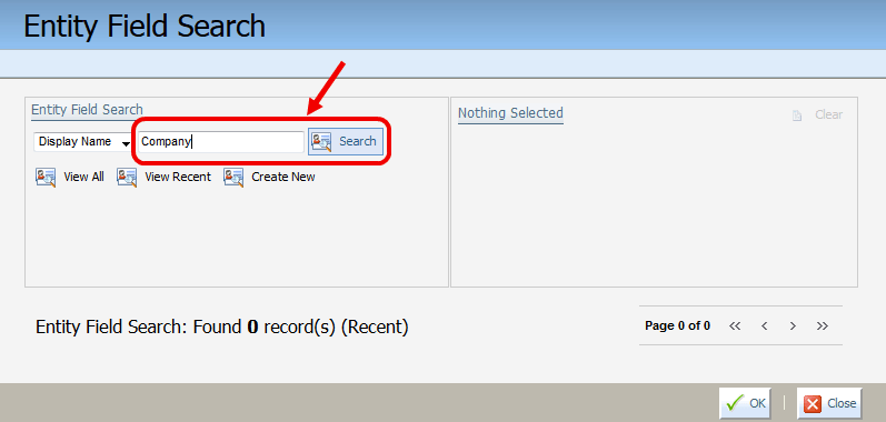

- Click the Account Field search button
. The Entity Field Search menu then opens in a new window. - Locate the account field. You can type the name of a field into the Search field, and then click Search. Alternatively, click View All to get a list of all account fields in your database, or click Create New to create a new field altogether.
- Click the account field in the search results below.
- Click OK.
