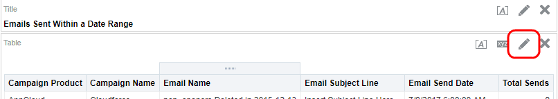

- Click Edit View in the Table view.
The Layout appears.

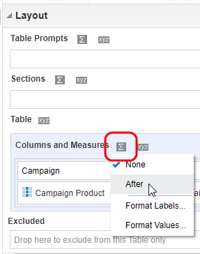

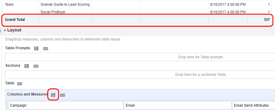

- To add a grand total to the analysis, click Total to the right of Columns and Measures in the Layout pane. Select After from the drop-down list.
- Review the results in the Preview pane.
Note that the Total icon now displays a check mark , indicating that a grand total has been added to the analysis.
Tip: Since we added pagination to our analysis, you might have to navigate to the end of your analysis to see the grand total.
- Click Done and save the analysis.

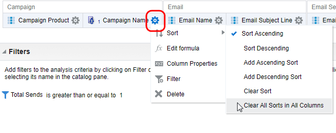

- Remove the column sorting. Click the Criteria tab, click Options for the Campaign Name column, and then select Sort > Clear All Sorts in All Columns.

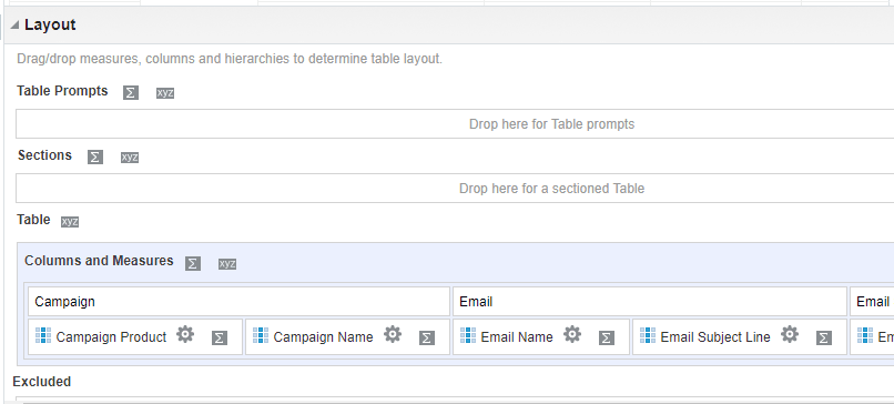

- To add the product total, click Edit View in the Table view.

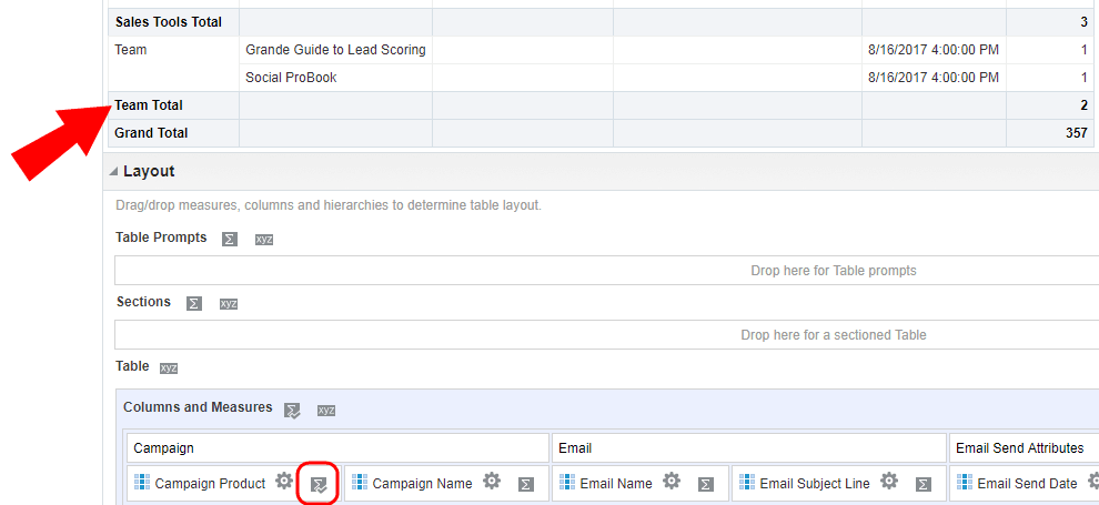

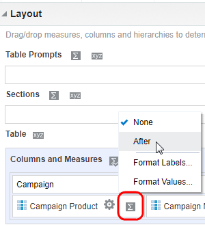

- In the Layout pane, click Total for Campaign Product. Select After from the drop-down list.
- Review the results in the Preview pane. Note that the Total icon now displays a check mark , indicating that a total was added for that specific column.
- Click Done and then save your analysis.
