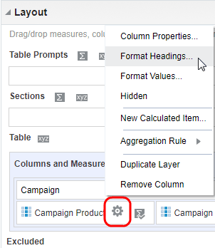

  4. In the Layout pane, click An image of the Options icon Options for Campaign Product and select Format Headings.
    An image showing the Options menu with Format Headings selected
    The Edit Format dialog appears.

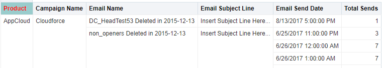

    Your changes appear in the Preview pane.
    An image of the preview pane that shows formatting changes to a column header
  9. Click Done and then save your analysis.
