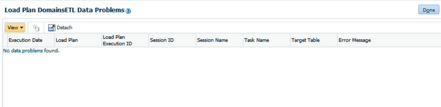

- First, check for data problems by clicking the Show Data Problems option to display the ETL Data Problems dialog.

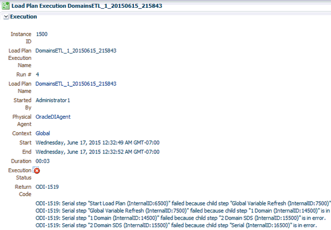

- If no data problems are reported, then click the Execution Status icon to view the load plan details in the ODI Console UI. Here, you can see the top level error messages.
Take a note of the entire error message.

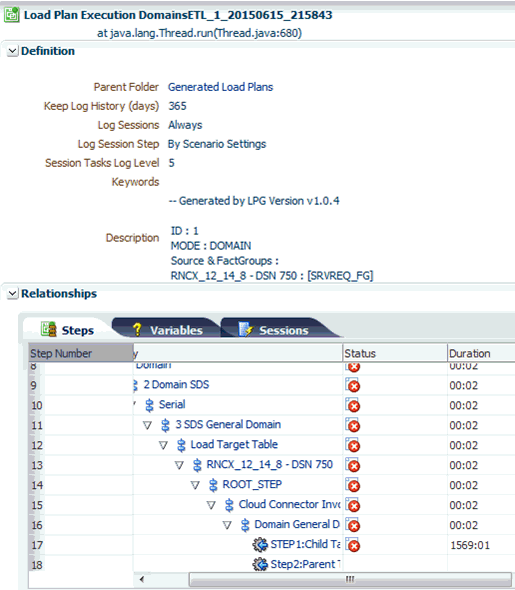

- Scroll down to view the load plan in the tree structure, and click on the session of the task that failed.
- Drill down further to review individual steps.

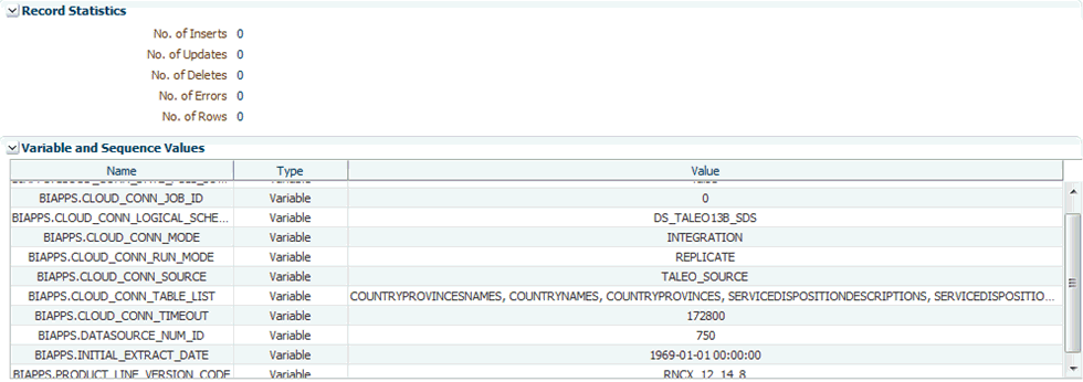

- At each step, you will see further details, error messages, variables & values, and further breakup of the steps.
- You can drill down till you reach the lowest level of the step and gather the details at each step.

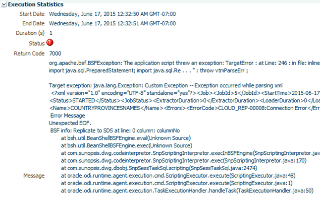

- You can also examine the execution statistics to gather information for diagnosis.
