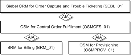

SEBL_01 |
The Siebel Customer Relationship Management (Siebel CRM) instance for order capture and trouble ticketing. |
BRM_01 |
One BRM instance for order billing. |
OSMCSF_01 |
The central fulfillment system (CFS) instance of Oracle Communications Order and Service Management (OSM) system. This is the instance responsible for customer orders in order management. |
OSMPROV_01 |
The provisioning system instance of OSM. |

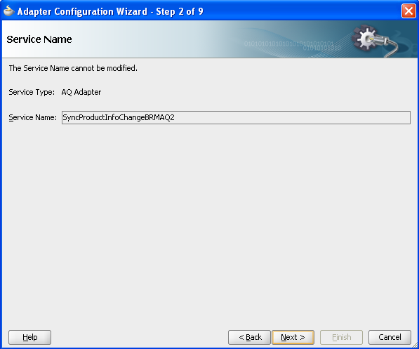

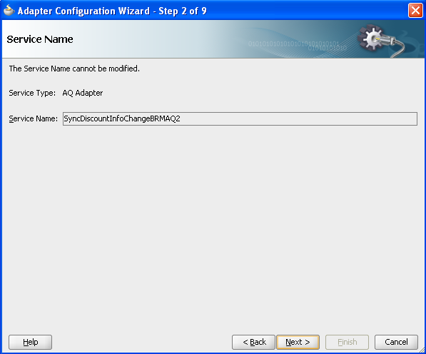

Click Next to display Step 2 (Service Name).
Go to the Service Name field and enter SyncProductInfoChangeBRMAQ2, as shown in Figure F-2.
Figure F-2 Adapter Configuration Wizard - Step 2 of 9

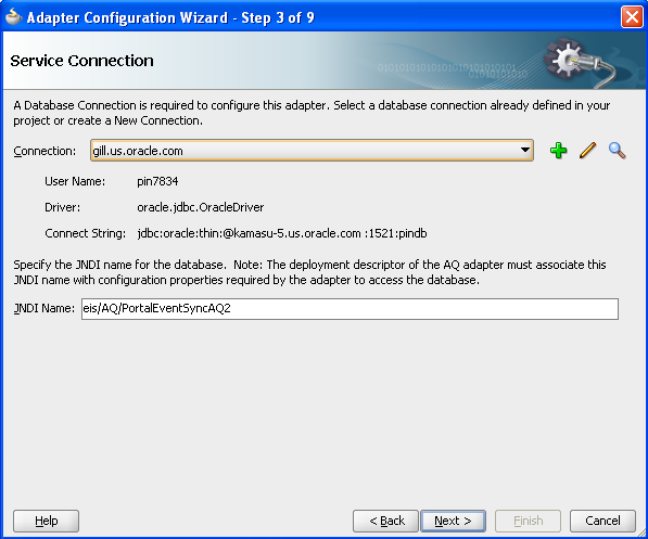

Click Next to display Step 3 (Service Connection).
Go to Connection and select the BRM Database Connection. Go to the JNDI Name field and enter eis/AQ/PortalEventSyncAQ2, as shown in Figure F-3.
Caution:
The JNDI name is not created here by default. You must manually create the JNDI for the consumer that you are creating using the steps provided in "Creating a Data Source and Connection Factory".Figure F-3 Adapter Configuration Wizard - Step 3 of 9

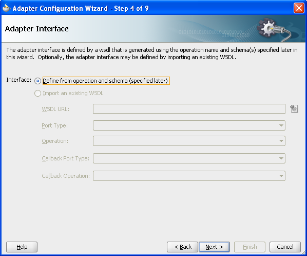

Click Next to display Step 4 (Adapter Interface).
Go to the Interface field and select Define from operation and schema (specified later), as shown in Figure F-4.
Figure F-4 Adapter Configuration Wizard - Step 4 of 9

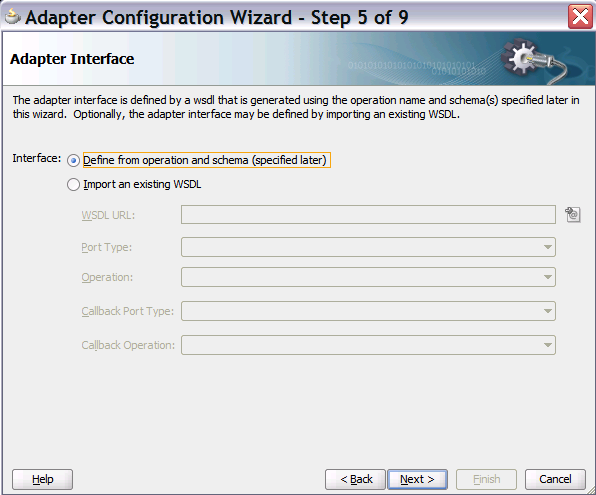

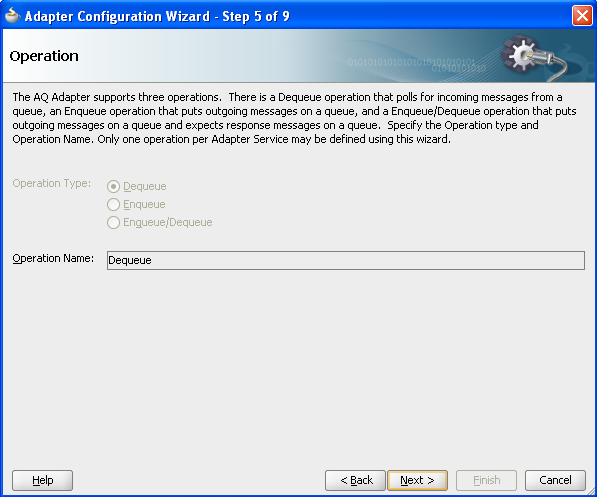

Click Next to display Step 5 (Operation).
Go to the Operation Name field and enter Dequeue, as shown in Figure F-5.
Figure F-5 Adapter Configuration Wizard - Step 5 of 9

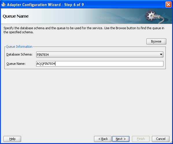

Click Next to display Step 6 (Queue Name).
Go to the Database Schema field and select the additional BRM Instance's database schema, and then enter the queue name configured for this BRM instance, as shown in Figure F-6.
Figure F-6 Adapter Configuration Wizard - Step 6 of 9

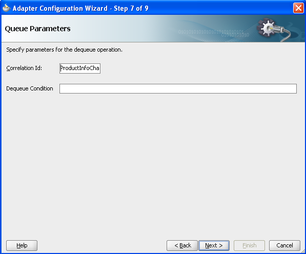

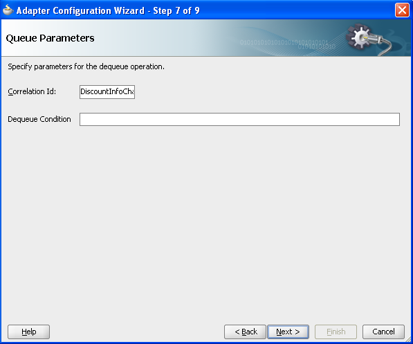

Click Next to display Step 7 (Queue Parameters).
Go to the Correlation Id field and enter ProductInfoChange, as shown in Figure F-7.
Figure F-7 Adapter Configuration Wizard - Step 7 of 9

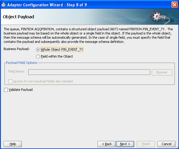

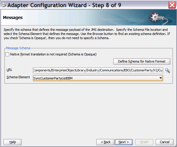

Click Next to display Step 8 (Object Payload).
Go to the Business Payload field and select Whole Object PIN_EVENT_TY, as shown in Figure F-8.
Figure F-8 Adapter Configuration Wizard - Step 8 of 9

Drag a new AQ Adapter component in the exposed services swimlane to display the Adapter Configuration Wizard - Welcome page.
Go to the Service Name field and enter SyncDiscountInfoChangeBRMAQ2, as shown in Figure F-9.
Figure F-9 Adapter Configuration Wizard - Step 2 of 9
Go to Connection and select the BRM Database Connection. Go to the JNDI Name field and enter eis/AQ/PortalEventSyncAQ2, as shown in Figure F-10.
Caution:
The JNDI name is not created here by default. You must manually create the JNDI for the consumer that you are creating using the steps provided in "Creating a Data Source and Connection Factory".Figure F-10 Adapter Configuration Wizard - Step 3 of 9
Go to the Interface field and select Define from operation and schema (specified later), as shown in Figure F-11.
Figure F-11 Adapter Configuration Wizard - Step 4 of 9
Go to the Operation Name field and enter Dequeue, as shown in Figure F-12.
Figure F-12 Adapter Configuration Wizard - Step 5 of 9
Go to the Database Schema field and select the additional BRM Instance's database schema, and then enter the queue name configured for this BRM instance, as shown in Figure F-13.
Figure F-13 Adapter Configuration Wizard - Step 6 of 9
Go to the Correlation Id field and enter DiscountInfoChange, as shown in Figure F-14.
Figure F-14 Adapter Configuration Wizard - Step 7 of 9
Go to the Business Payload field and select Whole Object PIN_EVENT_TY, as shown in Figure F-15.
Figure F-15 Adapter Configuration Wizard - Step 8 of 9

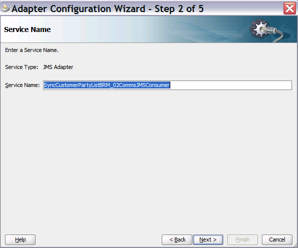

Go to the Service Name field and enter SyncCustomerPartyListBRM_02CommsJMSConsumer, as shown in Figure F-16.
Figure F-16 Adapter Configuration Wizard - Step 2 of 5

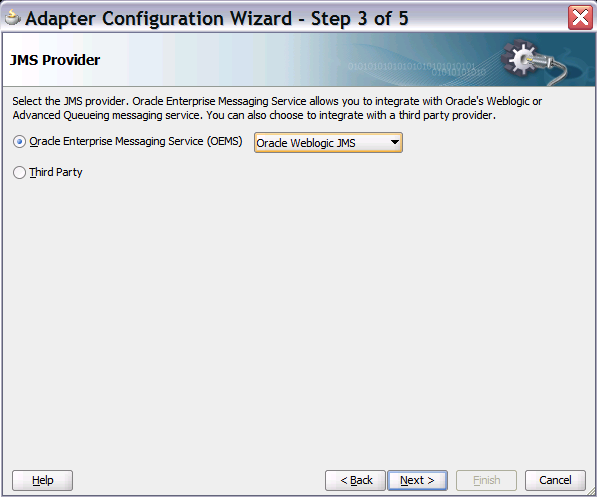

Click Next to display Step 3 (JMS Provider).
Select Oracle Enterprise Messaging Service (OEMS) as the JMS Provider and then select Oracle WebLogic JMS, as shown in Figure F-17.
Figure F-17 Adapter Configuration Wizard - Step 3 of 5

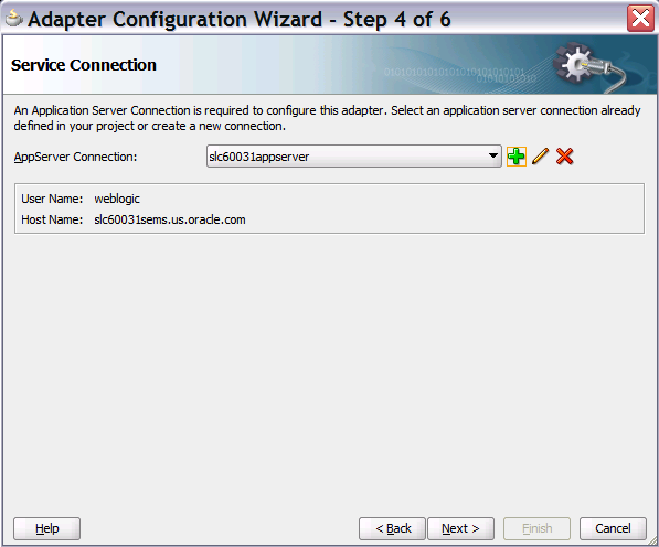

Click Next to display Step 4 (Service Connection).
Create an Application Server Connection to the Fusion Middleware (FMW) server. Go to AppServer Connection and select the corresponding FMW server connection from the drop down, as shown in Figure F-18.
Figure F-18 Adapter Configuration Wizard - Step 4 of 6
Click Next to display Step 5 (Adapter Interface).
Go to the Interface field and select Define from operation and schema (specified later), as shown in Figure F-19.
Figure F-19 Adapter Configuration Wizard - Step 5 of 9

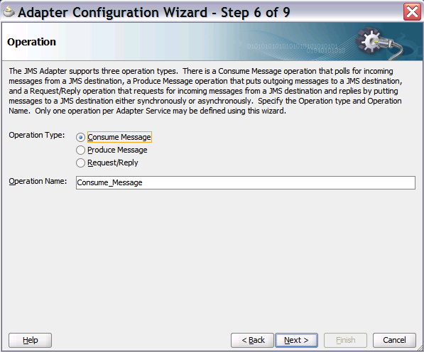

Click Next to display Step 6 (Operation).
Go to the Operation Type field and select Consume Message. Then go to the Operation Name field and enter Consume_Message, as shown in Figure F-20.
Figure F-20 Adapter Configuration Wizard - Step 6 of 9

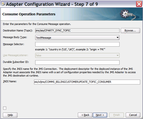

Click Next to display Step 7 (Consume Operation Parameters), as shown in Figure F-21.
Figure F-21 Adapter Configuration Wizard - Step 7 of 9

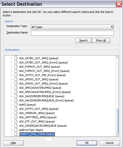

Go to the Destination Name (Topic) field and click Browse to select the required topic, as shown in Figure F-22. Click OK to return to Step 7.
Then go to the JNDI Name field and enter the JNDI name for this JMS Connection.
Click Next to display Step 8 (Messages).
Go to the URL field and enter oramds:/apps/AIAMetaData/AIAComponents/EnterpriseObjectLibrary/Industry/Communications/EBO/CustomerParty/V2/CustomerPartyEBM.xsd. Go to the Schema Element field and enter SyncCustoerPartyListEBM, as shown in Figure F-23.
Click Next to display Step 9 (Finish).
Click Finish to create the JMS Adapter service.

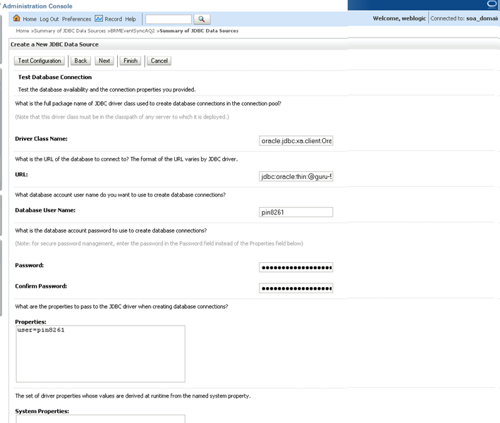

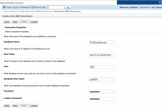

This section provides the instructions for creating the data source and connection factory.
To create the data source and connection factory:
Go to the WebLogic Server - Administration Console and navigate to Services, DataSource, New Generic Data Source.
Enter the data source name as BRMEventSyncAQ2. Enter the JDBC name as jdbc/aia/BRMEventSyncAQ2.
Click, Next, Next, Next to display the Connection Properties page, as shown in Figure F-24.
Figure F-24 WebLogic Server - Administration Console - Connection Properties
Enter all the BRM connection properties and then
Click Next to display the Test Configuration page, as shown in Figure F-25.
Figure F-25 WebLogic Server - Administration Console - Test Configuration
Click Test Configuration to verify that the provided details are correct. If the test is successful, click Finish.
