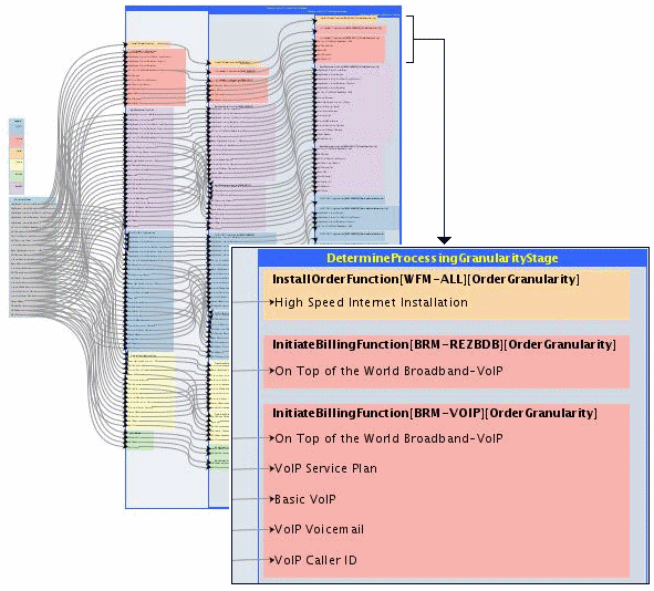

Figure 5-1 shows three orchestration stages, represented in three columns:
Determine the fulfillment function
Determine the fulfillment system
Determine the processing granularity

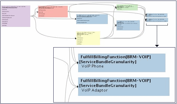

You can model any number of orchestration stages.At each orchestration stage, the graph shows the order components created by that stage. The final column on the right shows the order components that are run as part of the orchestration plan. Each component includes a name, which is based on the orchestration stages. Components also list their included order items.

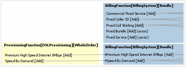

The inset in Figure 5-1 shows details for three executable order components, as displayed in the orchestration plan decomposition.
Figure 5-2 shows the orchestration plan displayed in the Order Management web client dependency graph. The dependency graph shows the executable order components which are the components shown in the final stage of the decomposition display. In this case, executable components are based on three orchestration stages corresponding to fulfillment function, fulfillment system, and processing granularity. The different colors represent fulfillment functions, such as InitiateBilling or FulfillBilling. The inset shows a detailed view of two order components. Even though the two fulfillment functions are targeted to the same system (BRM-VOIP), processing granularity rules defined for this order require that they take place as two separate actions.
Both of these representations are useful at design time and when debugging orchestration plans. For example, you can use the dependency graph to confirm that an order goes to all of the correct systems in the correct order. Use the decomposition tree to verify that decomposition happens as expected at a particular stage and that the order was decomposed into the correct components, each containing the correct order items.

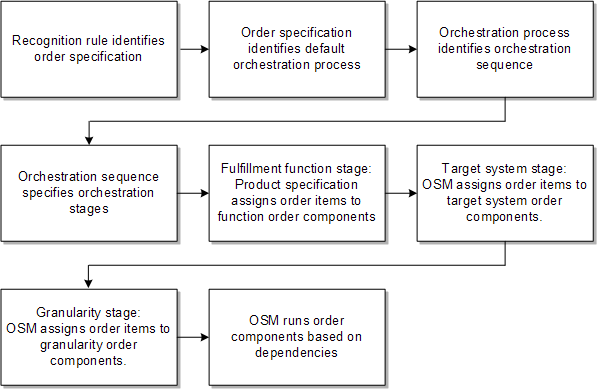

Figure 5-3 shows a generalized process flow for orchestration.
The following process flow shows how OSM uses the orchestration entities to create orchestration plans.
After receiving and validating an incoming customer order, OSM creates the order according to the order specification chosen by the recognition rule. At this point, the following has been accomplished:
The order has been populated with the creation task data.
OSM has used the order item specification to identify order items from the order line items in the incoming customer order.
The order specification includes a default process. For an orchestration order, the order specifies an orchestration process. (If no orchestration is required, you should define a non-orchestration OSM process. See "Modeling Processes and Tasks" for more information.)
The orchestration process specifies an orchestration sequence.
The orchestration sequence specifies the following:
The order item specification to use for the order. The order item specification defines the order item properties that are used for decomposition and for displaying the order item in the Order Management web client. See OSM Concepts for more information.
The order item selector that identifies the customer order line item node-sets to use as order items.
The fulfillment mode that the order requires; for example, Deliver or Cancel.
The orchestration stages that produce the order components. For example, the orchestration stages might be:
Produce function order components. This stage organizes order items into order components based on the fulfillment functions required for each order item. Fulfillment functions are the activities that must be performed to process the item, such as billing, shipping, provisioning, and so on.
Produce target system order components. This stage organizes order items into order components based on the target fulfillment systems required to perform the fulfillment functions. For example, this step might determine that certain items need to be fulfilled by a billing system called BRM_Residential and others by a BRM_Wholesale system.
Produce granularity order components. This stage organizes order items that need to be processed together into order components. For example, you might need to fulfill billing requirements for mobile and fixed services. You can use different order components to process the billing requirements for those services separately.
Figure 5-4 shows how to define orchestration stages in Design Studio.
Each orchestration stage produces a set of order components. Figure 5-5 shows how an orchestration stage specifies order components.
Based on the default orchestration process, and the orchestration sequence and stages that are defined, OSM can start the process of assigning order items to order components. The first step is to find the fulfillment pattern used by each order item.

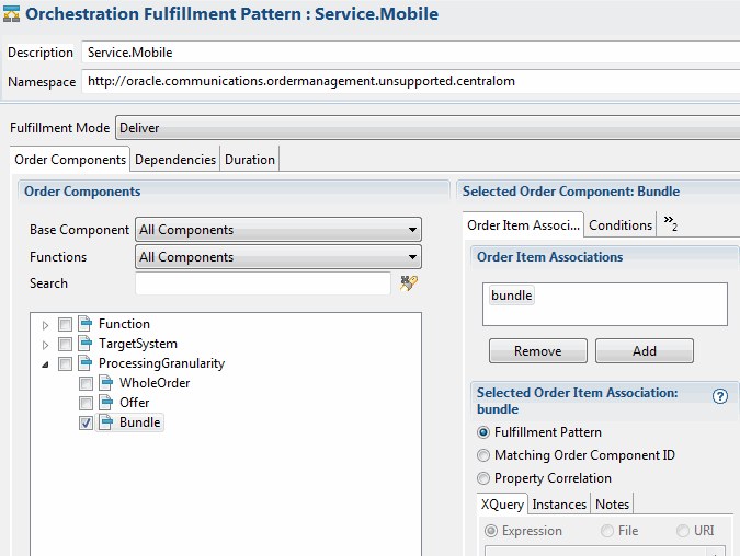

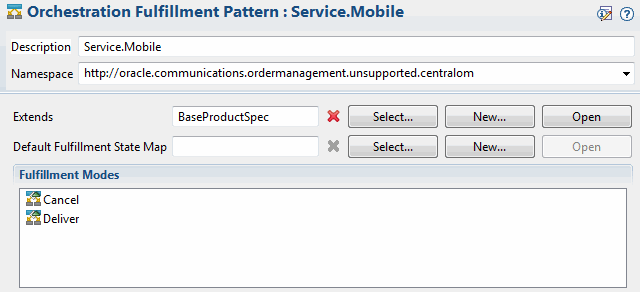

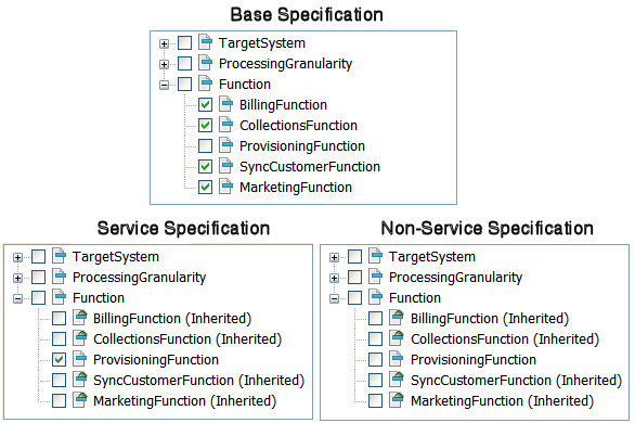

Each order item belongs to a product specification. A product specification is a group of related products that share common attributes. For example, the products Broadband Light, Broadband Medium, and Broadband Ultimate would all belong to the ServiceBroadBand product specification. OSM maps the product specification to a fulfillment pattern.

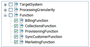

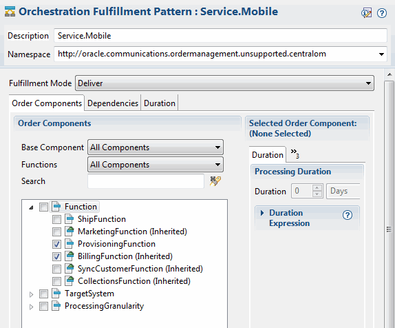

The fulfillment pattern manages the first stage of orchestration. It assigns order items to function order components in the first stage of orchestration. It also specifies the dependencies between the function order components. For example, the fulfillment pattern might specify to process function order components in this order:
ProvisioningFunction
BillingFunction
CollectionsFunction
The fulfillment pattern also specifies the fulfillment mode that the order items can be used for. See "About Mapping Order Items to Fulfillment Patterns" for more information.
Figure 5-6 shows function order components defined in a fulfillment pattern.

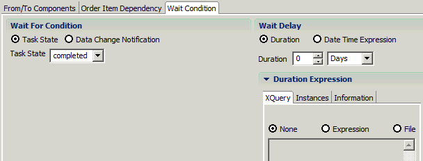

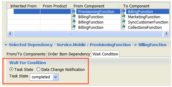

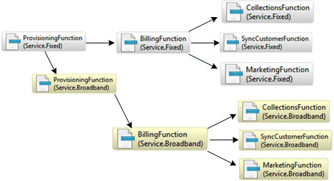

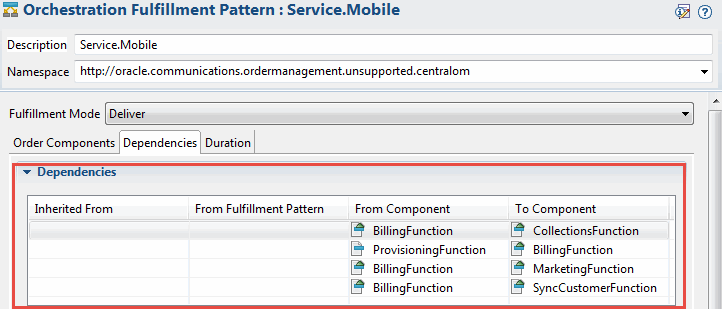

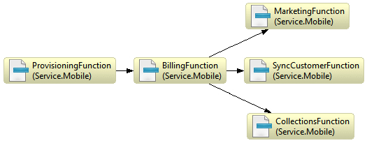

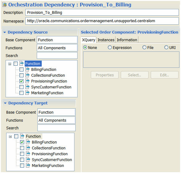

Figure 5-7 shows order component dependencies defined in a fulfillment pattern.
Figure 5-8 shows the order component dependencies shown in Figure 5-7. Provisioning must occur before billing, which must occur before marketing, customer updates (SyncCustomer), and collections.

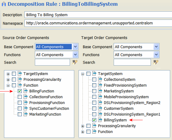

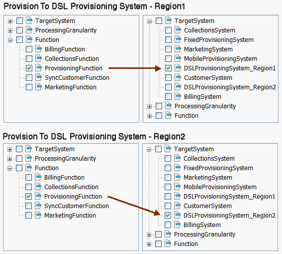

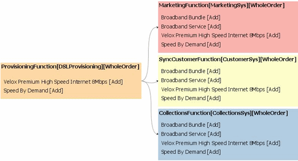

After assigning order items to function components, OSM further decomposes the order into target system order components and granularity order components, following the specifications defined in the orchestration stages. See "About the Decomposition of Function to Target System Components" and "About the Decomposition of Target System to Granularity Components" for more information.
While decomposing the order, OSM finds dependencies between order components and generates an orchestration plan. Dependencies determine the order in which order components can be processed.

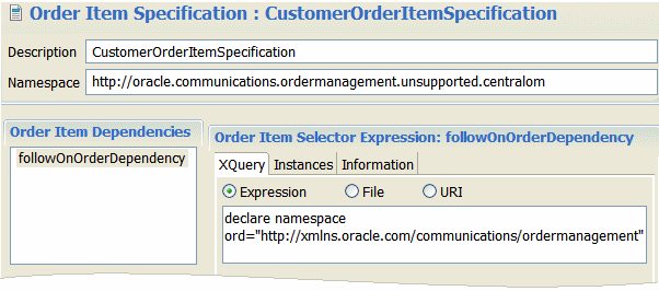

Order item dependencies. Use order item dependencies to create inter-order dependences. See "About Inter-Order Dependencies" for more information.

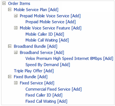

Figure 5-10 shows all of the order items derived from an order, including the order item shown in Example 5-1.
In Figure 5-10, notice that order items are hierarchical. For example, the Fixed Service order item shown in Example 5-1 is part of the Fixed Bundle order item. In addition, the Fixed Service order item includes three more order items: Commercial Fixed Service, Fixed Caller ID, and Fixed Call Waiting. When you model orchestration, you ensure that the hierarchy in the incoming customer order is duplicated in the OSM order items. See "Modeling Order Item Hierarchies" for more information.

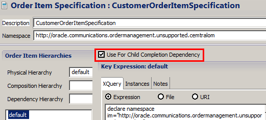

The order item specification defines the order item properties that are required for generating the orchestration plan and the data to display in the Order Management web client. This typically includes the display name, product specification, line ID, requested delivery date, and so on. By contrast, the order item usually would not include supplementary account and customer details such as the street address or mailbox size. That type of data is defined in the task data for each task in the fulfillment data, and in the creation task data when the order is created.

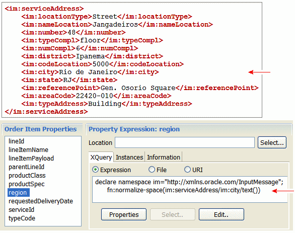

region: This property is an example of data that can be used to manage decomposition into target system order components. See "About the Decomposition of Function to Target System Components" for more information.

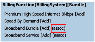

Figure 5-12 shows the associated order items, displayed with (assoc) in the orchestration plan.
Important:
Associated order items are not considered as part of the decomposition and dependency calculations when OSM generates an orchestration plan. Therefore, you cannot reference associated order items in decomposition or dependency rules.You model order item associations in fulfillment patterns. Figure 5-13 shows an order item association modeled for the Bundle order component in the Service.Mobile fulfillment pattern.

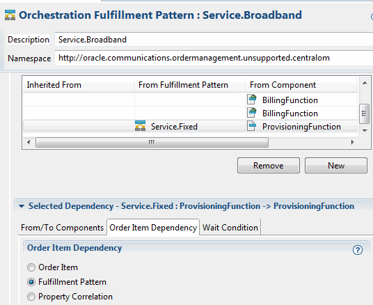

There are three ways to associate order items:
Fulfillment pattern: This is the default entry. It associates order items by fulfillment pattern, which is the normal orchestration method.
Matching Order Component ID: This associates order items by matching component ID.
Property correlation: This associates order items by using order item properties. See "About Associating Order Items Using Property Correlations XQuery Expressions" for more information.

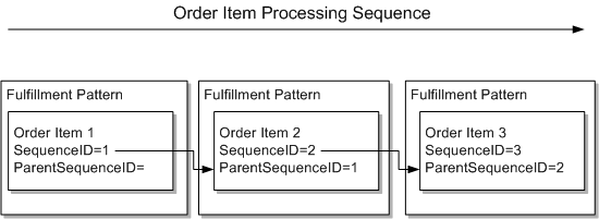

Order items can be organized hierarchically based on the content of the original customer order. You can configure OSM with the following types of order item hierarchies:
Physical Hierarchy: The hierarchy can include various types of order line items, such as offers, products, and bundles of products or services. For example, an order could include a Broadband-VoIP offer with a High Speed Internet bundle, an Internet Services service bundle, and a Wireless Router product item. OSM maintains the order line item hierarchy from the customer order in the order item hierarchy.
Composition Hierarchy: You can use composition hierarchies with fulfillment state composition rule sets to determine the parent/child relationship between order items so that OSM can determine aggregate fulfillment states for parent order items. See OSM Concepts for more information.
Dependency Hierarchy: You can specify a dependency hierarchy that OSM uses to automatically configure dependencies between order items on an order. For more information, see "About Processing Order Items Sequentially".
Figure 5-14 shows a physical order item hierarchy that reflects the structure of the original customer order.
The hierarchy is defined in the <lineID> and <parentLineId> elements. Figure 5-15 shows the first part of Figure 5-14, as it appears in an incoming customer order.
To define the order item properties that specify the hierarchy, you configure the order item hierarchy in the order item specification using an XQuery expression. See "About Order Item Specification Order Item Hierarchy XQuery Expressions" for more information.
An order item hierarchy is invalid when:
The hierarchy refers to an non-existent parent or child line ID.
When the key or parent key XQuery is wrong.
When the hierarchy specifies a circular relationship. For example, the parent of an order item is itself, or if order item A is the parent of order item B and order item B is also the parent of order item A.
OSM does not apply invalid order item hierarchies, but instead runs the order without any hierarchy.

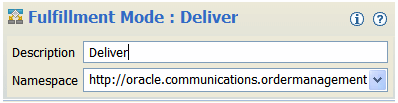

The fulfillment mode is the overall purpose of the order. For example:
Deliver a service.
Qualify a service before delivering it. This ensures that a service can be fulfilled before attempting to fulfill it.
Cancel an entire order.
Every incoming customer order can specify a fulfillment mode.
OSM can use the fulfillment mode as part of the orchestration process. For example, if OSM receives two identical incoming customer orders with different fulfillment mode order item properties, it generates a different orchestration plan for each order. The two plans include different executable order components with different dependencies among order items.
Fulfillment modes are configured in the following places:
Fulfillment mode entities: These entities include no data other than a name. They provide the means to assign fulfillment modes to other entities, such as orchestration sequences and fulfillment patterns. Figure 5-16 shows a fulfillment mode specification.

Fulfillment patterns list the fulfillment modes that the associated order items can be used with.
Figure 5-17 shows the fulfillment modes defined in a fulfillment pattern. Any order item that uses this fulfillment pattern can be processed in either the Cancel or Deliver fulfillment mode.
When a fulfillment pattern includes multiple fulfillment modes, you can model a different set of order components and dependencies for each fulfillment mode.

The first step in decomposition is to assign order items to function components. To do so, OSM uses the product specification to find the fulfillment pattern that the order item uses. (See "About Mapping Order Items to Fulfillment Patterns" for more information.) The fulfillment pattern defines the order components to add the order item to.
Figure 5-18 shows the function order components selected in the Service.Broadband fulfillment pattern. In this case, order items that use this fulfillment pattern need all of the functions; billing, collections, provisioning, and so on.
Figure 5-19 shows how to use a base specification to define the same function order components as described above. In this case, the base fulfillment pattern selects all of the function order components except provisioning. The service and non-service fulfillment patterns inherit the selections. The service fulfillment pattern adds the provisioning function. The non-service fulfillment pattern does not add it.
In addition to using the fulfillment pattern to assign order items to function components, you model an orchestration stage, which specifies to create the function order components to create. Figure 5-20 shows the function order components created at the DetermineFulfillmentFunction orchestration stage.
When OSM creates the order items and order components, it produces a set of control data. The control data provides information OSM requires to fulfill the order. OSM uses the control data to track the status of the entire order and to track the status of the individual order items. During fulfillment, order component transactions update this control data with system interaction responses.
Design Studio automatically generates control data for function order components provided that orchestration entities are preconfigured correctly and you use the OracleComms_OSM_CommonDataDictionary model project. If you do not use the OracleComms_OSM_CommonDataDictionary model project, you must manually model order component control data. See the Design Studio Help for information on how order component control data is automatically generated or how to manually model it.
See "Modeling OSM Data" for more information on adding function order components to the order control data.

After the order items have been assigned to function order components, they need to be further decomposed into target system order components. To do so, you use decomposition rules.
A decomposition rule specifies a source order component and a target order component. Figure 5-21 shows a decomposition rule from the billing function component to the billing target system component.
You can use decomposition rules to decompose order items from one function component to multiple target system components. Figure 5-22 shows the source and target order components for two decomposition rules:
Provision to DSL Provisioning System - Region1
Provision to DSL Provisioning System - Region2
These two decomposition rules decompose the order items in the ProvisioningFunction order component into two target system order components based on Region 1 and Region 2.
Each of the decomposition rules uses decomposition conditions to specify which target system to use for a particular order. The target system is selected if the XQuery expression associated with the condition evaluate to true. In this example, the XQuery expression uses the value of the region order item property to make this evaluation. If the value of region is Toronto, then OSM selects the condition and target system for Region 1. If the value of region is New York, then OSM selects the condition and target system for Region 2. See "About Order Item Specification Condition XQuery Expressions" for more information about creating an XQuery condition expression that can be used for with a decomposition rule.
In addition to creating the decomposition rules that define the source and target components, you need to create an orchestration stage that produces the target system order components. Figure 5-23 shows the target system order components produced by the DetermineTargetSystem orchestration stage.
To summarize, to configure how order items are decomposed from a function order component to a target system order component, you do the following:
Define an orchestration stage to produce the target system order components.
Create dependency rules to specify the source order components and target order components.
If a function order component decomposes order items to more than one target system order component, create decomposition conditions. Decomposition conditions depend on data specific to the order items, so decomposition rules typically use XQuery expressions to retrieve the data that is used for evaluating the condition.
The following sections describe the decomposition of order items from target system components to granularity components.
After order items have been decomposed into target system order components, the next step is to decompose them into the granularity order components.
Some examples of the granularity requirements are:
A billing system might require the entire order in the message to calculate discounts.
A billing system might require separate bundles for mobile billing and fixed billing, to handle different completion times (fixed billing typically has more dependencies and takes longer).
To decompose target system order components items into bundle granularity components you configure the following:
Create a decomposition rule, which decomposes the target system order component into bundle granularity components.
Create customized component IDs that are used to create separate order components for each bundle. (See "About Customized Component IDs to Separate Bundled Components" for information.)
You create the customized order component by editing the bundle order component specification.
You need to configure a decomposition rule and a bundle granularity order component specification to make sure that order items for a fixed service and a broadband service are decomposed into separate bundle granularity components, based on their customized component IDs. The customized component IDs result in separate instances of bundle order components, with separate component keys. This allows OSM to process the order components for the fixed service and the broadband service separately. If you do not create customized component IDs, the order items are processed together in the same order component.
This customization also ensures that the component ID is the same for order items within the same granularity (for example, a bundle) but not for order items at a higher granularity.

The simplest form of dependency is an order item dependency, configured in a fulfillment pattern. This type of dependency is based on function order components; for example, the billing order component cannot start until the provisioning function has completed.
Figure 5-25 shows a dependency relationships. Note the two layers of dependency: billing is dependent on provisioning, and everything else is dependent on billing.
In addition to defining the function order components, you need to define the conditions that govern the dependency. The default condition is to wait until the final task associated with the order item has completed. Figure 5-26 shows a wait condition defined in Design Studio. In this case, the waiting order item must wait until the blocking order item task has reached the Completed state. See "About Order Item Dependency Wait Conditions" for more information.
Dependency wait conditions specify the condition that the blocking order item must be in before the waiting order item can start. For example, the default wait condition is to start the waiting order item when the last task associated with the blocking order item reaches the Completed state.
You specify wait conditions in fulfillment patterns and orchestration dependencies. You can set different wait conditions for each dependency. The wait conditions can be:
The task state of the final task associated with the blocking order item
A change in the data for a specified field. See "About Order Item Dependency Wait Conditions Based on Data Changes" for more information.
A specified duration after the task state or data change condition has been met. You can specify a value in months, weeks, days, hours, or minutes, or you can specify an XQuery expression to determine the delay (see "About Wait Delay Duration XQuery Expressions"). For example, you can specify to start the waiting order item two days after the blocking order item has completed.
A specific date and time based on the result of an XQuery expression (see "About Wait Delay Date and Time XQuery Expressions"). For example, you can specify to start the To Component order component on a date specified in an order item property.
Figure 5-27 shows the wait condition options in a fulfillment pattern in Design Studio. The orchestration dependency wait condition options are identical.

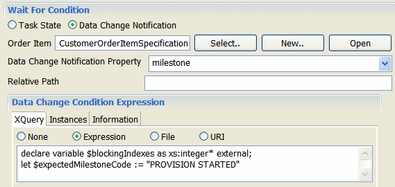

You can base a dependency on a change to data. The data must be included in an order item property, and it must be in the task data of the task associated with the blocking order item.
To configure the dependency, you define the following:
The order item property that is evaluated. Any change to the data in the order item property triggers an evaluation of the data to determine if it matches the conditions required for the dependency.
An XQuery expression that evaluates the data retrieved from the blocking order item. The expression returns true or false; if true, the dependency has been met.
Figure 5-28 shows a data change dependency in Design Studio.
In Figure 5-28:
The Order Item field specifies the order item specification to use.
The order item property that the dependency is based on is milestone.
The Relative Path field (not used in this example) is an optional field you can use to specify a child data element in the order item properties.
The XQuery expression evaluates the data in the milestone property to determine if the dependency has been met (see "About Order Data Change Wait Condition XQuery Expressions"for more information).
You can define dependencies across different order items by basing the dependency on the fulfillment patterns of the order items. For example, you can create a dependency that specifies to provision fixed services only after broadband services have been provisioned.
Figure 5-29 shows a dependency based on fulfillment pattern. In this example, the dependency requires that fixed services be provisioned before broadband services. To configure this type of dependency, you edit the fulfillment pattern of the waiting order item. In the fulfillment pattern, you provide a list of waiting and blocking order components.
Figure 5-30 shows the dependency relationships shown in Figure 5-29. Note that fixed provisioning is the blocker for broadband provisioning and for fixed billing.

You use orchestration dependencies to create dependencies between order components that are not based on fulfillment patterns. For example, if you need to define a generic dependency or want to model one without having to modify a fulfillment pattern, you can use an orchestration dependency specification.
As with dependencies defined in fulfillment patterns, you can specify wait conditions and the type of order item dependency (for example, order item, fulfillment pattern, and property correlation).
You can enable order items to process sequentially at run-time by setting an order item dependency hierarchy in the order item specification editor Order Item Hierarchies tab. When you model order items to run sequentially, avoid creating circular dependencies by ensuring that you do not include order items with a predecessor successor relationship into the same order component.
For example, you can ensure that only one order item processes at a time by configuring the orchestration granularity for a component to process only one order item at a time. Or you could also set the granularity for a component to process only a bundle of order items at a time. For example, between a bundle for VoIP and another bundle for Broadband. If parameters designating the successor predecessor relationship always establish a relationship between order items across two different bundles, then you avoid circular dependencies in this way as well.
Figure 5-34 shows how order items can be configured to process sequentially based on two order item properties defined in an order item specification order item hierarchy. You can use any order item property, so long as you can use the properties to establish the predecessor and successor relationship.
See "Modeling Order Item Hierarchies" for more information about modeling order item hierarchies.

To configure an inter-order dependency, you use the Order Item Dependencies tab, as shown in Figure 5-35. The configuration typically consists of the name of the dependency and its XQuery or data instance (see "About Order Item Inter-Order Dependency XQuery Expressions" for more information about inter order item XQuery expressions).
You can create inter-order dependencies that involve order item hierarchies. For example, you can specify that the blocking order item include all of the order items in its hierarchy. To do so, you select the child completion dependency when specifying an order item hierarchy (see Figure 5-36). For more information about order item hierarchies, see "Modeling Order Item Hierarchies").
Figure 5-37 shows an orchestration dependency in Design Studio.
