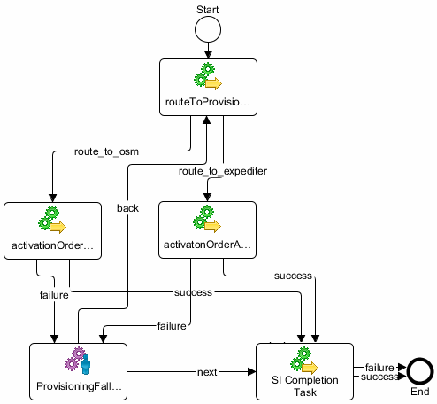

Process flows define the sequence of tasks that the process performs. You can design flows for specific scenarios, including:
A flow that ends in a successful process completion (Success) or a process failure (Failure).
Flows for various activities, such as Cancel, Next, and Back.
Figure 7-1 shows how flows appear in a process in Design Studio. In this figure, flows are labeled with the task status; for example, route_to_osm.

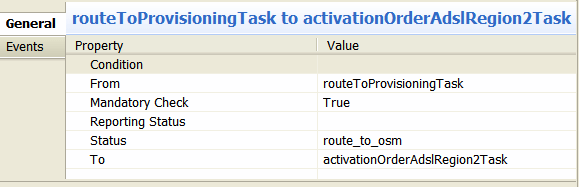

You can control flows in the following ways:
You can use an order rule to apply conditions that must be met before the flow can continue.
You can ensure that the system verifies that mandatory fields are present when a task completes. (This option is not available for tasks with a Rollback status.)
You can specify a reporting status to display in an OSM web client. This status is tracked in the web client's OSM history.
Figure 7-2 shows flow properties in Design Studio.

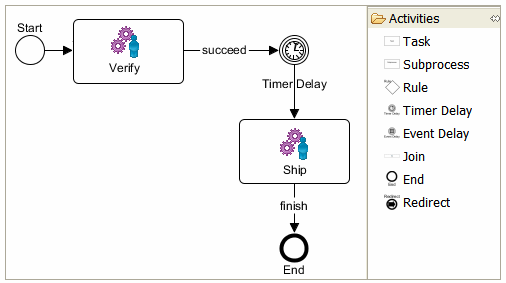

You use process activities to design how the process runs. Figure 7-3 shows the Activities options in Design Studio. The example process includes a timer delay between the two tasks.
Figure 7-3 Process Activities Options in Design Studio
In addition to the tasks and subprocesses that the process runs, you can control the process by using the following:
Rules
Timer delays
Event delays
Joins
Ends
Redirects

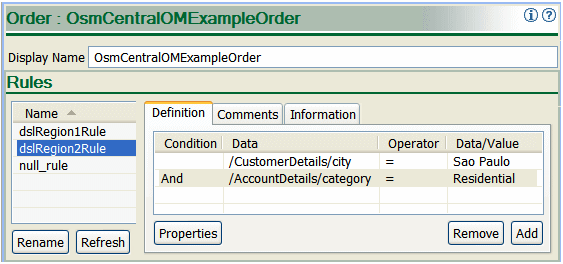

OSM evaluates order rules by comparing data to data, or data to a fixed value. Figure 7-4 shows an order rule in the Design Studio Order editor Rules tab. This rule identifies residential customers in a specific city. This is an example of a rule that might be used to send a fallout notification to a regional fallout manager.
All jeopardy notifications and most event notifications use order rules to determine if the notification should be triggered. (Event notifications that are used only for running an automation plug-in do not use order rules.)
Figure 7-5 shows an example of a rule defined in Design Studio. This rule finds the city that the customer lives in and the type of account, (Business or Residential). When the jeopardy notification uses this rule, the notification is sent only if the order came from a residential customer in Sao Paulo.
You can use rules such as the one shown in Figure 7-5 to route notifications to specific roles. For example, you can combine rules and roles as follows:

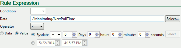

You can create a rule that uses the system date as part of a condition. For example, you can create a rule used in a delay that delays a task transition until the system date is at least the value of a particular order data element of the dateTime data type. Figure 7-6 shows a rule that triggers when the system date is at least the value of the date when a particular poll is run.
See "Adding Process Activities" for more information about delays in process flows.

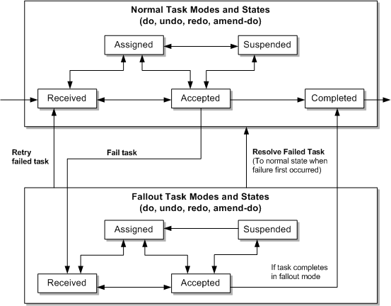

Figure 7-8 shows how OSM transitions tasks to the fallout execution modes and back to normal execution modes and how these modes relate to task states.
The following shows how the tasks in Figure 7-8 processes through each state in a Normal execution mode:
When OSM starts a task, it enters into the Received state in a normal execution mode.
In Manual tasks, an operator can optionally assign the task to themselves or have the task be assigned to them. When the task is assigned, it enters into the Assigned state. Automation tasks do not use this state.
When an operator or the system begins working on the manual or automated task, the task enters into the Accepted state.
While the task is in the Accepted state, the system or the operator can:
Move the task to a customer defined state like the Suspended state for a business reason defined for the task. From the Suspended state, the system or the operator can return the task to the Accepted state or move it to the Assigned state.
Move the task to the Completed state by completing the task.
Fail the task. A failed task automatically moves to the Received state in a fallout execution mode. You can fail a task in the following ways:

The following shows how the tasks in Figure 7-8 processes through each state in a fallout execution mode:
A task enters a failed execution mode in the Received state from a normal execution mode in the Accepted state.
In Manual tasks, an operator must assign the task to themselves or have the task be assigned to them. When the task is assigned, it enters into the Assigned state. Automation tasks do not use this state.
While the failed task is in the Accepted state, the system or the operator can:
Move the task to the normal execution mode Completed state to complete the task.
Retry the failed task. Retrying a task moves the task back to the normal execution mode to the Received state to retry the task from the beginning. You can retry a failed task in the following ways:
Task web client for one task or for all tasks on the order
Order Management web client for all failed tasks on a specific order component within an order, for all failed tasks on each order, or for all failed tasks of many orders as a job control order. You cannot retry a specific task type in bulk across multiple orders using a job control order.
OSM Java API in automation plug-in code
OSM XML API in automation plug-in code
OSM Web Service API operation for all failed tasks on a specific order component within an order, for all failed tasks on each order, or for all failed tasks of many orders as a job control order. You cannot retry a specific task type in bulk across multiple orders using a job control order.
Resolve the task. Resolving a task moves the task back to the original normal execution mode and state it had been in before failing. You can resolve a failed task in the following ways:

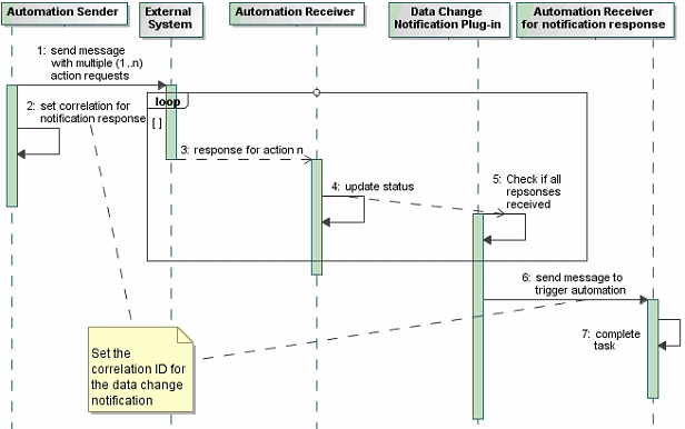

An automated task can process multiple responses from external systems. For example, an activation task might receive the status for each service on the activation request. The activation task needs this information to determine when the activation has been completed by the external system, at which point the task can transition to the Completed state.
The external system can include data that indicates that all of the requests have been completed. Typically, this is a message indicating that the response is the last response, and there will be no further messages.
If the external system cannot report that the last request has been processed, the automation task must ensure that a response has been received for each request sent to the external system.
When OSM must determine the last response, there are special considerations for concurrent status updates. If the automated task needs to track the status of all responses, and multiple responses are processed concurrently, the automation receiver instances executing concurrently do not have visibility to status updates from the other receivers. The receiver may never execute with the task data that contains all status updates and so never encounters a condition where it can complete the task.
This situation can be handled by configuring an automated notification plug-in that monitors the status fields and creates a notification whenever the data changes.
The notification plug-in is triggered every time the status field is updated by the automation receiver. The notification plug-in executes in a separate transaction after each receiver update, and can check the status responses to determine if all responses have been received for each action request. When all responses are received, the notification plug-in can generate a message to trigger an automation receiver. This receiver is correlated to the original sender by means of an ID set by the sender specifically for tracking the status updates. The receiver is then run with the task data that contains all of the status responses and it can complete the task.

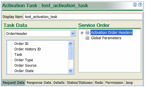

Before you can model Activation tasks in Design Studio, you must install the Design Studio for Order and Service Management Integration feature. This feature includes the Design Studio for Activation feature for integrating with ASAP and IP Service Activator. To model activation tasks, you must also install the Design Studio for Activation feature.
OSM transforms order data into an operations support system through Java (OSS/J) message or a web service message and sends it to ASAP or to IP Service Activator. To model this, you configure service action request mapping, to map OSM data to ASAP data or to map OSM data to IP Service Activator data. See "About Service Action Request Mapping" for more information.
ASAP or IP Service Activator receives the data, activates the service, and returns a success or failure status to OSM. To allow OSM to handle the returned data, you model service action response mapping. See "About Service Action Response Mapping" for more information.

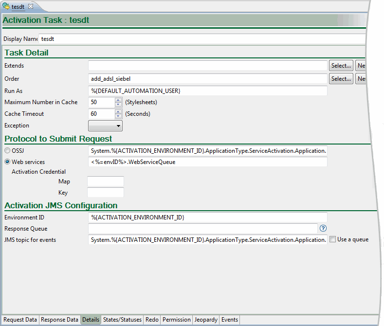

Other elements specific to activation tasks are:
You can configure state and status transitions for completion events and exceptions returned by ASAP or IP Service Activator.
You can configure how to handle amendment processing with activation tasks.
If you are sending JMS OSS/J messages, Oracle recommends that you configure JMS store and forward (SAF) queues to manage the connection to ASAP or to manage the connection to IP Service Activator.
If you are sending web service messages, Oracle recommends that you configure web service SAF queues to manage the connection to ASAP or to manage the connection to IP Service Activator.
Figure 7-10 shows activation task details.
You send fulfillment data to ASAP or to IP Service Activator as a service action request. To model a service action request, you map OSM header data (information that applies to the customer or to all order line items on the order) and OSM task data to the following service order activation data:
Activation order header: Information that applies to the entire work order.
Service action: Information that is required to activate a service.
Global parameters: Information that you define once and which applies to multiple service actions.
Figure 7-11 shows service action request modeling in Design Studio.

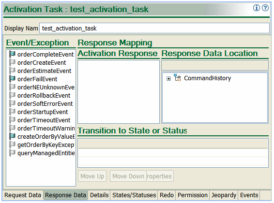

After ASAP or IP Service Activator activates a service, it returns information to OSM. You create data structures in OSM to contain the response information returned from ASAP or IP Service Activator. For each event and exception returned by ASAP or IP Service Activator, you select the ASAP or IP Service Activator data that you want to retain, and then identify the OSM data structure to which that data is added. When ASAP or IP Service Activator returns an event or exception, OSM updates the order data with the ASAP or IP Service Activator data that you specified.
Tip:
The amount of response data from ASAP or IP Service Activator can be very large, though the data that is needed might be small. Parsing large amounts of ASAP or IP Service Activator response data can affect OSM performance. If you notice a reduction in OSM performance due to large amounts of ASAP or IP Service Activator response data, you can specify a condition on specific parameters to limit the ASAP or IP Service Activator response data.Figure 7-12 shows service action response modeling in Design Studio.
You can configure how to manage an activation task if the associated order undergoes amendment processing. The options are:
Intervene manually.
Do not perform any revision/amendment.
Have OSM redo the activation task, using the previously defined request mapping.
Have OSM redo the task, using different request mapping.
You can configure state and status transitions to manage completion events (for example, activation complete) and errors returned by ASAP or returned by IP Service Activator. You can define multiple transitions to model different scenarios for variations in the data received from ASAP or received from IP Service Activator. For example, if an ASAP parameter or IP Service Activator parameter returns the value DSL, you may want the task to transition to a DSL task; when the same parameter returns the value VOIP, you want the task to transition to a different task.
You can define state transitions for user-defined states only; you cannot define transitions for system states, such as Received, Accepted, and Completed. At run time, OSM evaluates the conditions in the order and stops evaluating when a condition evaluates to true. Completion events and errors must include a default transition in case all specified conditions fail.

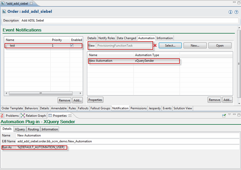

Figure 7-14 shows an event notification with an automation plug-in that uses the ProvisioningFunctionTask query task that is defined as the default query task for the provisioning role. This role must be associated with the Run as OSM user that runs the automation plug-in as shown in the Properties Details tab. For more information about associating roles to OSM users, see the OSM Order Management Web Client User's Guide.
Automation plug-ins defined as external event receivers are designed to process JMS messages from external systems. JMS messages are asynchronous, therefore external event receivers provide a method of correlating responses to requests previously delivered to enable you to map OSM orders to external system orders.
To correlate responses, the plug-in sets a property on the outbound JMS message, with name of the value set for correlation property in the automationmap.xml file, and a value decided by your business logic. For example, business logic might dictate that you correlate on a reference number. The external system copies the properties that you defined for the correlation on the request and includes that data in the response.
You can use the Message Property Selector field to filter messages placed on the queue and determine which automation to run. You define the Message Property Selector value as a boolean expression that is a String with a syntax similar to the where clause of an SQL select statement. For example, the syntax may be:
"salary>64000 and dept in ('eng','qa')"
When the condition evaluates to true, the message is picked up and processed by the automation that defined that condition.
