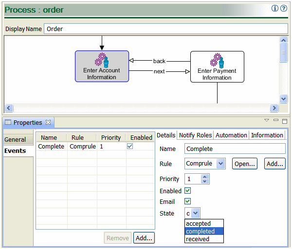

Event notifications are triggered by events. You do not specify polling intervals for event notifications. You can configure them to occur in the following cases:

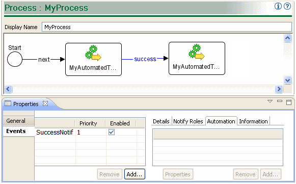

When a task transitions through a task status. For example, you might trigger an event notification when a task transitions to the Failed status.
Event notifications triggered by transitions can be sent to a workgroup. See "About Using Task Transitions to Trigger Event Notifications" for more information.
When a task reaches a specified state. You can use two methods:
You can use the task state to trigger an automated event notification. In this case, only the task state is evaluated (no rules are applied to evaluate a condition), and the notification runs an automation plug-in that handles the notification actions. For example, when a task reaches the Assigned state, you can automate an external lookup before allowing the workflow to continue. You do not specify roles or email delivery for the notification. See "About Using Task States to Trigger Automated Event Notifications" for more information.
You can use the task state in combination with rules to trigger the event notification. In this case, you can specify a rule to evaluate conditions, the priority, if the notification can be delivered by using email, and the workgroups that receive the notification. See "About Using Task States and Rules to Trigger Event Notifications" for more information.
When you use the task state to trigger an automated event notification, the notification is run from all processes that include the task. When you configure a notification based on a task state change in a process, the notification is applicable only to the task within the process in which it is defined.

An event notification based on a task transition does not apply to all instances of the task. It applies to a task only as it is used in a specific process. Therefore, to configure an event notification based on a task transition, you edit the process that includes the transition and apply the event notification to the transition. Figure 13-1 shows the configuration for a success transition in Design Studio. In this figure, the success transition is selected, and the event notification properties are defined below the process window.
The event notification for a status change works as follows:
When the task status changes to the status that you define for the notification, the notification runs a rule to evaluate if the conditions are true.
If the conditions are true, the event notification is triggered.
When you use a task transition to trigger an event notification, you can specify an automation plug-in that the notification runs; however, an automation plug-in is not required.

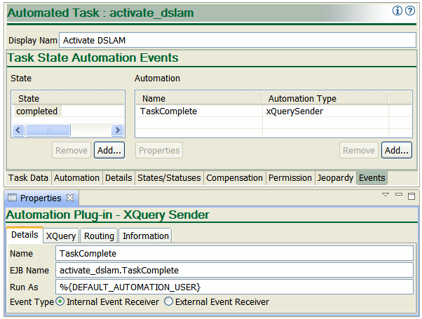

You can use a task state to trigger an automated event notification. In this case, only the task state is evaluated (no rules are applied to evaluate a condition), and the notification triggers an automation plug-in which handles the notification actions. This type of notification runs for every instance of the task, independent of the process that it is in. Event notifications triggered by task states are not displayed in the Task web client.
For example, you can define an automated notification that sends a notification when the task reaches the Assigned state. The event notification works as follows:
When the task reaches the Assigned state, a notification is created.
When the notification is created, the automation plug-ins run.
Figure 13-3 shows an event notification configured in Design Studio. Any time this task runs, the event notification is triggered when the task reaches the Completed state.

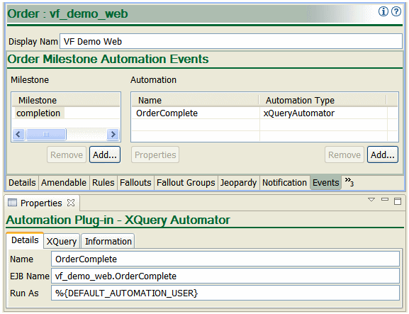

You can use an order milestone to trigger an event notifications. Figure 13-4 shows an event notification based on an order milestone.
Only the order milestone is evaluated (no rules are applied to evaluate a condition), and the notification triggers an automation plug-in that handles the notification actions. Each event notification maps to one or more automation plug-ins. For more information about automation plugins, see "About Automation Plug-ins".
For example, you can define an event notification that specifies the Completion milestone. The event notification works as follows:
After all tasks within a process successfully complete for an order, the order Completion milestone is reached and a notification is created.
You cannot define custom order milestones. Order milestones are based on order states; for example, the Completion milestone occurs when the order transitions to the Completed state.When you create event notification that is triggered by an order milestone, you specify the order milestone that triggers the notification. You can use the following order milestones:
