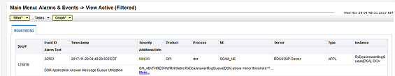

- To get further information regarding this issue:
- Examine the alarm
log from
Main
Menu > Alarms & Events on the active Overseer server.

- Examine the alarm
log from
Main
