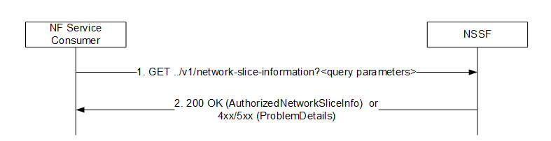

Network Slice Selection Service
The Network Slice Selection service is identified by the service operation name, Nnssf_NSSelection.This service supports GET request during the following procedures by UE:
  • Initial Register: When the NSSF is able to find authorized network slice information for the requested network slice selection information, the response body includes a payload body containing at least the Allowed NSSAI, target AMF Set or the list of candidate AMF(s).
  • PDU Session Establishment:When NSSF receives PDU-Session establishment request from NF consumer, NSSF determines network slice which can serve the requested SNSSAI, based on operator configured policies, and responds with URL of NRF which manages to the Slice and/or Slice ID of the matching Network Slice computed.
  • UE-Config-Update:When the UDM updates the Subscribed S-NSSAI(s) to the serving AMF, based on configuration in this AMF, the NSSF determines the mapping of the configured NSSAI for the serving PLMN and ALLOWED NSSAI to the Subscribed S-NSSAI(s).

When the UDM updates the Subscribed S-NSSAI(s) to the serving AMF, based on configuration in this AMF, the NSSF determines the mapping of the configured NSSAI for the serving PLMN and ALLOWED NSSAI to the Subscribed S-NSSAI(s). Following diagram illustrates the procedure of UE-Config-Update:
Figure 3-3 UE-Config-Update
The following is performed for UE-Config-Update:
  • The AMF sends a UE-Config-Update (GET) request to NSSF. NSSF checks and validates the Subscribed S-NSSAI(s), Requested S-NSSAI(s), PLMN ID of the SUPI, TAI, NF type, and NF instance ID. If message is valid, NSSF searches for allowed S-NSSAI list based on policy configuration and input parameters.
  • NSSF responds with 200 OK with AuthorizedNetworkSliceInfo in case NSSF finds a match.
  • NSSF responds with 200 OK with empty AuthorizedNetworkSliceInfo in case there is no match found .
  • NSSF responds with error code in case of incorrect parameter validation.
