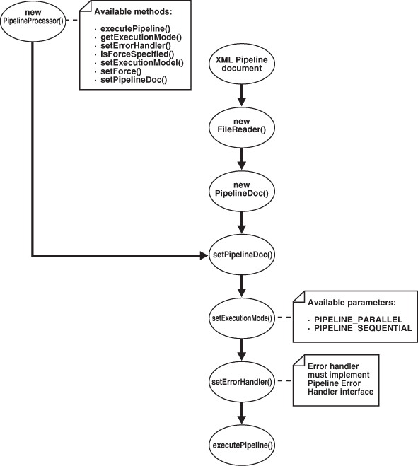

Figure 11-2 shows how to pass a pipeline document to a Java application that uses the XML Pipeline processor, configure the processor, and execute the pipeline.
Figure 11-2 Using the Pipeline Processor for Java
The basic steps are:
