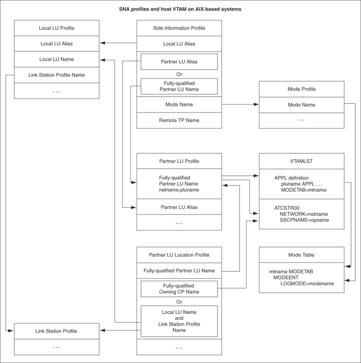

Side Information Profile
The side information profile is a required profile, which is used to identify target OLTP systems to be accessed through Oracle Database Gateway for APPC.
The side information profile identifies the following:
  • the local LU alias
  • the partner LU alias or fully-qualified name
  • the remote transaction program name (optional)
  • the mode name
Set the profile information as follows for each side information profile field:
  • Set the Local LU or Control Point alias to the alias assigned to the local LU in the Local LU Profile.
  • Set the Mode name to the actual mode name as specified in the Mode Profile.
  • Set the Remote transaction program name (RTPN) using the actual remote TP name or a dummy name to be overridden at execution time.
  • Set the "RTPN in hexadecimal?" field to yes, if the remote TP name is hexadecimal.
  • If there is a field for "Partner LU alias", then add the alias assigned to the partner LU in the Partner LU Profile.
  • If there is a field for "Fully qualified partner LU name", then add the fully qualified partner LU name of the partner LU.
Figure 7-1 shows the relationship between SNA server profiles and the VTAM definitions on the host.
Figure 7-1 Relationship Between SNA Profiles and Host VTAM Definitions
Description of Figure 7-1 follows
Description of ''Figure 7-1 Relationship Between SNA Profiles and Host VTAM Definitions''
