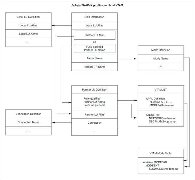

Figure 8-1 shows the relationship between SNAP-IX definitions and the VTAM definitions on the remote host.
Figure 8-1 Relationship Between SNAP-IX Definitions and Host VTAM Definitions
Description of Figure 8-1 follows
Description of ''Figure 8-1 Relationship Between SNAP-IX Definitions and Host VTAM Definitions''
