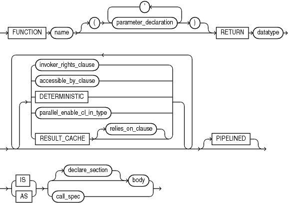

You must define a corresponding method name and optional parameter list in the type specification for each procedure or function declaration. For functions, you also must specify a return type.
proc_decl_in_type, func_decl_in_type
A procedure or function subprogram declaration.
parallel_enable_cl_in_type
Indicates that the function can run from a parallel execution server of a parallel query operation. The function must not use session state, such as package variables, because those variables are not necessarily shared among the parallel execution servers. The parallel_enable_cl_in_type can appear only once in the function.

func_decl_in_type
A function subprogram declaration. See "CREATE PROCEDURE Statement" and "CREATE FUNCTION Statement" for the full syntax with all possible clauses.
